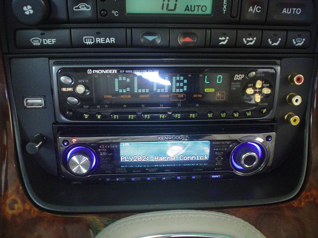

Just to add my two cents, here's what I did. I have the Kenwood head unit and a Pioneer DSP, both fitting within the stock opening, which is not quite 2-Din. They fit very snug, to the point that I had to do it without the dressing frames. The DSP is an awesome unit with many special features.
Of course, this system is different in that absolutely everything stock came off and replaced. There are some more trunk components here in my gallery.
And this here below, is how I did my previous Jag, a 1998 XJ8L. Similar install.

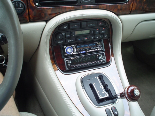

Attached Thumbnails XJ8 Aftermarket Stereo Installation-xj8l-head-unit-combo.jpg

Interesting...
Did the bottom unit fit into the original single din hole? I'm assuming the DSP was very shallow, I have a control unit for my Alpine processor that's similar.
I would still prefer to fit a double din screen in there, and (try to) make it look reasonably original, but I'm guessing you're not complaining, given how much better it must sound than the factory unit, and how easily you can connect usb/mp3 players etc

Originally Posted by grandell_nz
Interesting...
Yes, the DSP is only 2" deep, so there's room enough for both units. I really wanted the 2-Din unit, myself, but it needs some structural modification, including doing something with a heavy piece of framing that cuts across above the radio and is in the way; truly don't know what happens if you cut that off. Once the room issue is resolved, making it look reasonably originalf is a piece of cake.
More than the radio itself, it is the DSP, the amps and the speakers what contribute the most to the sound improvement.
