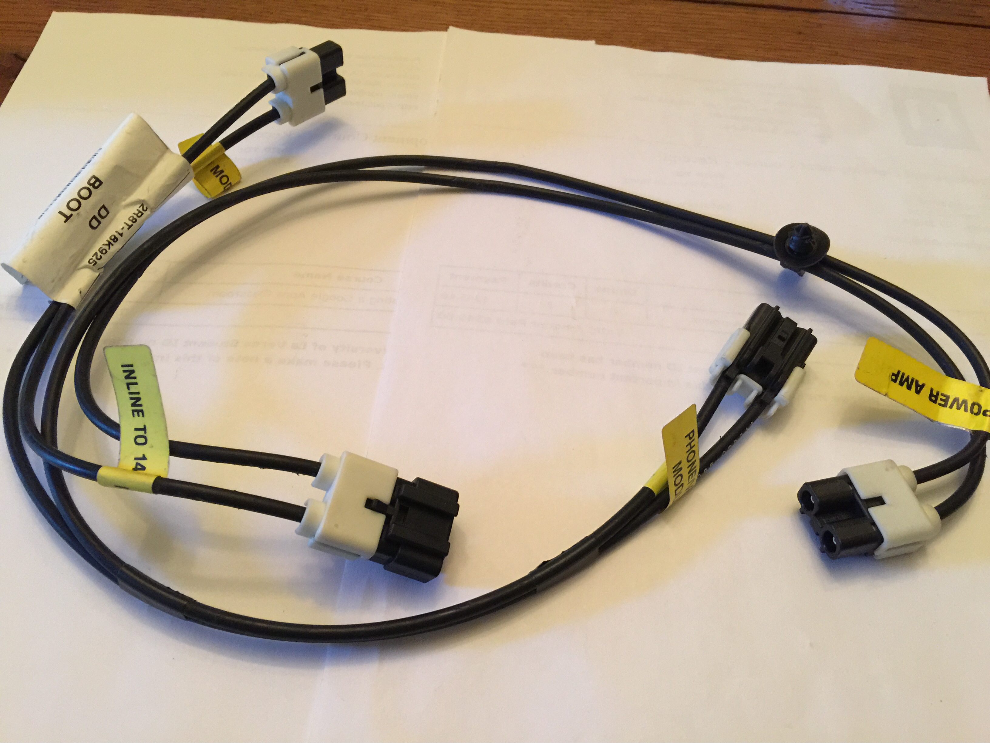

Today installed VACM in the 04 XJR. Just wanted to report that I created a 'Y' optical cable instead of cutting apart the cars optical loop.
For those out there that may want to add veffrmov's kit or telephone or whatever, you can create an optical 'y' cable to extend your optical ring.
See pics of existing cable with female and two male connectors.
See added VACM on 'Y' cable.
Thanks
Mag

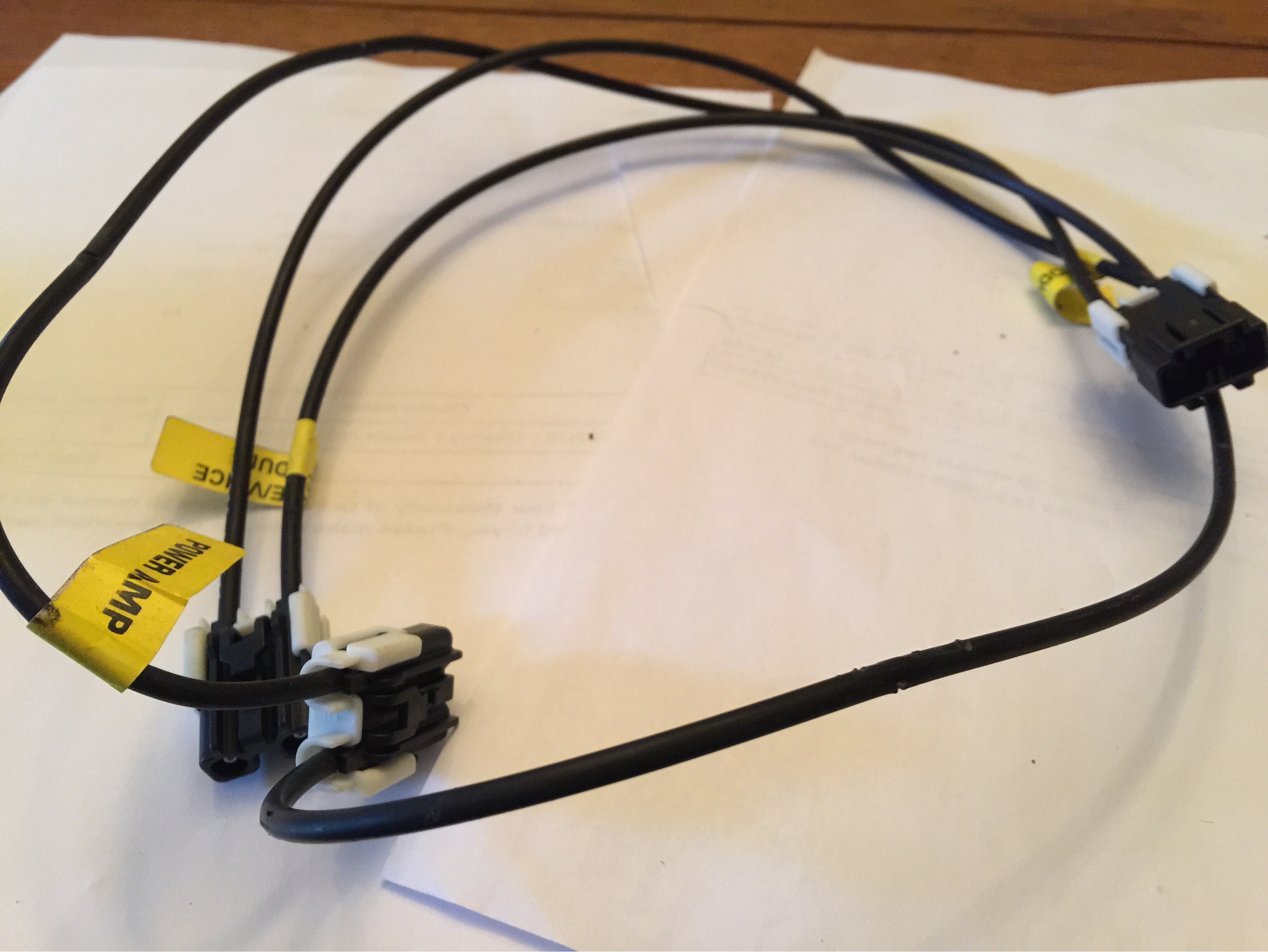

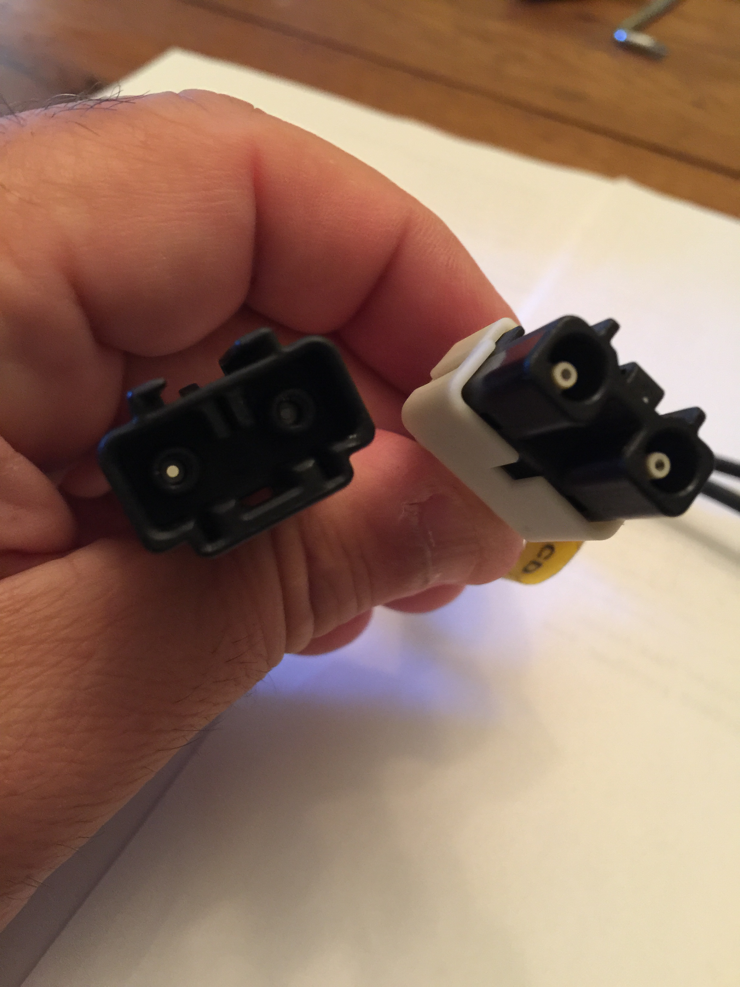

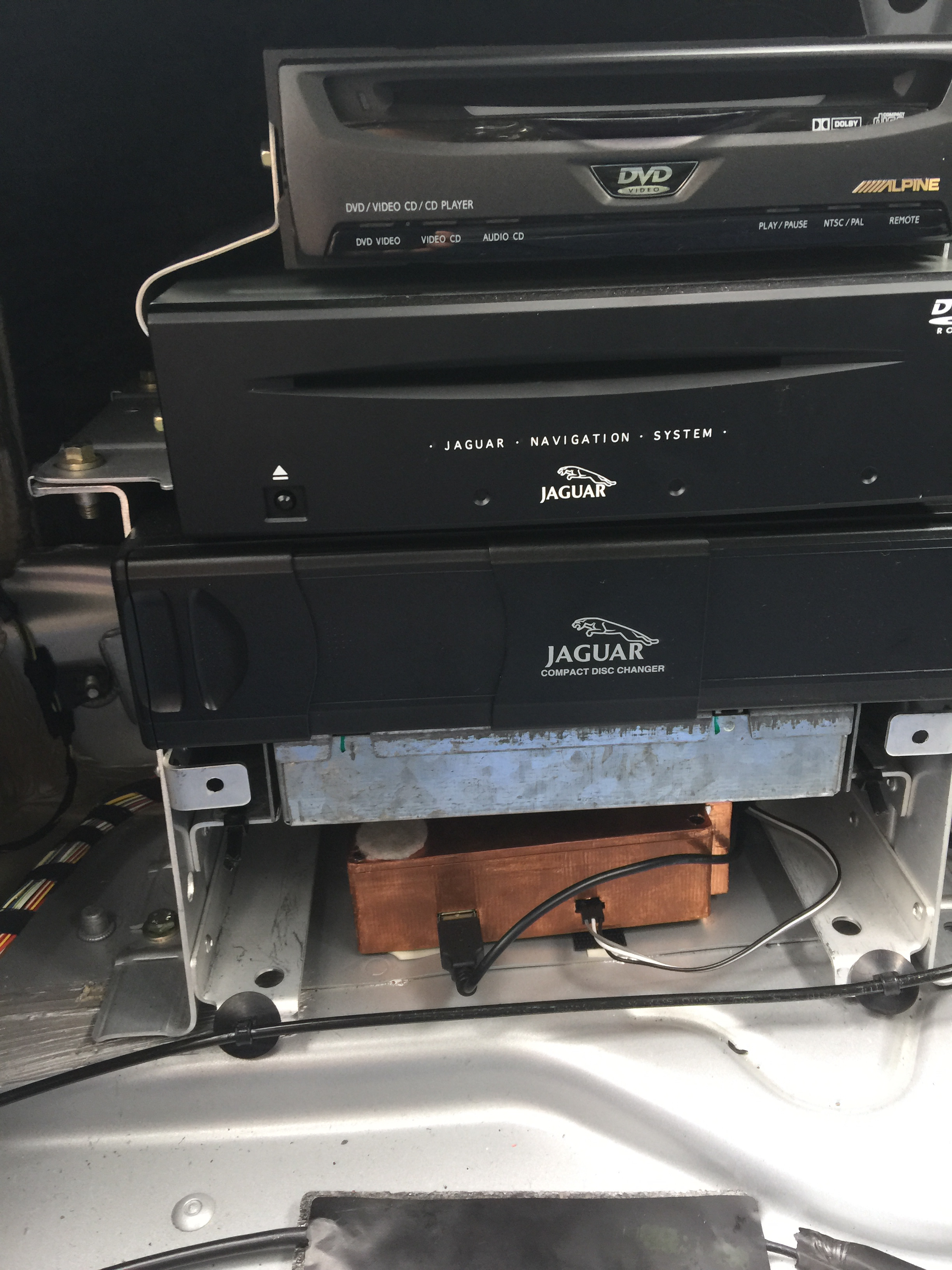

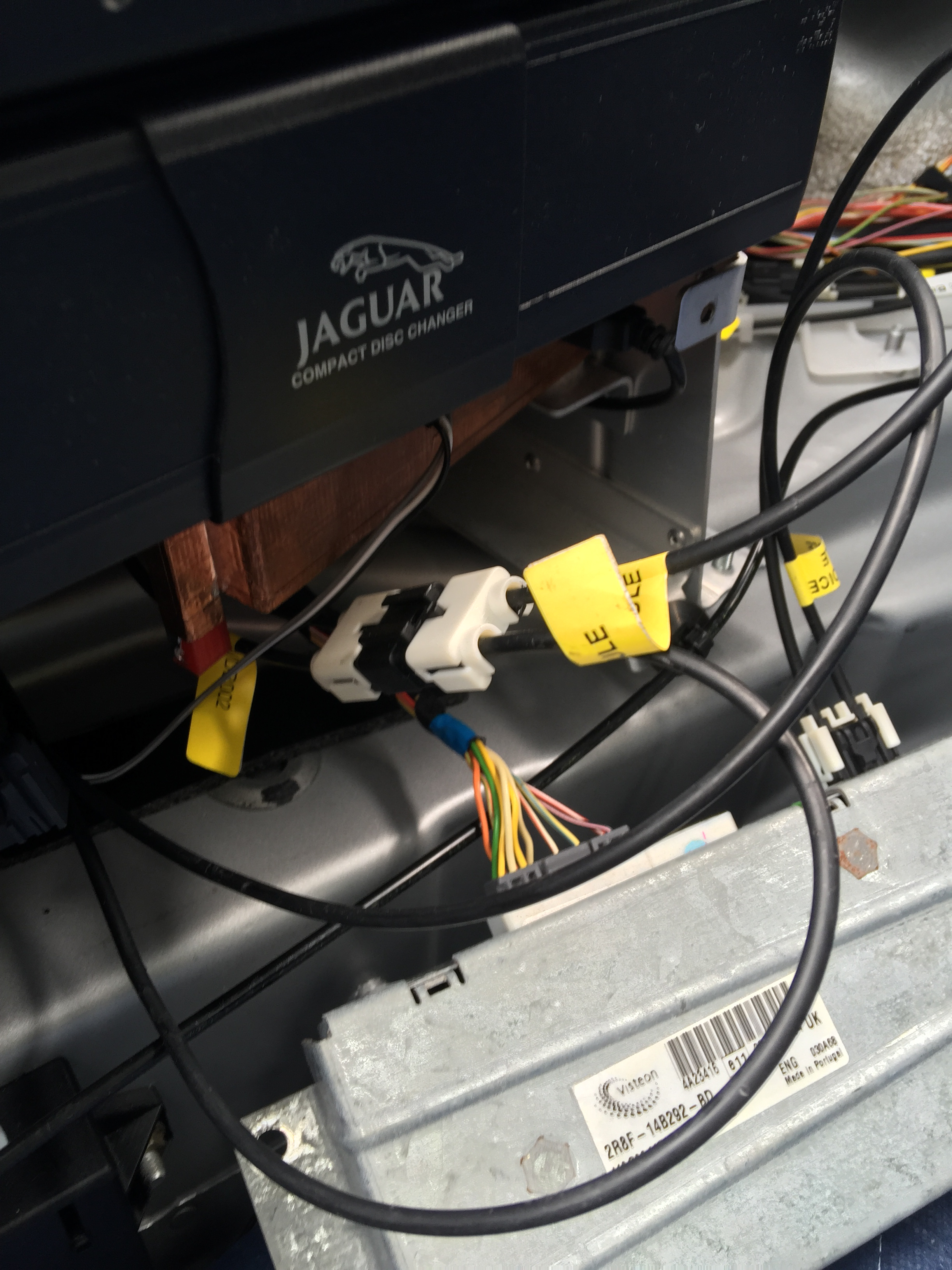

Please see pics.

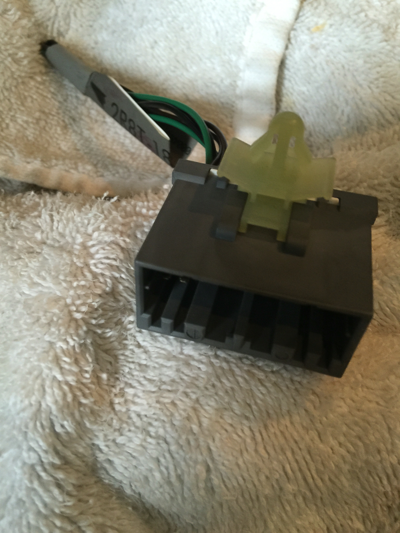

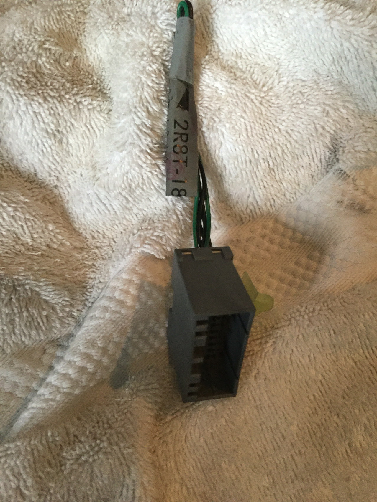

Rob, if you remove the VACM and decide to install a phone module you would need a bypass plug on the VACM connector so the microphone signal can reach the phone module.
Old Oct 5, 2015 | 06:20 AM
magmedia's Avatar
Joined: Mar 2009
Posts: 901
Likes: 258
From: Eastern, MD
Bypass connector photo
Attached Thumbnails 'Y' Cable and VACM-photo227.jpg   'Y' Cable and VACM-photo898.jpg
