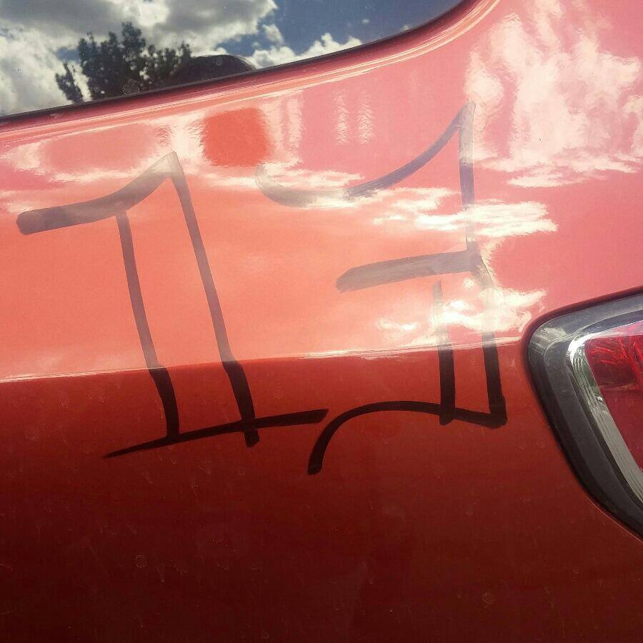

Someone wrote on my daughter's car in permanent marker - will rubbing compound work to remove?? Signed - One pissed off dad!
Attached Thumbnails any ideas on removing permanent marker? - Resolved-13754162_1247038138649478_605755233607003516_n.jpg

got a text this am from my daughter - she was able to remove with a bit of elbow grease and windex and other cleaners.

For future - should anyone else experience - I have heard baby wipes work for removing marker ink. Hope I never have to find out - but thought I'd share.

AXE body spray works as fine with a microfiber towel. BTW make sure your daughter waxes that area as Windex has ammonia and will ruin your paint if she does not put a coat or two of wax at the area.
