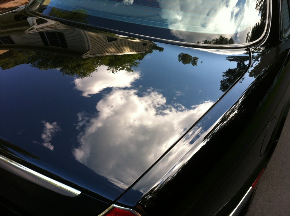

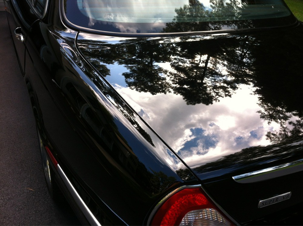

I had been noticing what looked like small 'dots' in the paint. When feeling the paint with the hand, it felt smooth to the touch. In the past, on this and other vehicles, I had been able to feel the contaminants on the paint.
Did a Zaino clay bar followed by their Z5 and Z3 polishes. The spots went away, so my lesson learned-clay bar once a year to keep that black paint reflective.
(iphone pics)
thanks-
mag
