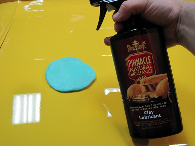

16 oz. Pinnacle Clay Lubricant
Pinnacle Clay Lubricant creates a slick barrier between the paint and the clay cleaning material. The high lubricity formula prevents loosened contamination from scratching delicate clear coat finishes yet it will not break down or degrade the integrity of the clay.

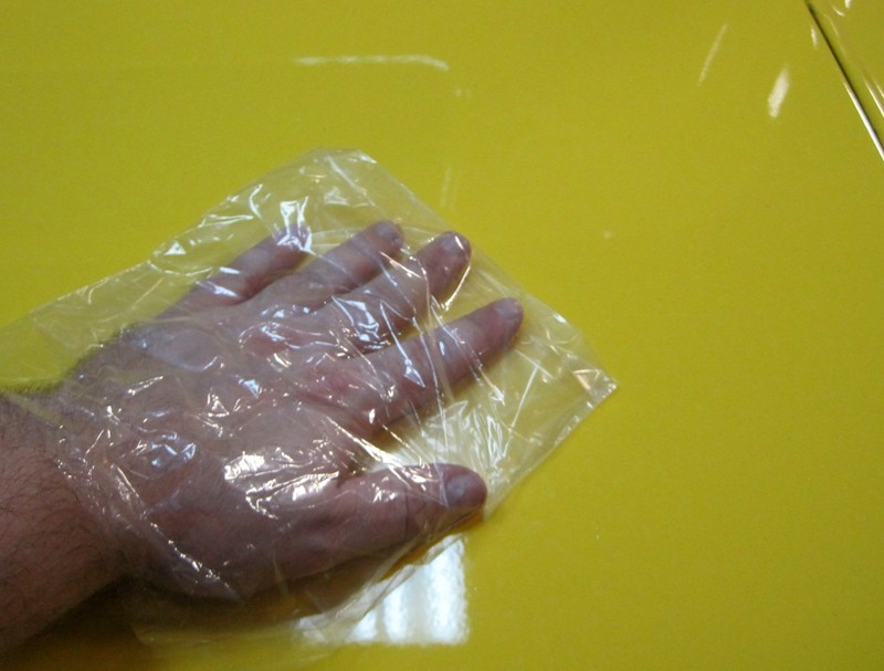

Step 2: Do the Bag Test
Put a plastic sandwich bag over your hand and lightly rub your fingertips over the paint. If it feels gritty or rough, your paint is contaminated.

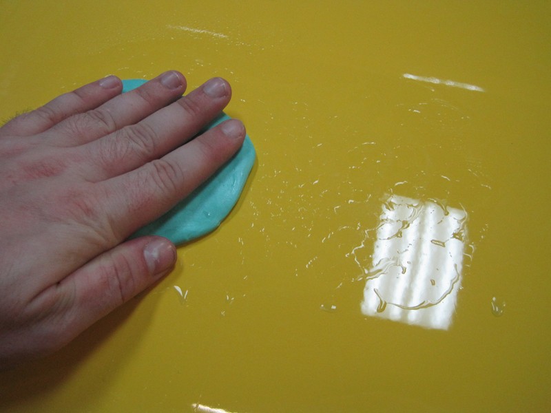

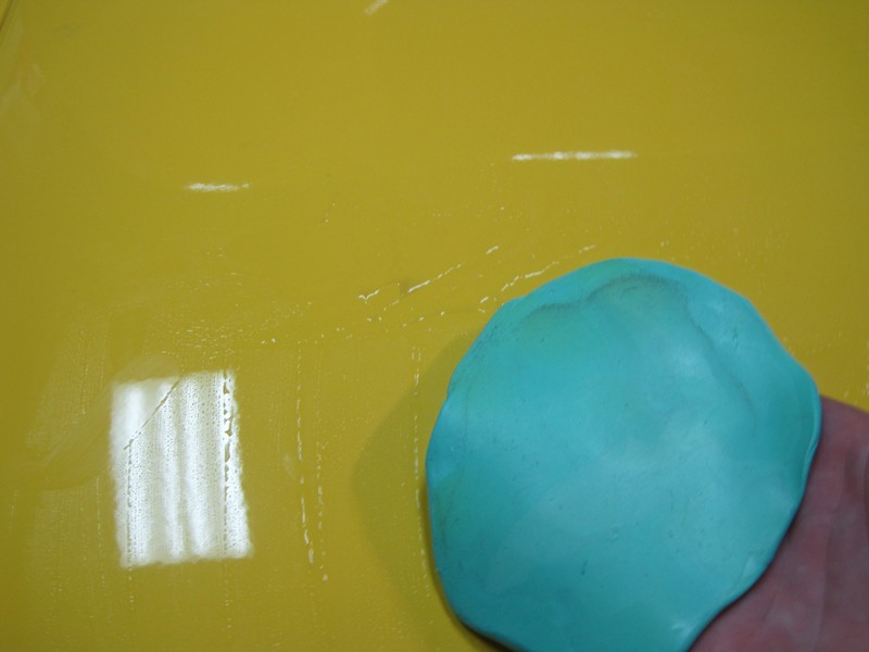

Step 3: Lubricate and Rub
Spray a small area with clay lubricant. Gently rub the clay bar back and forth across the wet area. It will grab at first. This means that it is pulling contaminants out of the paint. When it glides freely, the paint is clean.
Step 4: Wipe Off the Clay Residue
Wipe the area with a microfiber towel and use the clay lubricant to remove any clay residue. Rub your fingers across the paint and it should be as smooth as glass. If it’s not, repeat the process. Reshape the clay bar as needed to expose a clean surface. Keep the clay well-lubricated.
AS YOU CAN SEE, THE CLAY DID PICK UP SOME CONTAMINANTS
