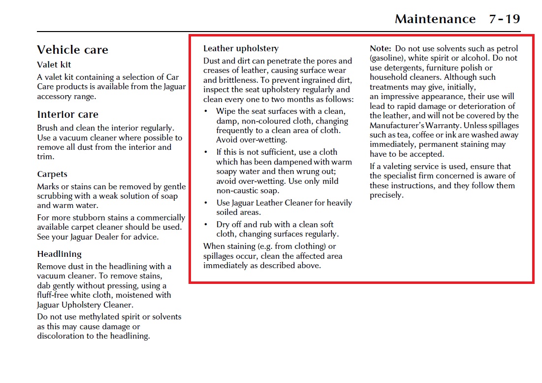

Thanks for this. I suspected a damp cloth is usually best.
If the finished leather can still dry out (can it?) don't we still need to condition it?
Does the Jaguar cleaner also condition?
