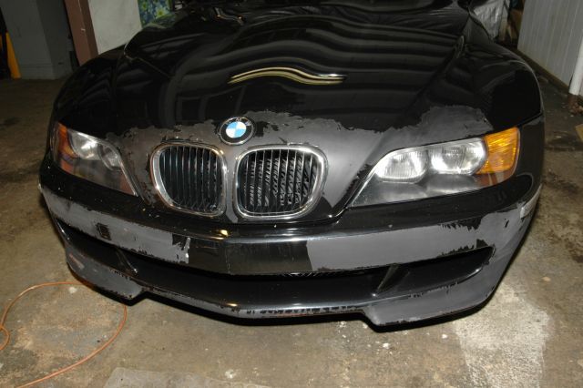

Mike,
Your very welcome......
In regards to your last question......
PPF is like a set of tires, and it is in no way a perfect product. Why I say its like a set of tires is because it does wear out over time, but at the same time served it purpose. Maintenance is key with PPF to preserve the overall look and finish. Most PPF look great for 4-5 years and then start to degrade visually although still providing rock chip protection.
Whether or not the PPF will come off cleanly is always a concern....I always have a customer sign a release of liability before doing any removal. If the painted area that is wrapped is OEM, it almost always comes off without any issues. If it a repainted area that was wrapped, its a 50/50 without knowing how well the area was prepped before being painted. It could lift the paint in patches if it was not prepped properly. Another situation that I have encountered is that the film took a hard impact of some sort of debris, it protected the OEM paint but underneath the film the paint actually fractured. When the film was lifted a very small area of paint lifted, but I touched it up and rewrapped the bumper...
Here is an example of a PPF removal that I recently did on a Corvette that the film failed after 4.5 years. It was extremely tough to remove, but not one speck of paint peeled off and she looked like new when we were done.
Innovative Detailing presents our works of art.............: New lease on life for this So Cal 07 C6...2007 C6 transformed from "Beast 2 Beauty"
Here is a sample of PPF removal gone bad....found this one online, hope it doesnt scare you!
