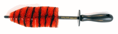

Hi There. I have a 2010 Jaguar XK with the 19" rims with the many narrow fins. Not sure the style name. What would be the best tool to use to clean in between the narrow fins on these rims. I can't get my hand in between and don't want to use a tooth brush as it is plastic and may scratch. Is there something available? Also, would just plain soap and water be fine as not to harm the rims finish? It is a silver painted wheel. Thanks very much.

Hello bocatrip and thank you for this question.....
Painted and clear coated wheels are as delicate as the paint on your vehicle, therefore it's best to always take the least aggressive approach when cleaning. Be sure the wheels are cool, and if in great condition I recommend either car wash soap and water, Adams Green Wheel Cleaner or Gloss It Signature Wheel Gel.
Spray desired wheel cleaner on the face and barrels, allow 30 seconds of dwell time and using a pastry style boars hair brush with a plastic trim rim liberally brush wheels. For the barrels I recommend a Daytona Speed brush or Wheel Woolies for thorough cleaning. As you clean you will notice a light foaming action of the cleaner, once cleaned free rinse with clean water. I always prefer to soap off after to remove any lingering wheel cleaner and neutralize it.
I usually will have 4 brushes...
1) Pastry style boars hair brush with a plastic trim ring
2) Daytona Speed Master Wheel Brush for barrels
3) Wheel Woolies
4) Soft toothbrush
Attached Thumbnails Sticky - Ask a Professional Detailer-wheel-brush.jpg   Sticky - Ask a Professional Detailer-daytona-speed-master.gif   Sticky - Ask a Professional Detailer-wheel-woolies.jpg
