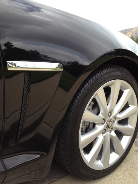

The previous owner of this 2012 XF faithfully took it to the car wash where it could get scratched and marred on a weekly basis. I decided to do a complete three step paint correction followed by a glaze (to hide anything I missed or could not remove), followed by a sealant, and a wax. I did this over the span of 3 days. Hopefully you can pick up a few tricks and time saving tips that can help with your own detailing efforts!
Note: I am not affiliated with any product line or company, nor am I a professional detailer. The products I used were either items I used previously or found to be regulary used with success by others on detailing boards.
First the wheels, wheelwells, and tires were cleaned with Advantage which is an all purpose citrus based cleaner.

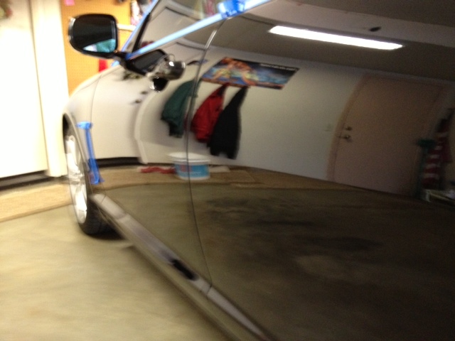

Next the car was rinsed with water and foamed down with a foam gun. I used Dawn Dishwashing Soap to remove the wax and other debris on the finish using the two bucket method with a microfiber wash sponge. This is the ONLY time you want to use a dishwashing soap. Otherwise, stick to a brand name car wash soap perferably with a wax. Otherwise you will strip off all of the wax on your car and dull the finish.

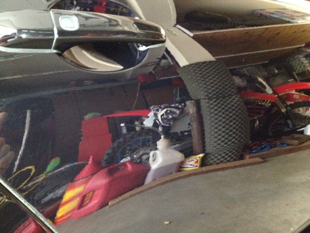

I then pulled it in the gargage and clayed it while it was wet. I used Griot's Garage Spray Wax as my clay lubricant. As you can see, the car had a significant amount of contamination. The debris you see in the clay was after only doing the hood!

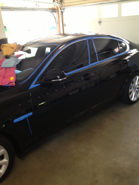

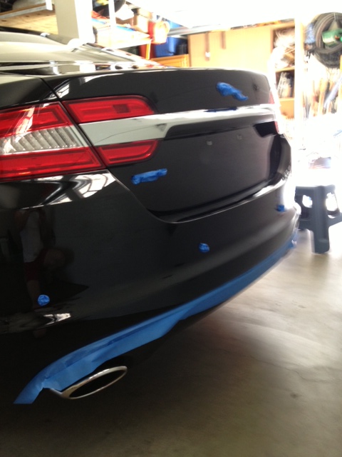

Next, I taped off all of the areas I did not want polish to creep into. Don't skip this part because it can take alot of time to remove polish residue from these areas and you also run the risk of getting the dried polish on your surface and causing scratches.

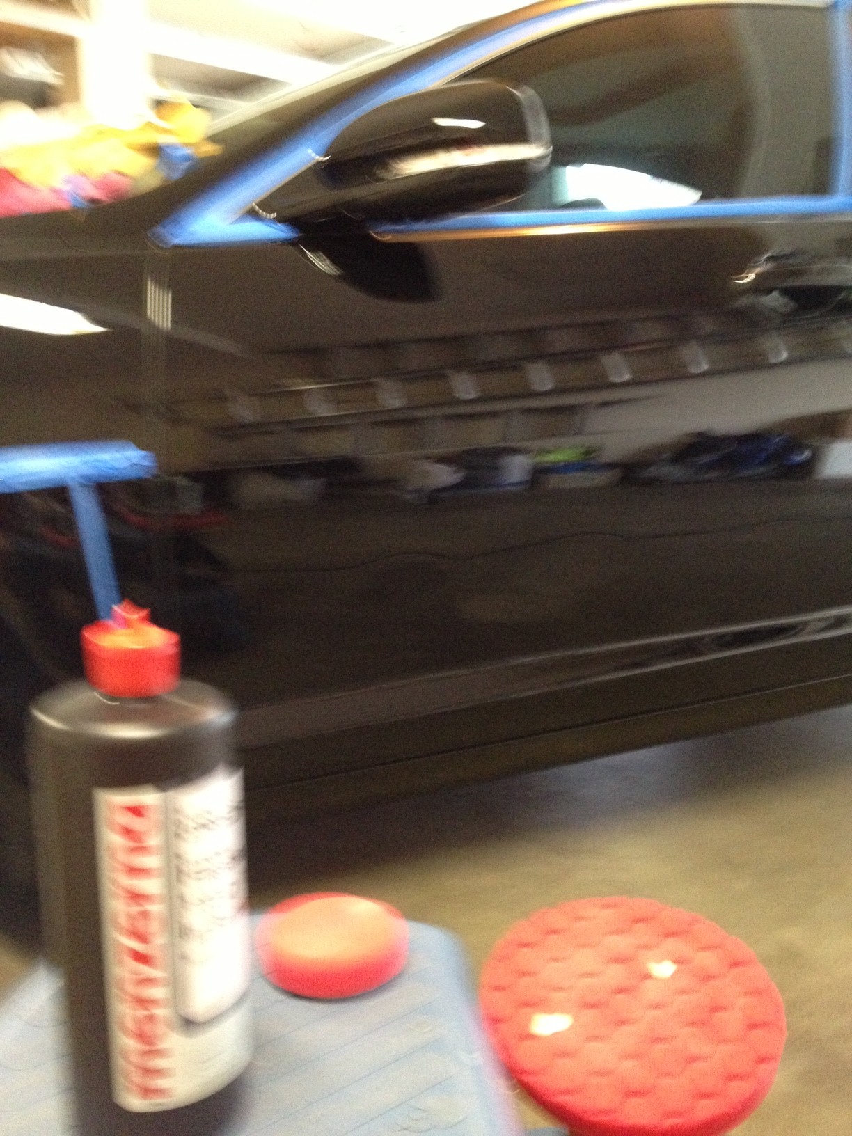

I used the Griot's Garage Dual Action Orbital Polishers. They come in a 6 inch and a 3 inch size. I also used a swirl finder light to identify problem areas. To polish, I used Griot's Orange Pads and Hex-Logic Orange Pads from Chemical Guys.

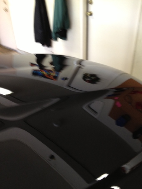

The back trunk area had several badly scratched areas(see pictures). However, I kept working on the area and got rid of them all. There were a few other areas that I had identified and I focused on knocking these out prior to doing the rest of the car.
Then after doing a test spot in a 2 x 2 section of the worst area, I tried using different compounds to see what would work. I ended up using Chemical Guys V32, V36, and V38 on the entire car with the results pictured below.

I next used Manzerna's Finishing Glaze 115C and the Manzerna Poly Lock Polymer Sealant. I used Griot's Red Pads. The shine and reflection was really good!

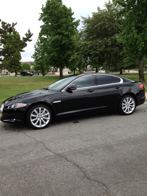

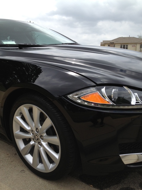

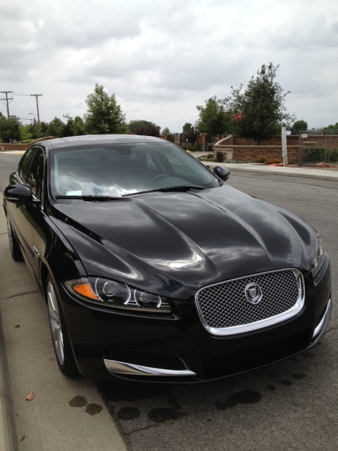

Here is the finished car after 32 hours of work.

XJL - I'm with you buddy, who takes their car to a drive thru car wash???
Totally over the moon with those results after all that hard work I'll bet......Kudos to you my friend and congrats on a beautiful looking car.
One point of note here ( constructive criticism ) I guess you'd call it.
Your detailing efforts are excellent, I'm a little envious even, but.......
You really need to brush up on your photography skills to show off both your gorgeous looking car and the results you managed to get.
Thanks for sharing...........happy motoring
