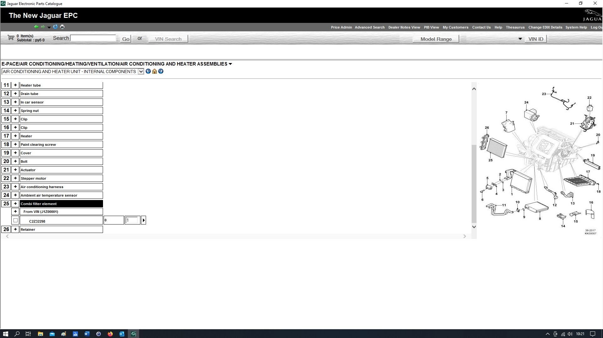

The JEPC diagram suggests it's going to be accessed through the passenger compartment and my guess would be from below or behind the glove box:

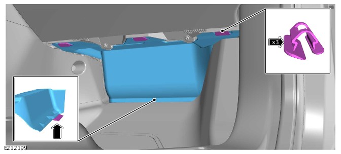

    • Release the 3 clips.
    • Remove the instrument panel lower trim.

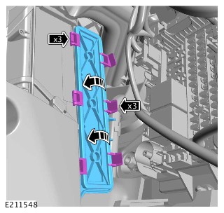

    • Remove the cover.
  1. Remove the interior air filter.
