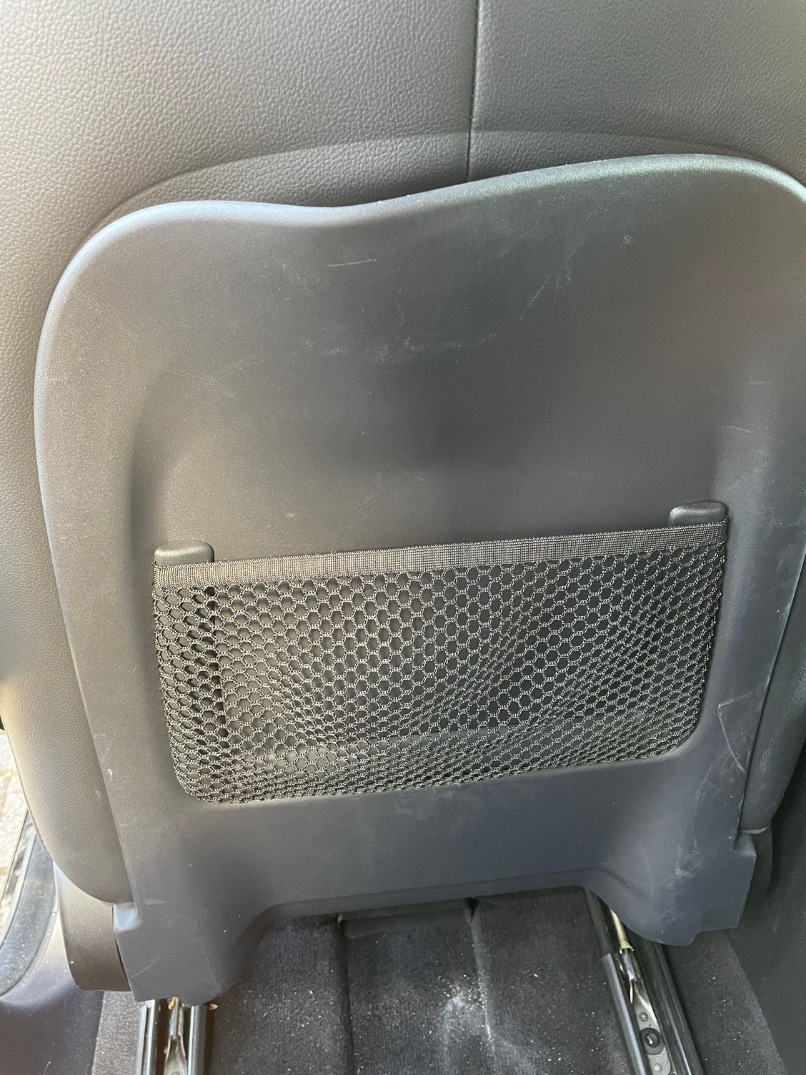

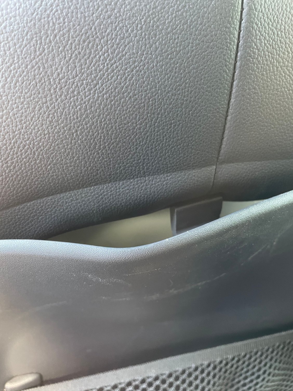

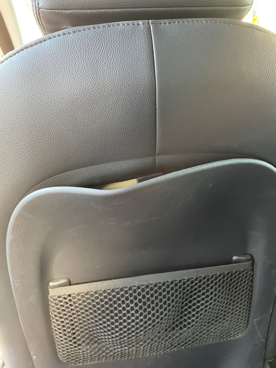

I was wondering if anyone can help me, the front passenger seat was pushed back all the way hitting our baby’s car seat and it seems to push out the front seat back panel (pls see the attached images) any help on how I can put it back? I tried pushing the black click on thing but it’s stiff and won’t be pushed down in. Any help would be appreciated.

Did it recently happened or it's been like that for a while? The way I look at the pictures someone from the back rip it out. If I have to do this myself, I'll take it out off the seat and observe what has gone wrong. If the plastic has been molded out due to extreme heat inside the car when parked on a hot day there's nothing you can do. But if it is missing by a clip, look at the bottom and it is more likely there.
Here are some picture shots from eBay so that you'll have an idea what to do.
