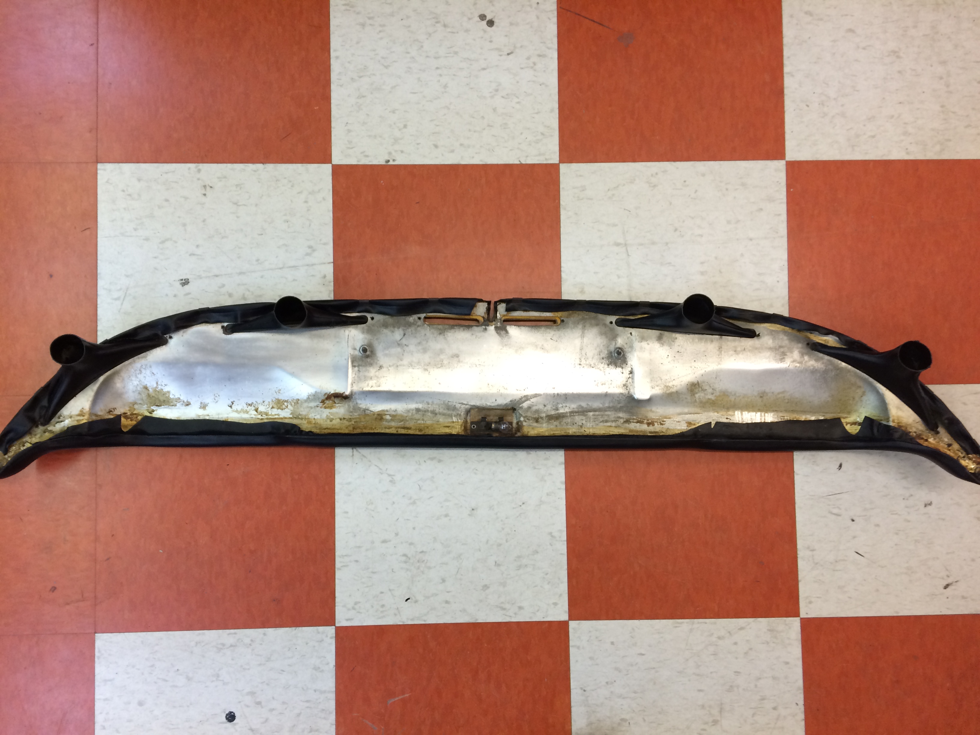

I am currently interning at a shop for the summer, started last month, and must depart in early August. The goal is to finish the electrical and final assembly before I leave on a '67 E-Type Series 1.5 OTS with the 4.2L engine.
In the attached picture, our dash pad is in great condition and we will re-use it. However, it appears to be missing the center plastic duct. I need to confirm that there is indeed a center duct there and where to possibly get one without replacing the whole dash pad. The parts sources I checked only sell them in kits for all 5 ducts.

Pretty sure there is. I have the dash off of my 68 and will look tonight

Two separate ducts that go to a Y piece and into a single tube. I will post picture
