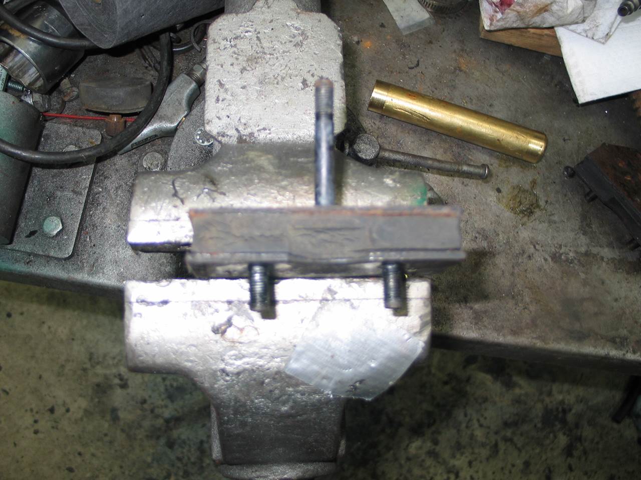

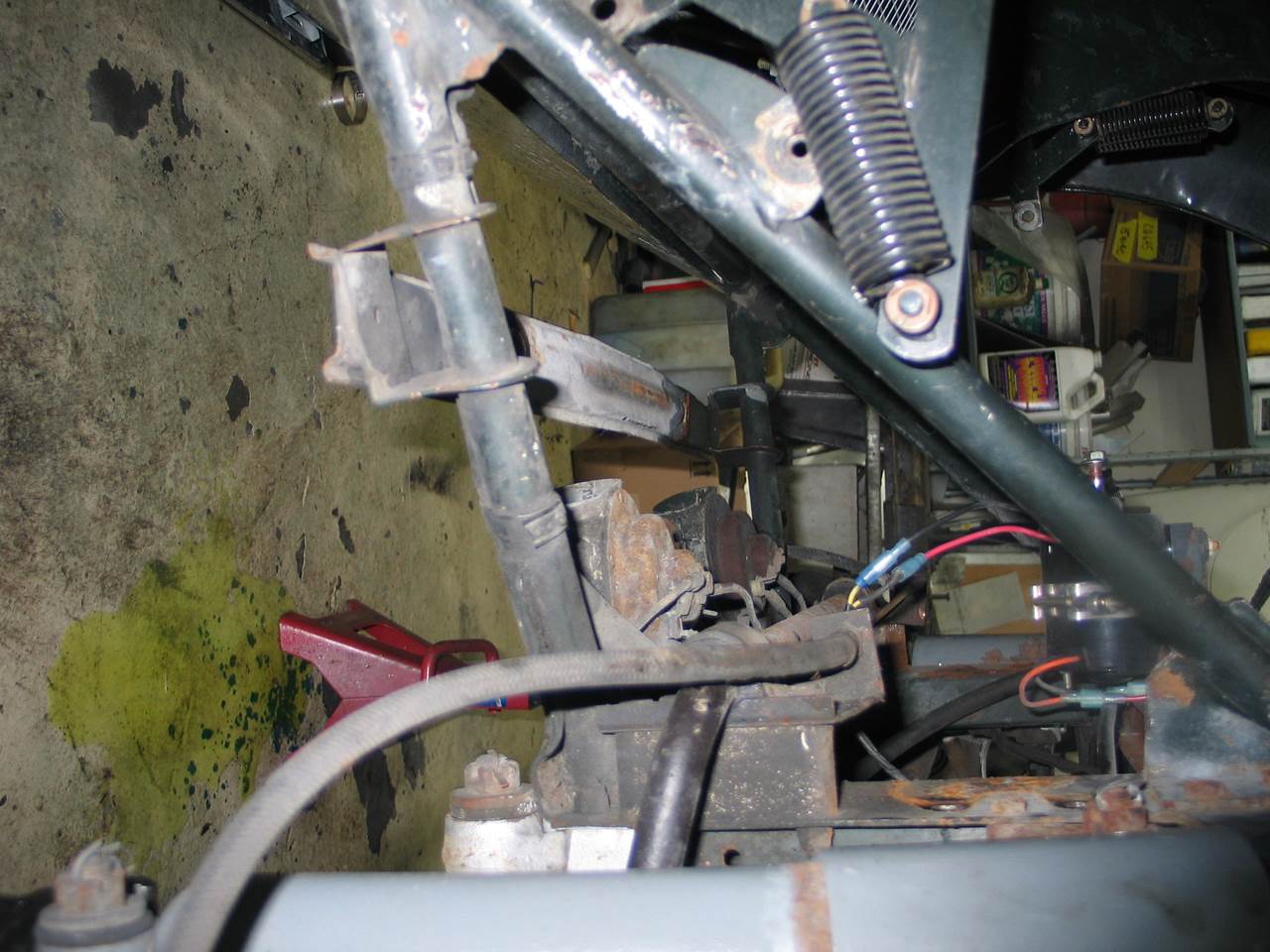

I am ordering the new Metal Elastic steering rack mounts. Both mounts have seperated from the steel backing making the steering rack loose and causing the steering to the right. This looseness also caused the fan to strike the fan shroud.
To correct the leaking brake fluid I am ordering a new master cylinder and a brake booster rebuild kit. In addition we will install new lower ball joints.
I have attached pictures from my mechanic.
John
John
