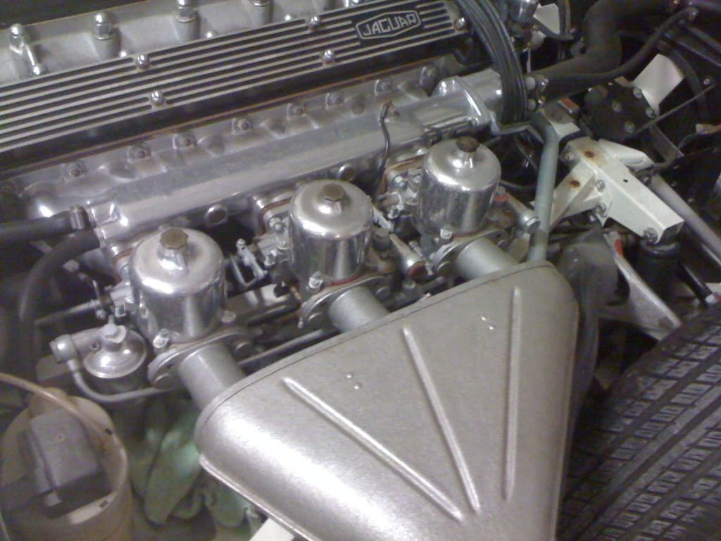

talked to my dad (previous owner) and no they are not webbers despite him saying they were for years.
strombergs from a 65
Old Feb 26, 2011 | 08:03 AM
SCMike's Avatar
Joined: Dec 2010
Posts: 791
Likes: 152
From: South Carolina
These are no more Strombergs (no 1965 Jaguar carried Strombergs) than they are Webers. Your car very clearly has the triplet of SU HD8 standard on all the 1967 and earlier XKEs. Looks like someone has done a total retrofit (from intake manifold outwards) of SUs on your Series 2 (which would originally have had a pair of emissions-controlled Stromberg 175 CD2SE). From the position of the rag underneath the rearmost SU, I would guess (and that is only a guess since this is just a "virtual diagnosis") that you have gas dripping from the bottom of the rear carb due to a torn jet diaphragm. If this is what it is, you are lucky that it is the rear carb - the SU at this position has enough access so that the diaphragm can be replaced from below with the carb in situ. It's just a matter of undoing the four screws on the bottom of the carb (and maybe the choke linkage - I forget), removing the bottom cover/float chamber unit, and replacing the jet diaphragm. Since you will be working against gravity, the re-installation will require some ingenious use of duct tape (since you do not have three hands). I think that this is simpler than entirely removing the carb to work on it. Not too long ago, I did the same job in situ on the middle SU, which is an order of magnitude more fiddly because of the position of that carb amidst all the plumbing.
