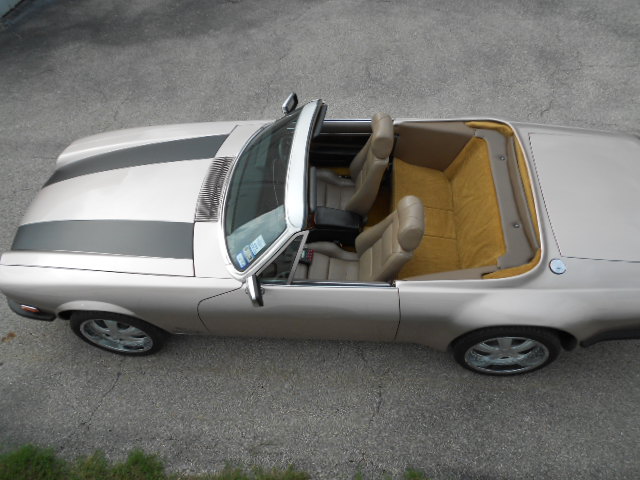

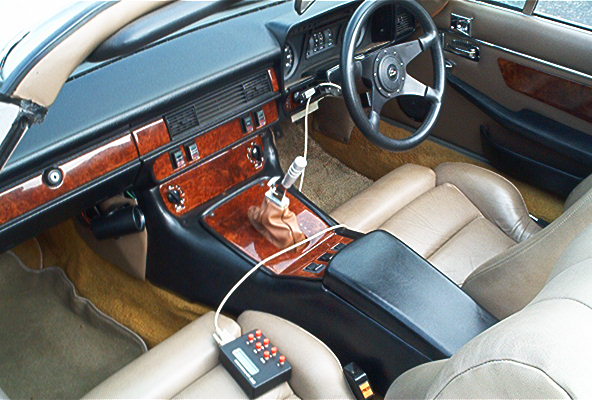

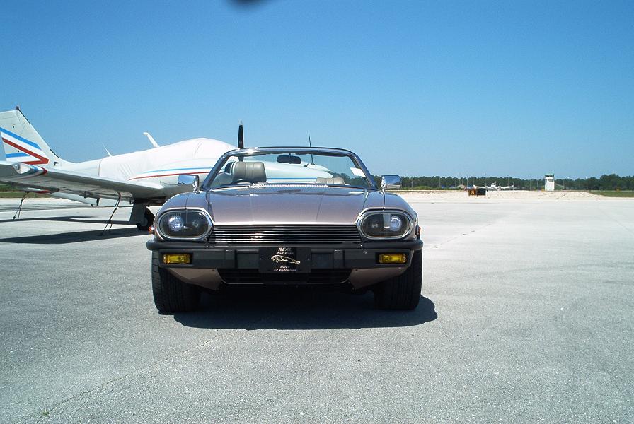

a little off topic.
1978 XJS converted from coupe to roadster around 1982-83, done in Kent England, some reinforcement bracing, and modded V12 , runs and drives great(thanks to GM electrics under the hood),wide body RHD.
gets a lot of attention at car shows and just parked in front of sidewalk restrurants.
custom paint, Champagne silver, complete redo interior, Recaro leather seats,etc. F/S!!
Attached Thumbnails Chopping a FHC-mazda-jaguar-001_copy.jpg   Chopping a FHC-mazda-jaguar-002.jpg   Chopping a FHC-mazda-jag-rodst-032.jpg   Chopping a FHC-jaguar-engine-build-process-001.jpg   Chopping a FHC-jag-overhead-004.jpg
