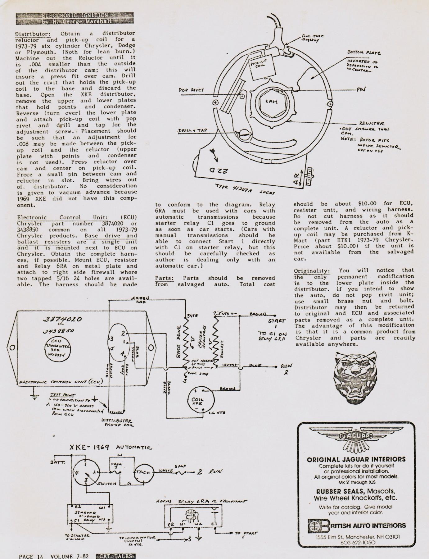

Was going through my files and ran across this conversion that I submitted to Cattails about 25 years ago. The total cost of this conversion was about twenty dollars back then. Most parts came from Chrysler cars, Plymouth Dodge etc. The ECU was sold by Walmart and ran about ten bucks. At the time I had a 1969 E-type that I converted. Ran beautifully! Please don't ask me for more info on the conversion. Time has fogged my memory..Just passed this on for info
All the info for the conversion is on the attachment
Just looked on Ebay and found most of the parts for sale and still priced reasonably.
