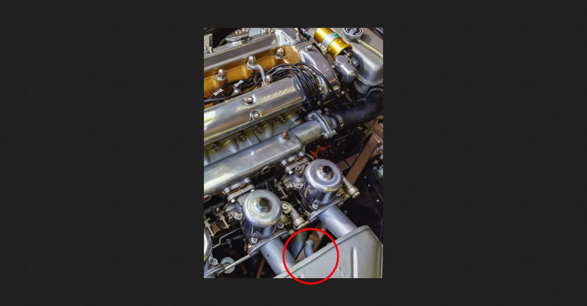

Here's a photo snip I took of a 1967 that's on a Hagerty auction. It shows a bit of the breather hose at the front of the engine. That hose is then NOT connected to the the back end of the filter plenum. Not sure if OPs carb setup looks like this.

Someone removed the hose. The fitting is right there:
