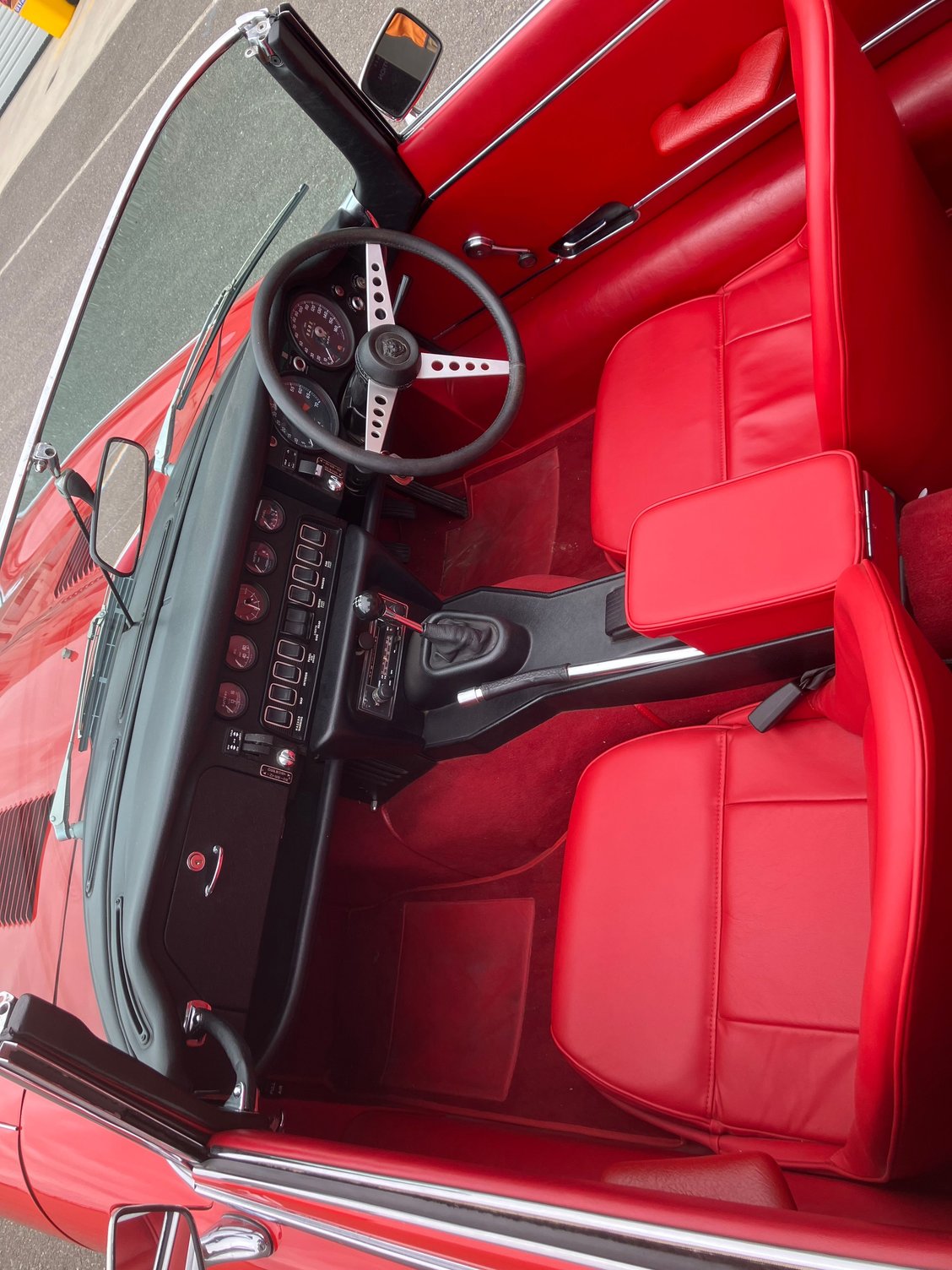

I looked at this S3 1974 yesterday. It looks like it has S2 seats. The seats didn稚 have any adjustment to them.
I suspect the original seats were replaced and bolted hard to rails rather than fixed to original spec.
Does anyone have any comments?
Am I correct that these seats are not S3 (they had a head rest)
Should s3 or S2 seats have adjustment (front - rear)?
They're not series 2 seats, and certainly series 2 seats had fore and aft adjustment as well as recline.
People do fit different seats to E's; mx 5 seats fit well, and give a bit more headroom. I'm not sure what series 3 seats are like, but it's possible a different manufacturers seat has been fitted.

Looks like 3.8 seats, judging from the illustrations on this Moss page:
https://mossmotors.com/jaguar-e-type...eats-seat-kits
Here are S3 seats:
https://www.aldridge.co.uk/brands/ja...r-v12-s3/seats
Series 2 seats have adjusters for fore and aft movement, rake adjustment and also a 'curve' into the area just behind the seat back to allow for yet additional back movement.

Personally I don't know why 3.8 seats would have been put in this car. Most owners indicate that they were extremely uncomfortable.. no rake adjustment either. I would be suspect of other replacements in this car. Just because it's a Jaguar E type part doesn't mean that any E type part can go in just any E type. Production was a rolling process of updates, corrections, improvements, changes, etc. Do read up on them so you know what you are getting in to.
