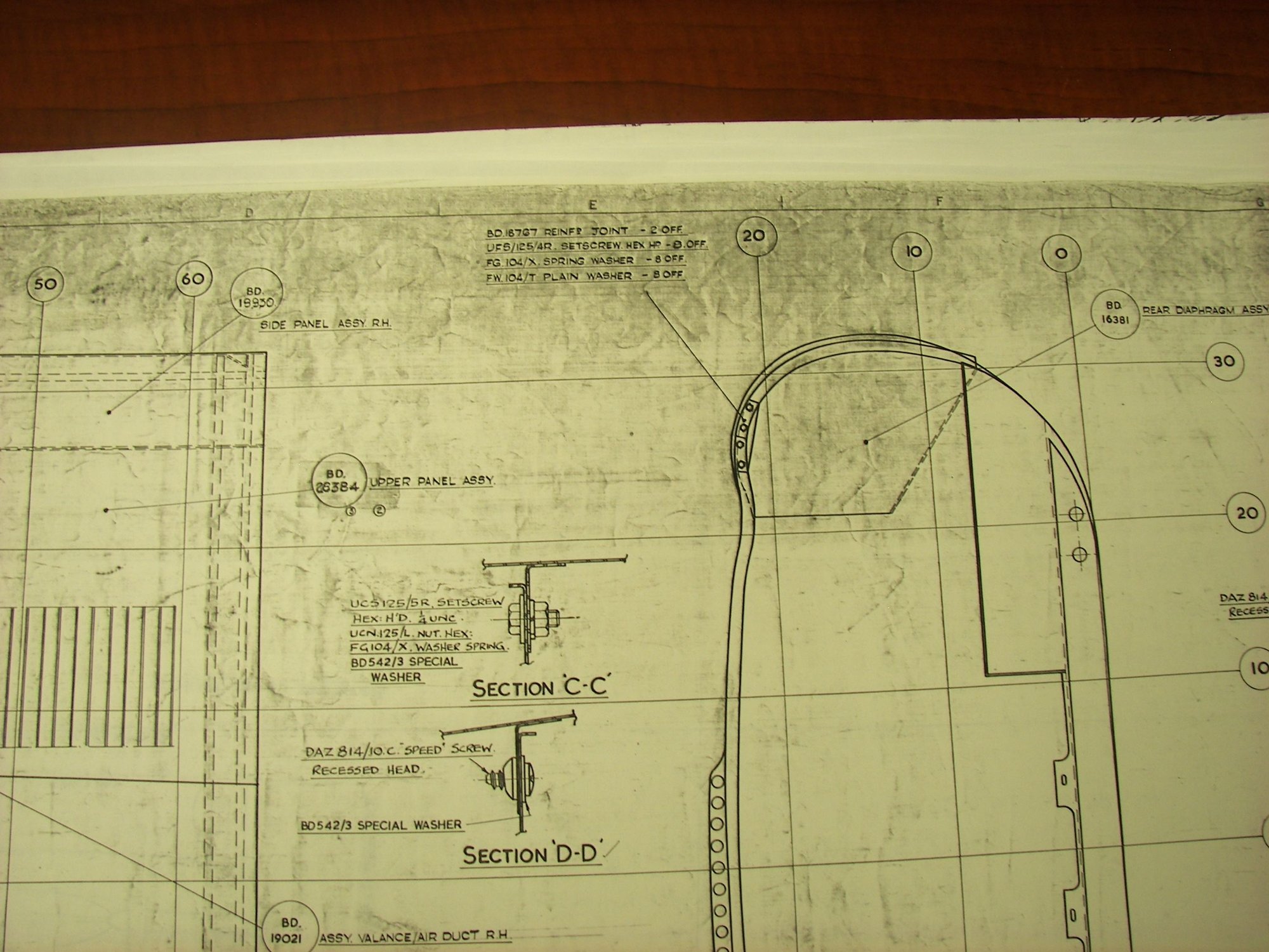

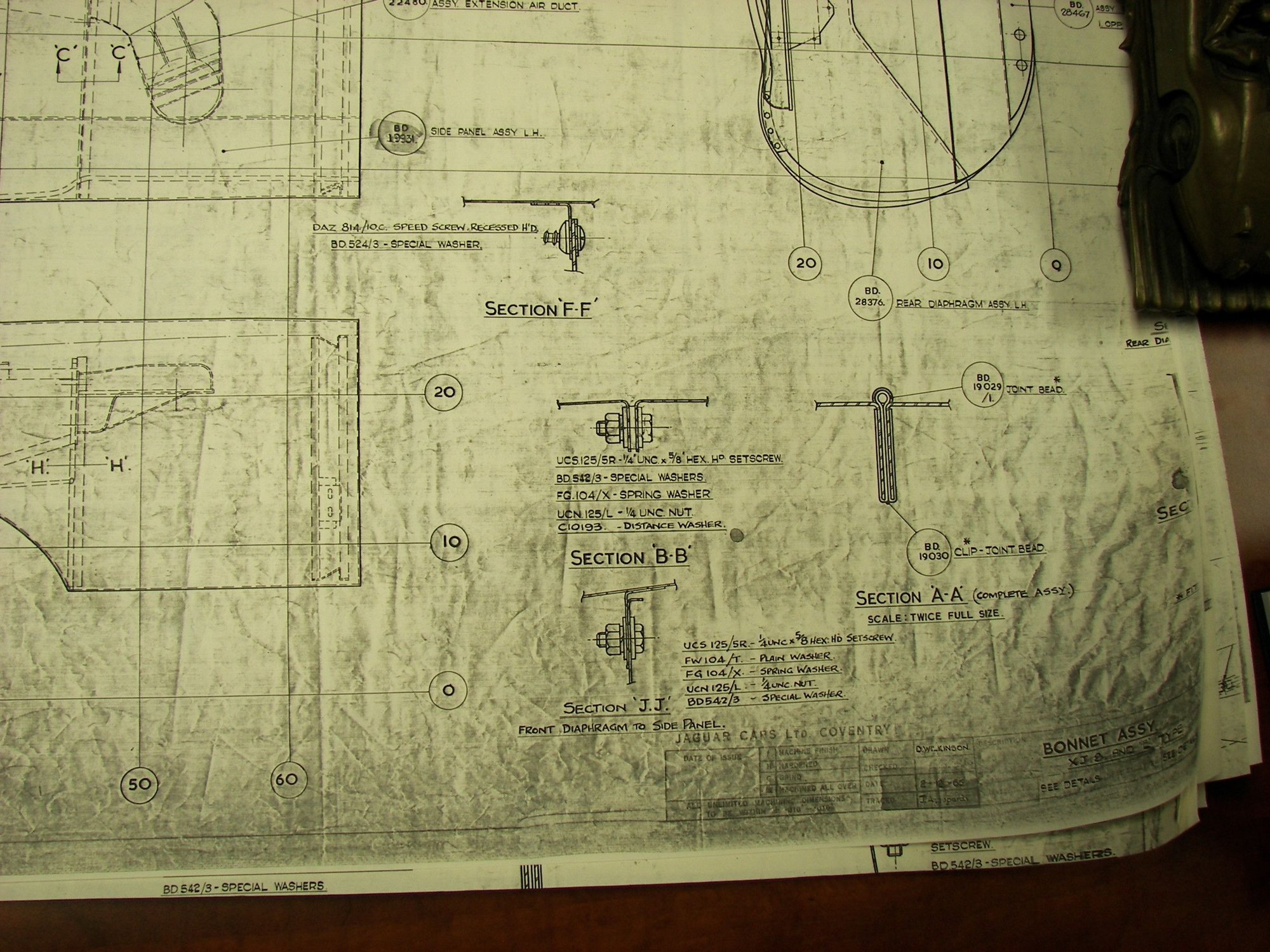

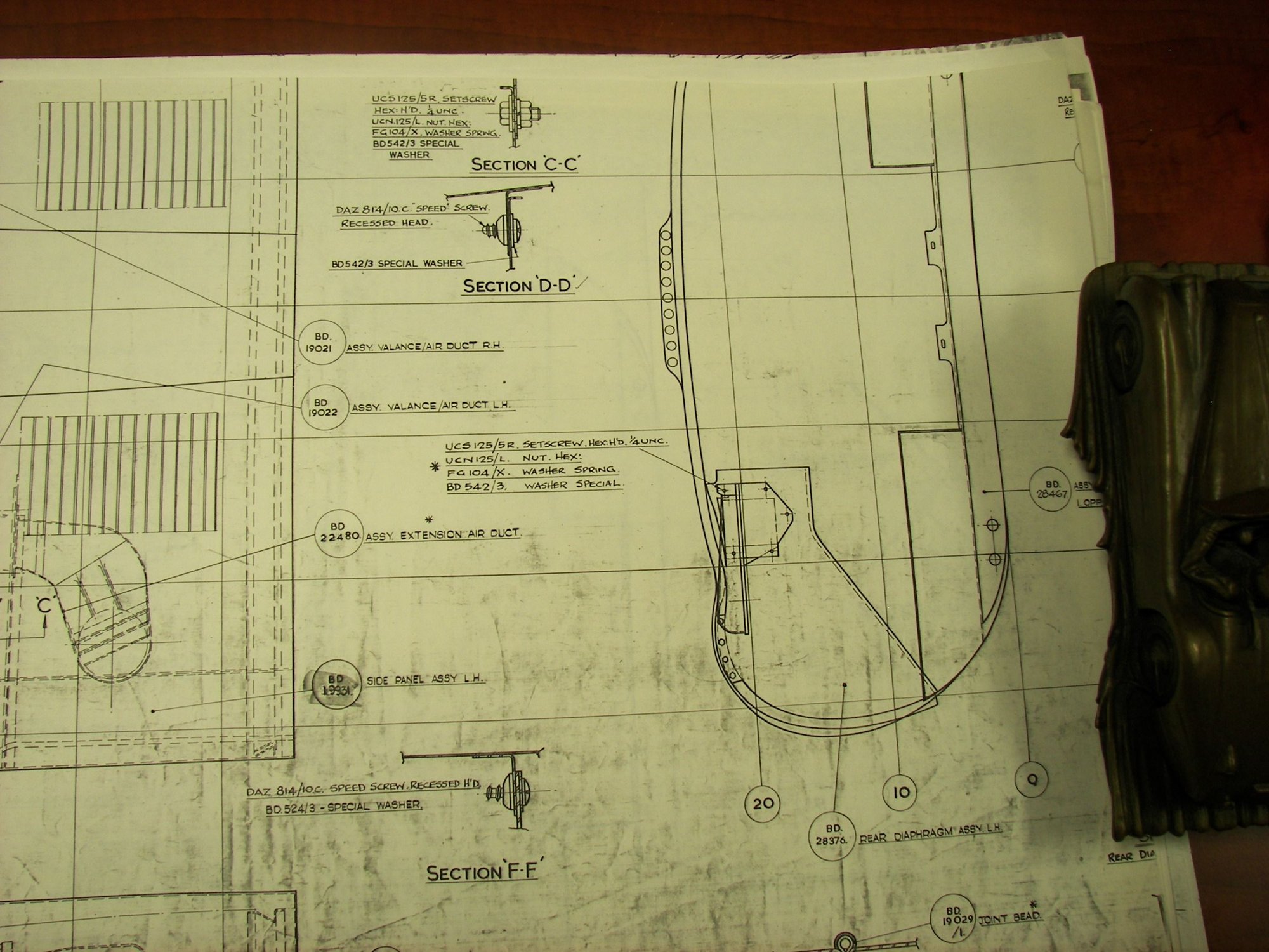

Hello does any know the dimensions of the bonnet Air intake the oval at the front of the bonnet in center meters? 1966 E-Type series 1

Jbitar---here are the bonnet blue prints held by the Coventry Foundation. I have not made a detailed study of them but I think you may be able to work them out from the other data listed. Of course the measurements are in inches as designed but you can do the conversions!
