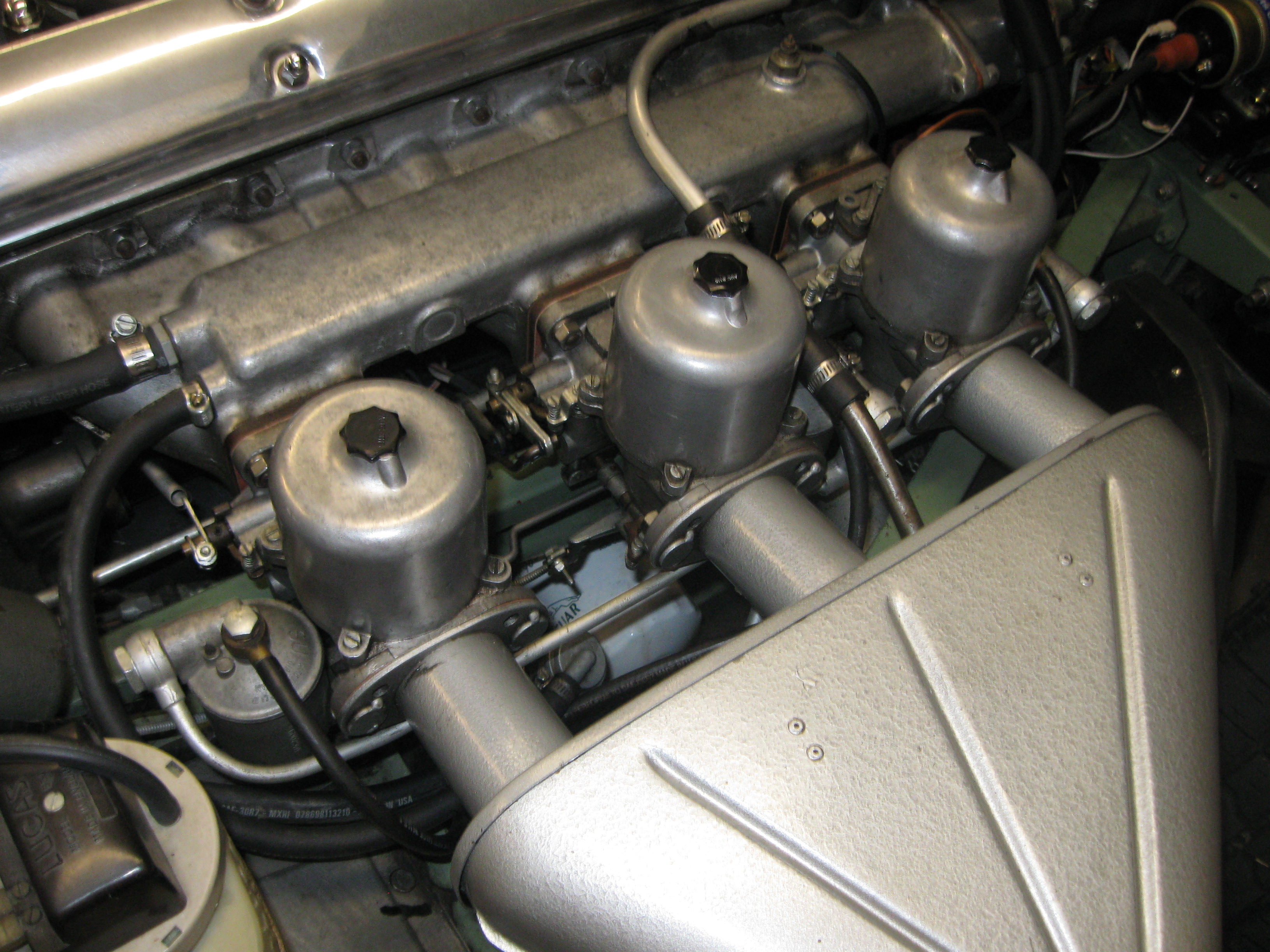

Bill, Wonderful improvement, I used a series three xj6 distributor , it bolts right in and had vaccum advance.
There are so many options today.
I used that system which I average 6,000 miles EVERY year on my series 2 with triples.
Enjoy.......it transforms the car completely, if your still itching , swap to a 307 rear if your car is in the states, you will drop 400 rpm per gear.
I'm closing in on 26 miles to the gallon.
Attached Thumbnails electronic distributor-01c1e12138c36199f70ebb5277c7ad49d07f398add.jpg   electronic distributor-01ea7ccb63c8dbe6e2b3bd5609ce255dd601906581.jpg

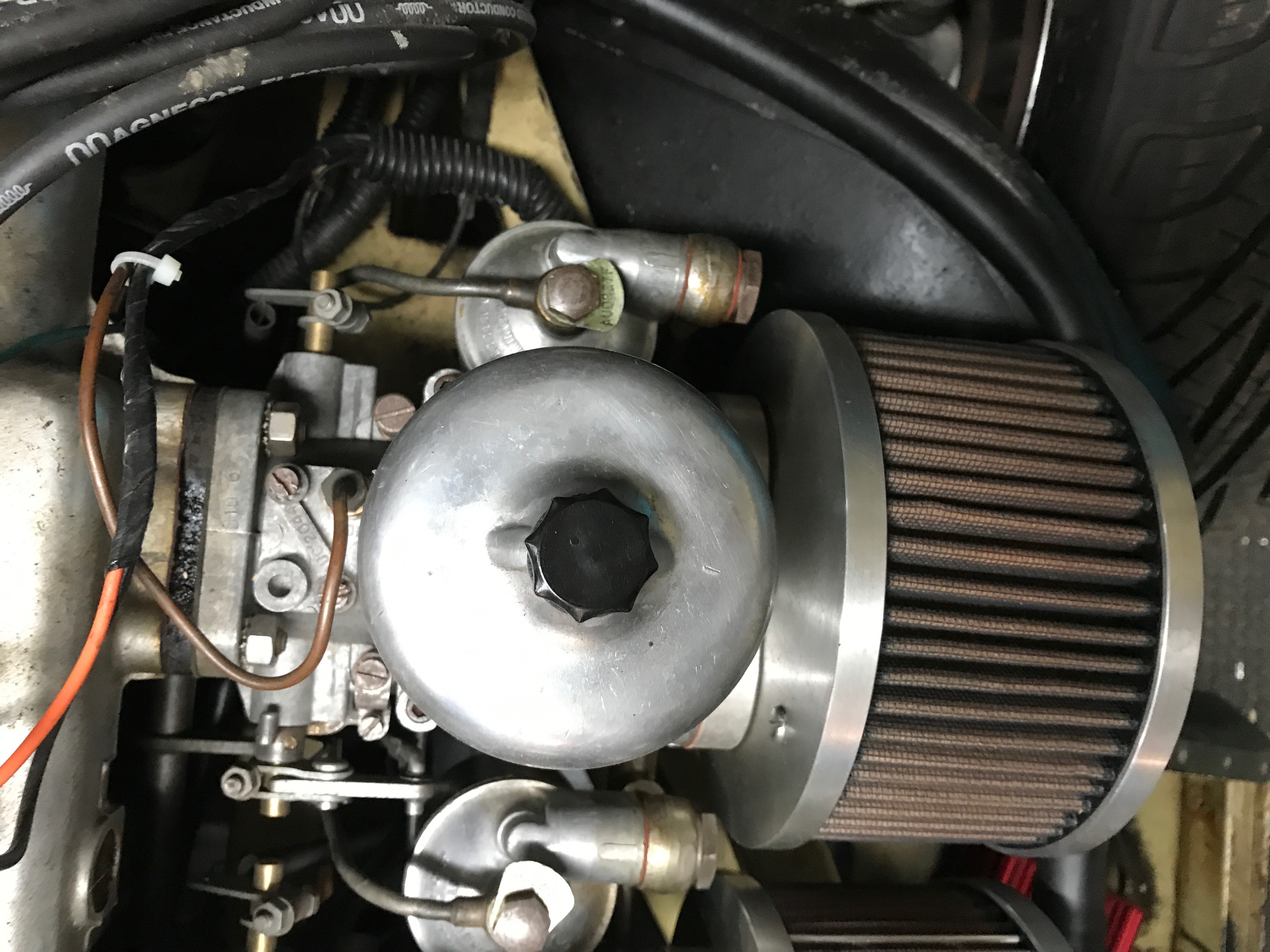

How about a pic of that "ITG" filter setup....

Ken,
Here is a photo of the ITG filter purchased from SNG Barratt. They have it listed as Mangoletsi, I guess the model name. The price is somewhat above $200 and You must purchase oil for the foam separately. Got mine from ITG.
Cannot tell you about durability, hope it is good.
Bill

Hmmm, interesting configuration......the need to add oil is similar to my K&Ns

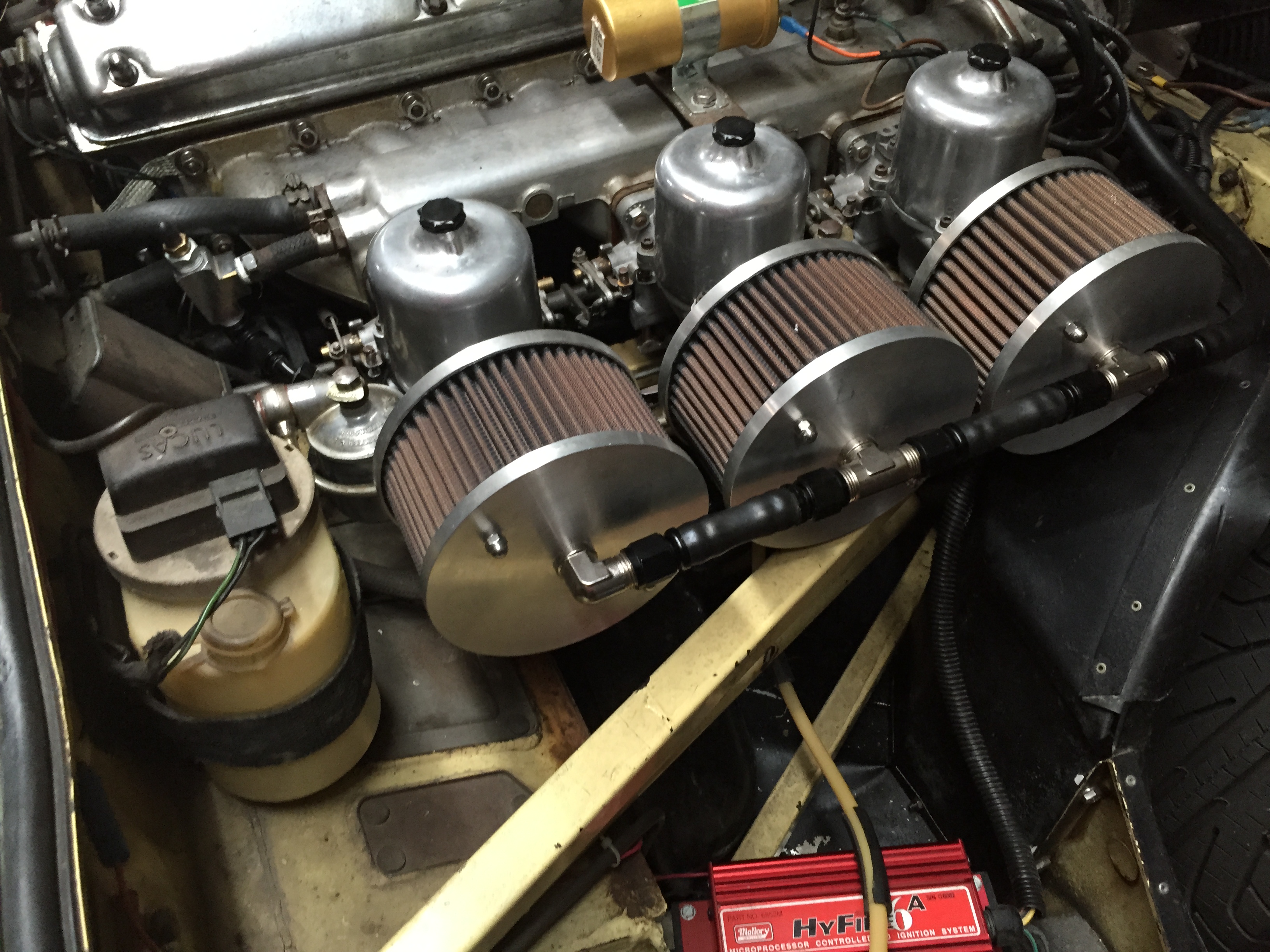

I went a little further, early cam box covers and k+n in the original container.
Besides the 100 other things....
Attached Thumbnails electronic distributor-img_1067.jpg   electronic distributor-img_1071.jpg   electronic distributor-img_1070.jpg

Looks like you rerouted the engine breather hose and made it smaller. Much neater. My largest concern with the ITG filter is potential damage to the exposed foam and placing it in the original air box would help that. Think I will check whether it fits and whether it breathes as well.
Bill
Old May 8, 2017 | 10:25 AM
gtjoey's Avatar
Joined: May 2016
Posts: 346
Likes: 63
From: new york
Bill, Here's why I went this route.
1. I wanted a stock look for asthetics.
2. With the canister, you contain the fuel smell which you get with open filters.
3. Im using the k+n filter hidden in the can.
4. the blowby pipe is actually larger and aluminium so it was easy to bend and clean out once a year .
5. Ive now added a pcv filter on the end of the pipe inside the triangle cleaner so residue doesnt go back to the carbs.
