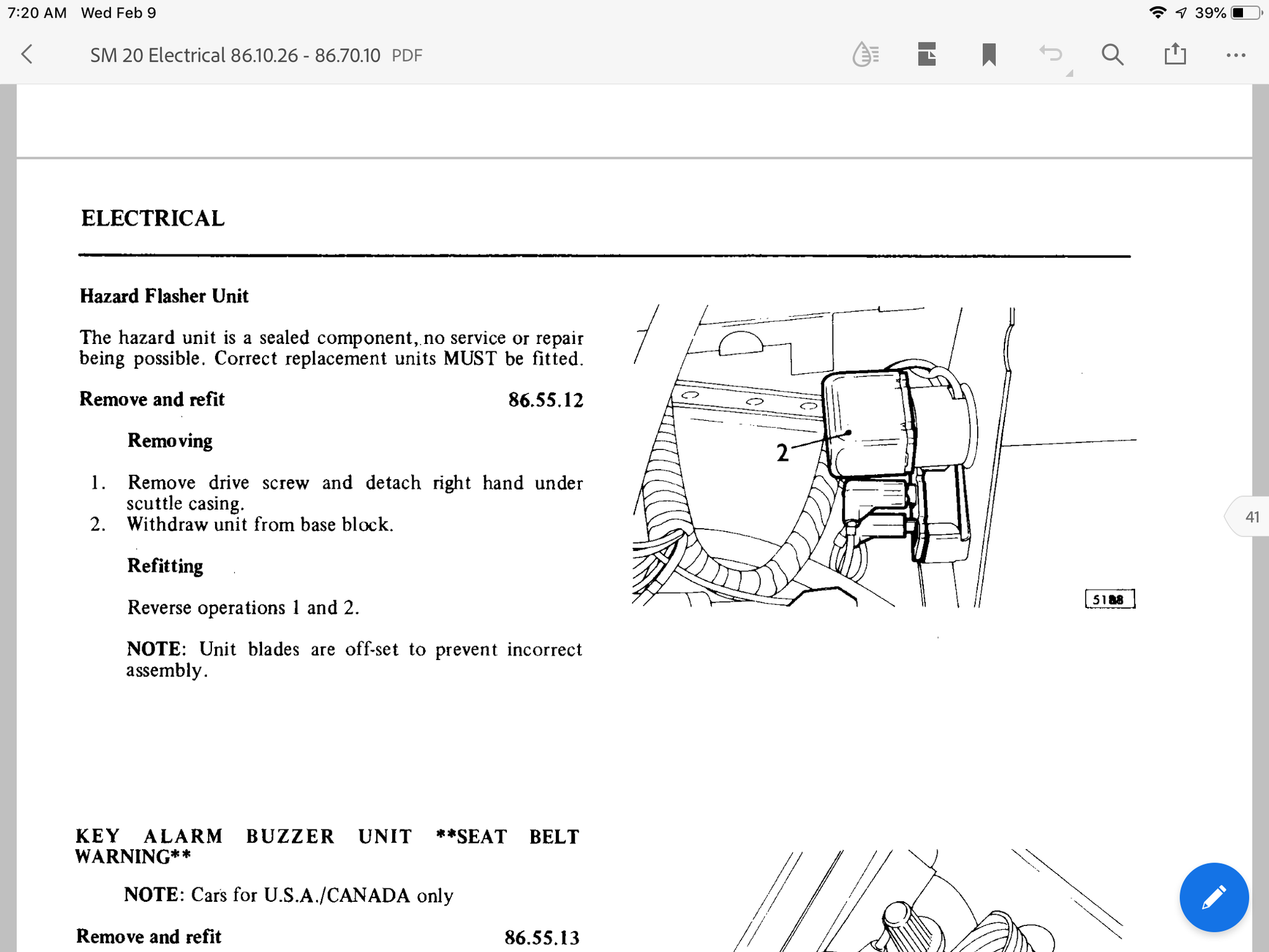

Where is the location of the Hazard Flasher unit on a 1974 E-type OTS V12?

The flasher units are mounted on the right hand bulkhead ... to the right of and behind the glove box.

Thanks!, found it with your help. Curious though, on my vehicle the round item indicated with a 2 in the diagram is the turn signal unit and the smaller rectangular unit is the hazard unit on my car. Also no screw removal required, just pull the relay out of holding bracket.
Thank you again!
