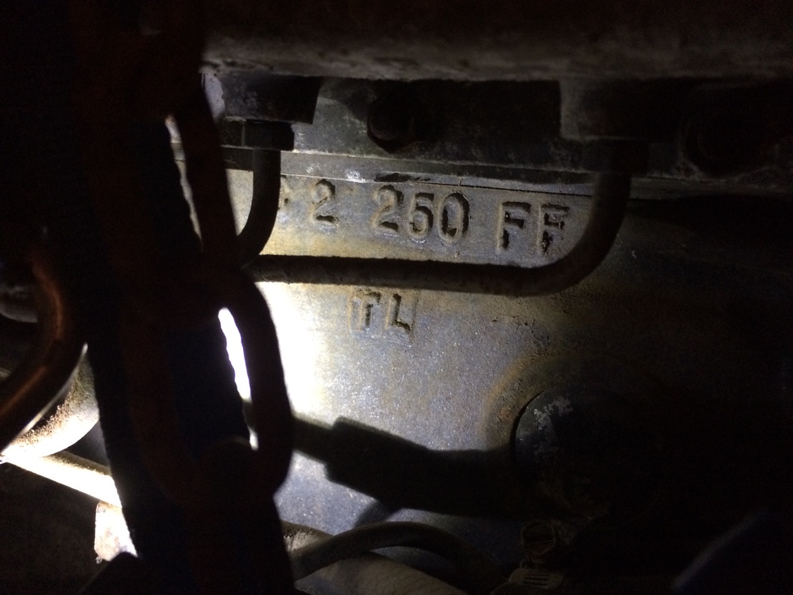

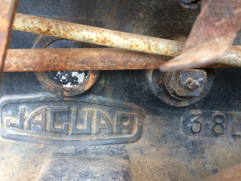

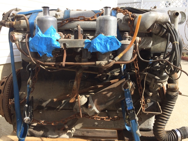

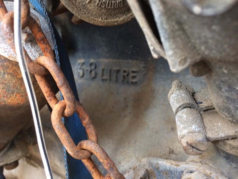

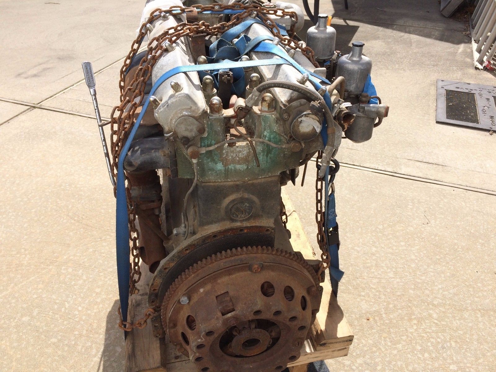

This engine is an XK that I am guessing was in a sedan based on the two carbs (I have the original to my car XKE carbs so no biggie). Looking at the color of the head, it looks like perhaps this was 3.4 head from the color and I initially questioned the seller on the motor because of that being odd on a 3.8. He has since sent me the attached pictures with the 3.8 liter stamp on the engine.
So a few questions.... based on what you are seeing in the photos, am I correct that this is the same basic motor as would have been in a series 1 XKE? What stampings should I be having him send me pictures of and where would they be located on the engine? What additional information could I gather to determine what this might have come from and confirm that it will work in my future application? What should a complete 3.8 cost in unknown running condition (seller notes that it is not seized and it will be completely disassembled and painstakingly rebuilt so I really just want good bones)?

Twin carbs indicates to me that it would be out of a saloon as the E-type had three fitted. Therefore it could be out of a Mark 2 or an S-type, as both had the 3.8 engine. There should be a stamped engine number somewhere. What you have shown so far are the casting marks. 3.8 blocks were used on both the saloons and the E-type, with Jaguar making the difference on the E-type with triple carbs and maybe a different cylinder head, and higher compression pistons.
