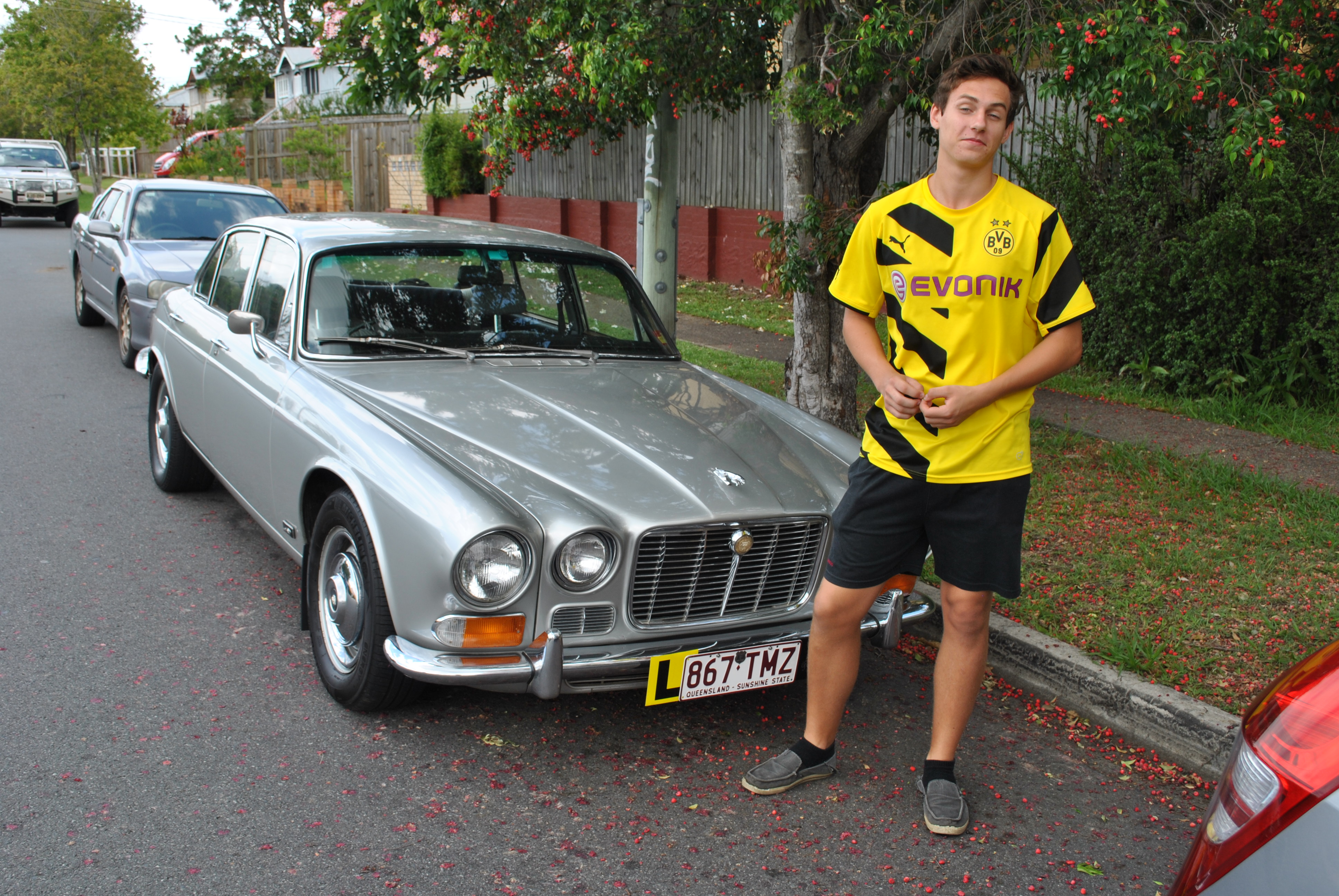

Mine is a 73 (only a mere XJ,if I dare mention that here!) but it gets driven every day by myself and Learner and P plate drivers . If I had an XKE or a D-Type, even a C-Type that wouldn't change. It would be driven by all that wish to take the wheel.
Cars are built to to be enjoyed by all,I don't care if my car cost $2000 or $2,000,000 . I would let my son drive it on P's or L's....and take his mats out in it.
It's all about the joy of driving,not the privilage!
