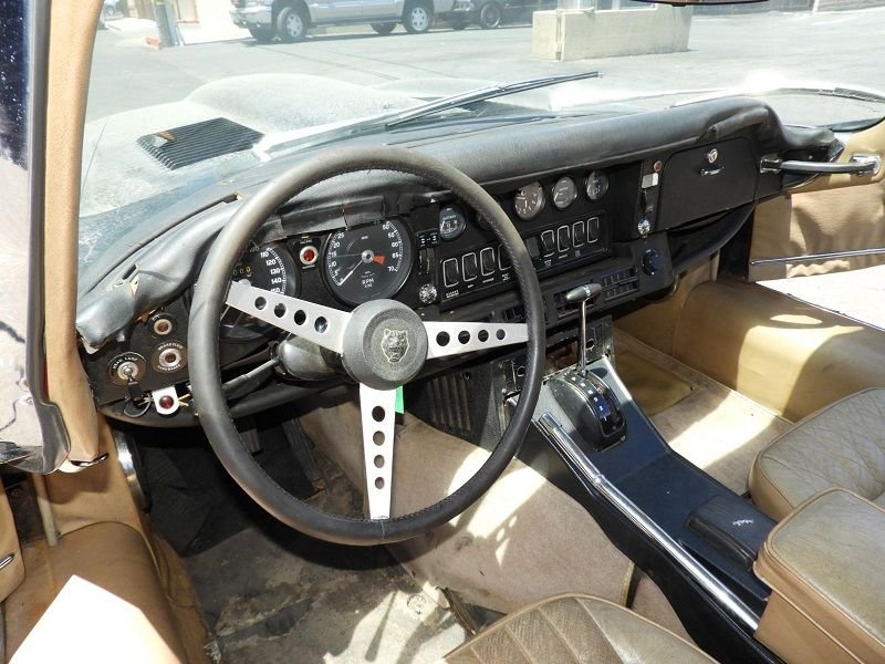

Here is a pic that shows the location of the current speakers. Barely but you can spot the two Waldos there:

Here would be some suggestions to consider. The original speaker locations in the center console could hold base speakers, not ideal because there is not much volume in the space between them, but it is available space. Do not put full range speakers there because they will interfere with each other resulting in poor frequency response. Your current location for main speakers is probably as good as you can get although with all the reflections going on, I am not sure what the results will be. You probably know best since you can listen to the current units. Tweeters should provide a noticeable improvement since high frequencies from the main speakers are lost in the foot wells.
Good luck. These steps are where I would start if I was willing sacrifice authenticity.
