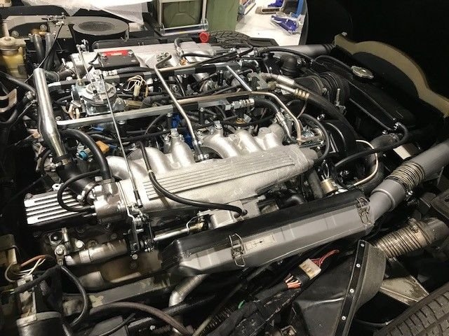

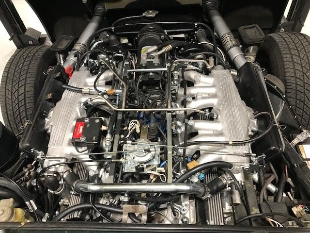

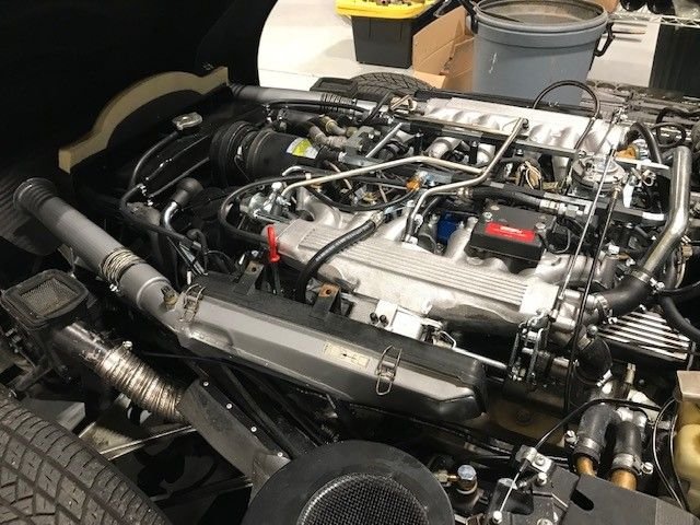

Then of course there is this alternative to SU or Stromberg.....
EFI from a XJS. Very nice, no choke, instant cold start and run without coughing. Very nice.

There is another post on this I did a while back:
https://www.jaguarforums.com/forum/e...?highlight=efi
But briefly, AJ6 Engineering, Roger Bywater wrote a conversion guide that I used. I did the work. All the bits came from a ruined 1988 XJS engine, including the induction, injection, ECU, wiring. I had to fiddle a bit with the water rails (they go thru the carburetor inlet manifold and had to be replaced with the XJS components that don't quite fit right) and restructure the harness for component location. The Series 3 fuel tank already has baffles around the pickup to insure fuel at the pump at low fuel level and a return circuit in place. The fuel pump was replaced in the same location with a high pressure unit. The ECU is under the passenger seat, the injector ballast, control relays and inertia safety switch are located on the right side firewall. I added lambda sensors on the exhaust, all the other sensors came with the XJS hardware. I modified the airboxes to fit the frame and fabricated a larger diameter inlet horn to mount in the same location as the original.
As it happens, the history is that the Series 3 cars were originally contemplated with EFI, but development delays prevented that from taking place. The program was deferred to the XJS. So I tried to make everything look like it may have been (should have been) in 1974. If you are not familiar, it looks like it came from the factory.
Roger also will re-program the ECU for this configuration, however the XJS programming seems to work fine. He has an ECU of mine for that purpose, and he also modifies the throttle body to a larger diameter that will finish the program.
It took quite a bit of calendar time because I only worked on it a few hours a week. Full time, maybe 6-8 weeks. In my case expenses were components: replaced the sensors, had the fuel rail and injectors rebuilt, and had to fabricate a few components.
There you have it. All in all a good result.

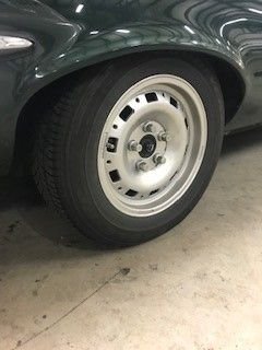

As an aside. What tires are you using on your car. I am stumped as to what to put on.

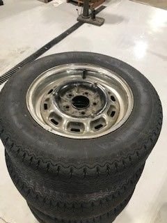

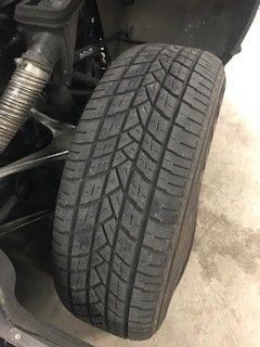

I have two sets of wheels and tires. The original steel wheels have Dunlop SP Sport ER70/R15. That's the OEM look. The alternate is alloy wheel, reminiscent of the wheels on the D-Type, I believe slightly wider and the tires on this are Goodyear Eagle HP P205/65R15. That's about the biggest tire I can get on the thing, I had to take about an 1/8" off the center of the wheel to get the tires in far enough to avoid brushing the tire side against the inside of the rear fenders. It would just brush the fender when the suspension bottomed on a high speed dip in the road.
I don't drive the car aggressively enough to be able to see any real difference in performance of the tires.
