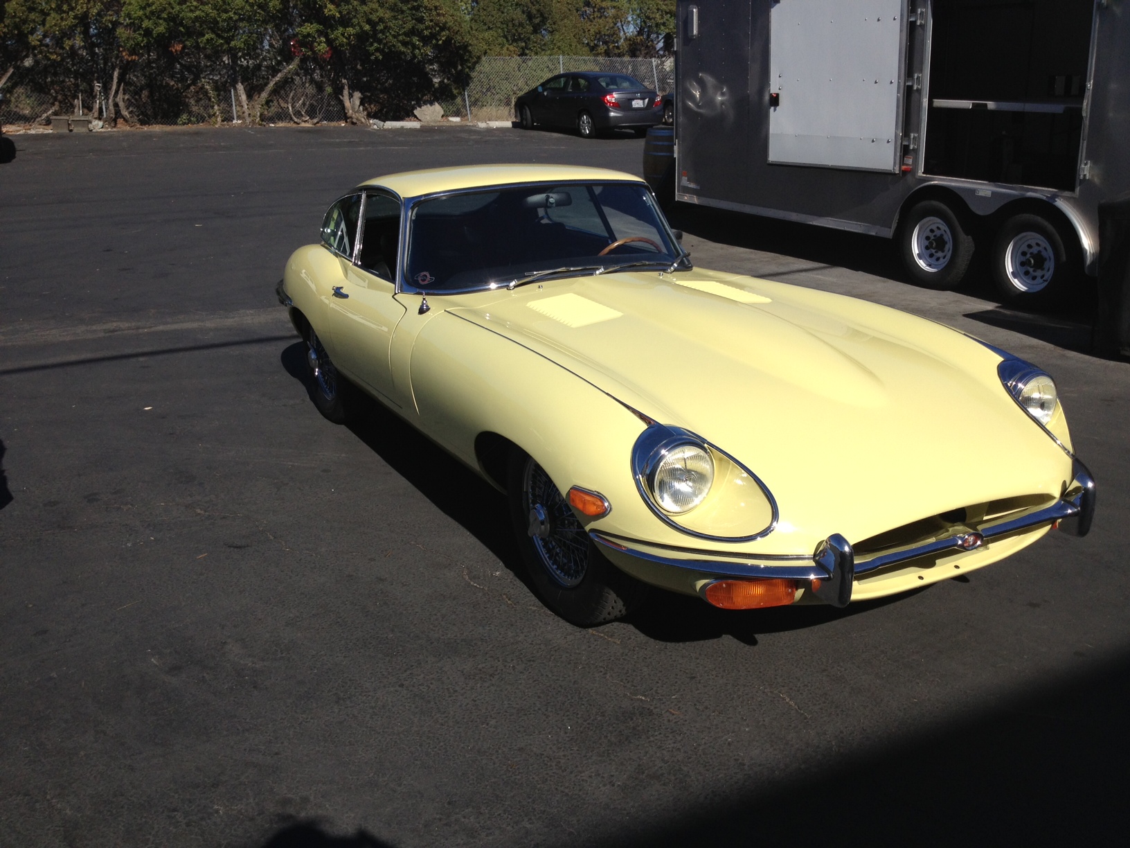

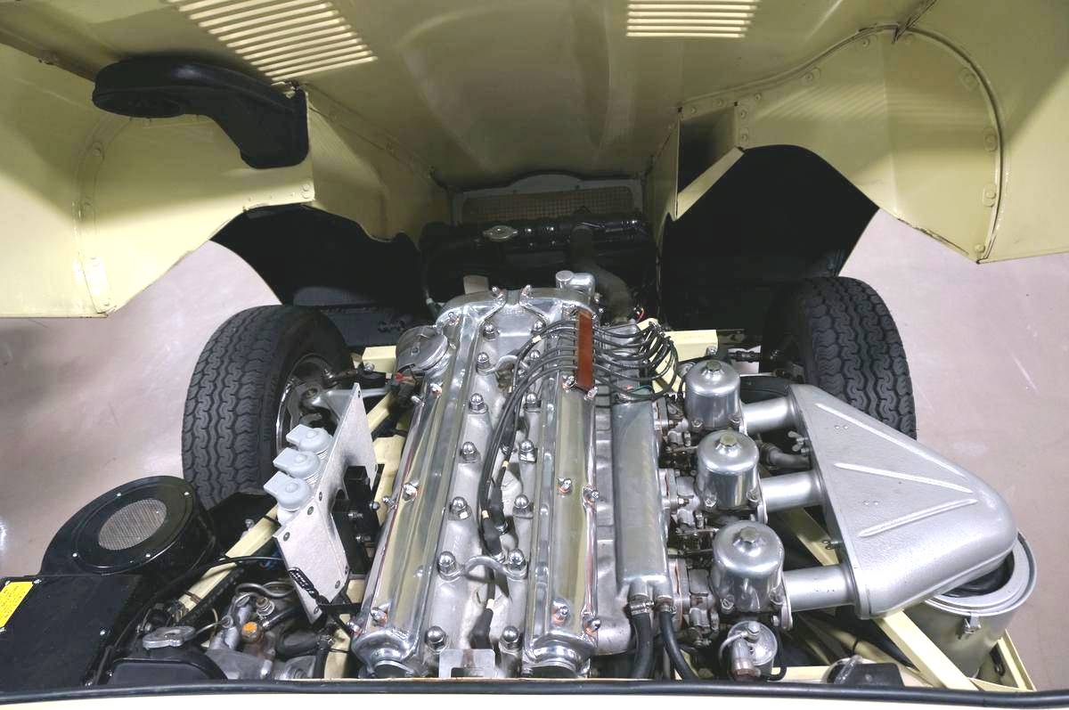

Hi guys I'm the proud owner of a 69 E type Coupe after a 2 year search and several thousands of miles flying. And I found this one 100 miles from where I live.
I'm sure I'll have many questions as I sort the car out but the first one is how to remove the seats. They don't more forward or backward but the seat backs do recline.
This should be fairly basic because I also own 4 MGs and they just bolt in from the top of the rail, but on the E type I can't move the seats to find any bolts. Any advice much appreciated.
