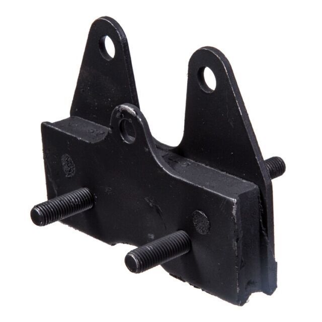

First… buy new tires - whichever you like. We have been using old ‘rollers’ through my restoration project and 3 of the 4 we used exploded while just sitting there. One exploded violently even when the car was on jack stands. Old tires are just not safe.
Second… check the attachment of the steering rack to the front frame. These were attached with a metalastik (rubber) mount that fails eventually. There is a backup safety system but it does let the rack move. Check this thing:

I'll have to blow up a schematic and look at the frame mount Mike mentions.
