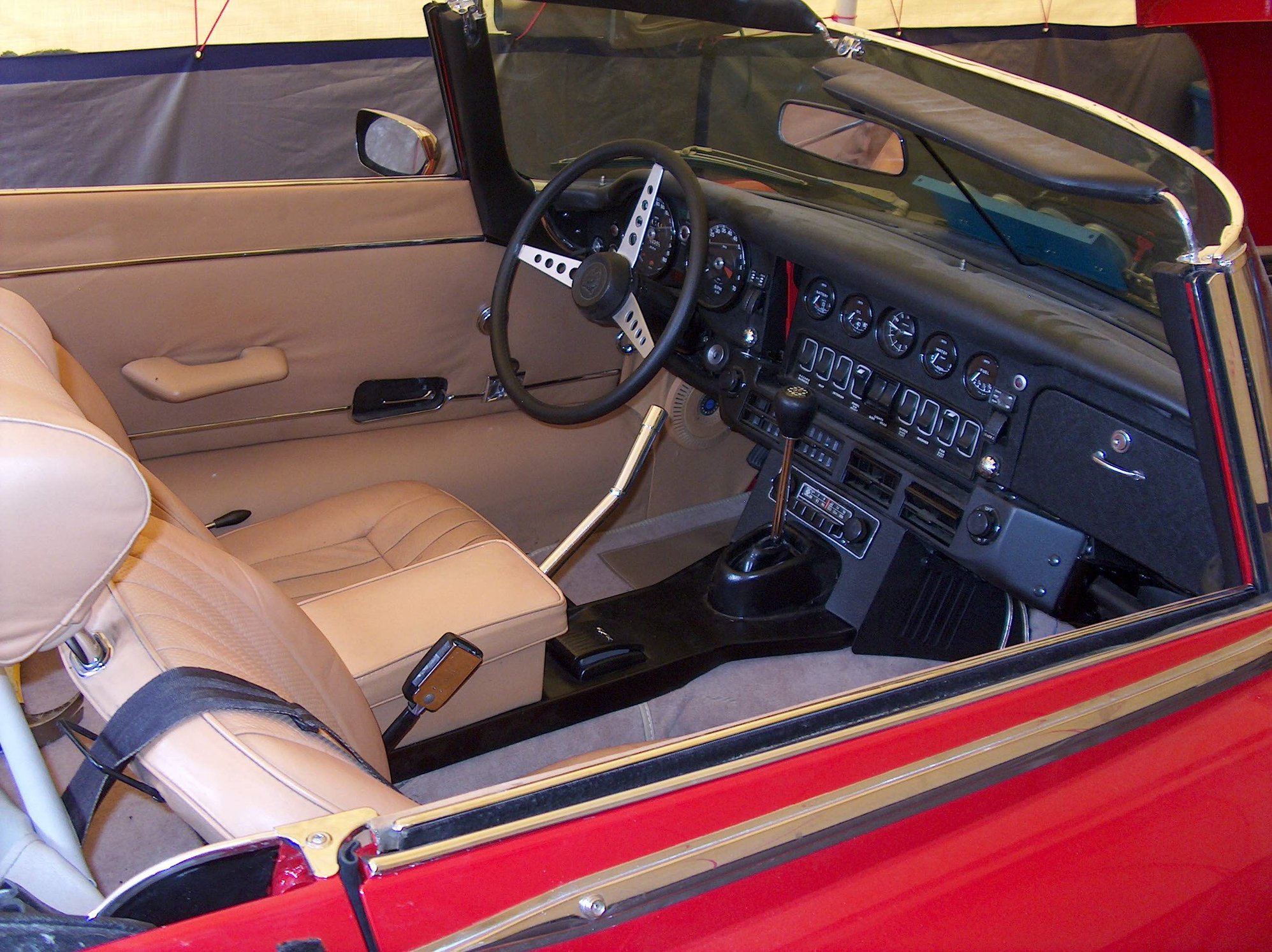

Very nice!!!

Yes Very Nice

Pretty in red, very nice work!
