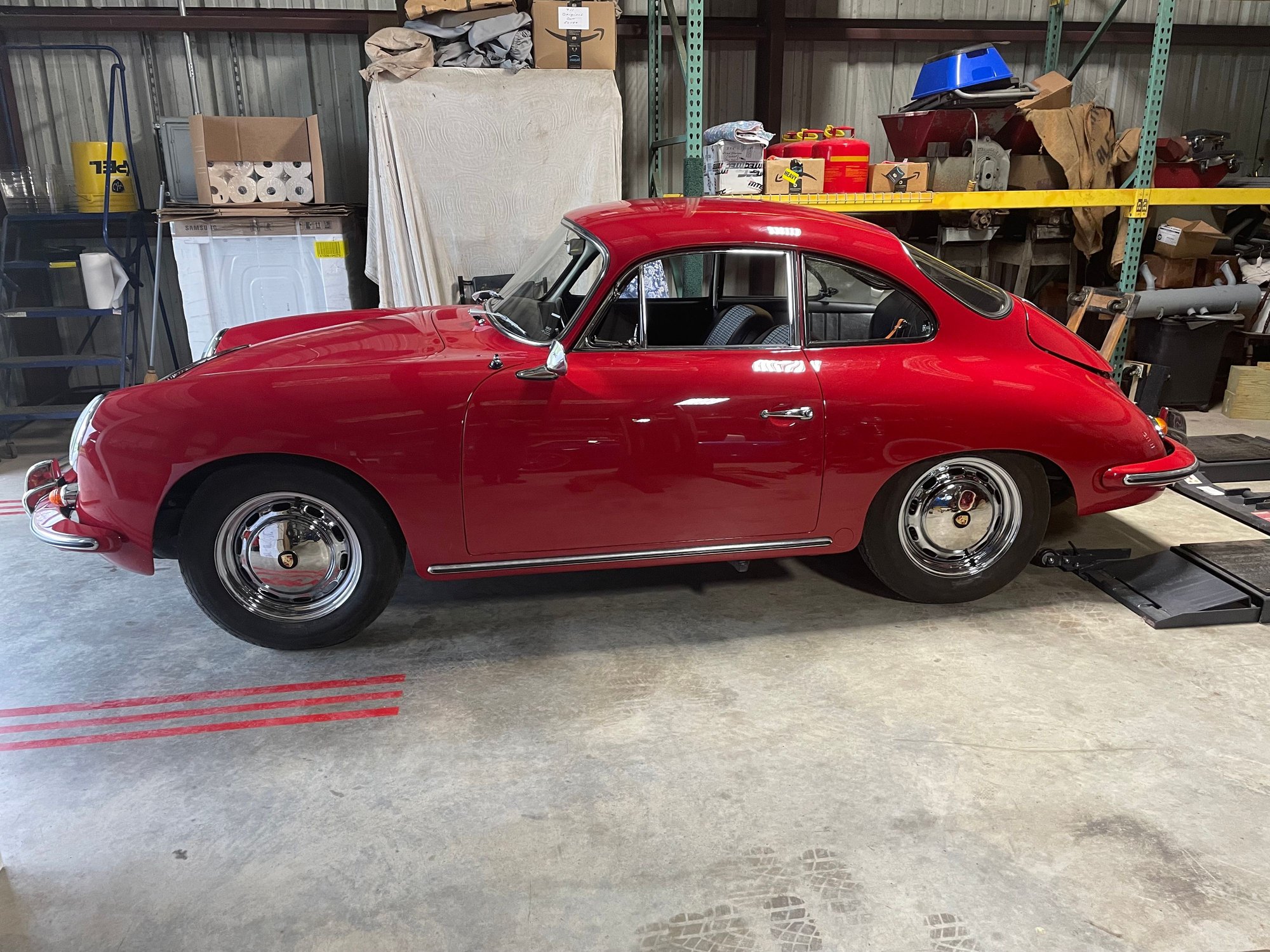

mpawelek's Avatar
Joined: Nov 2025
Posts: 80
Likes: 8
From: Brookshire, Texas
That is the exact antenna I have on my 356SC and it is barely visible when retracted. Easy to get to on the 356 as everything is exposed when one opens the door and peaks in the opening. Not so on the E Type. Cannot see anything when the door is open and the covering on the inside sidewall is glued on somehow. I’ll investigate further when I get the E Type back from the shop after the new brake system is installed. Picture shows the antenna retracted on my 356 just forward of the side mirror.
