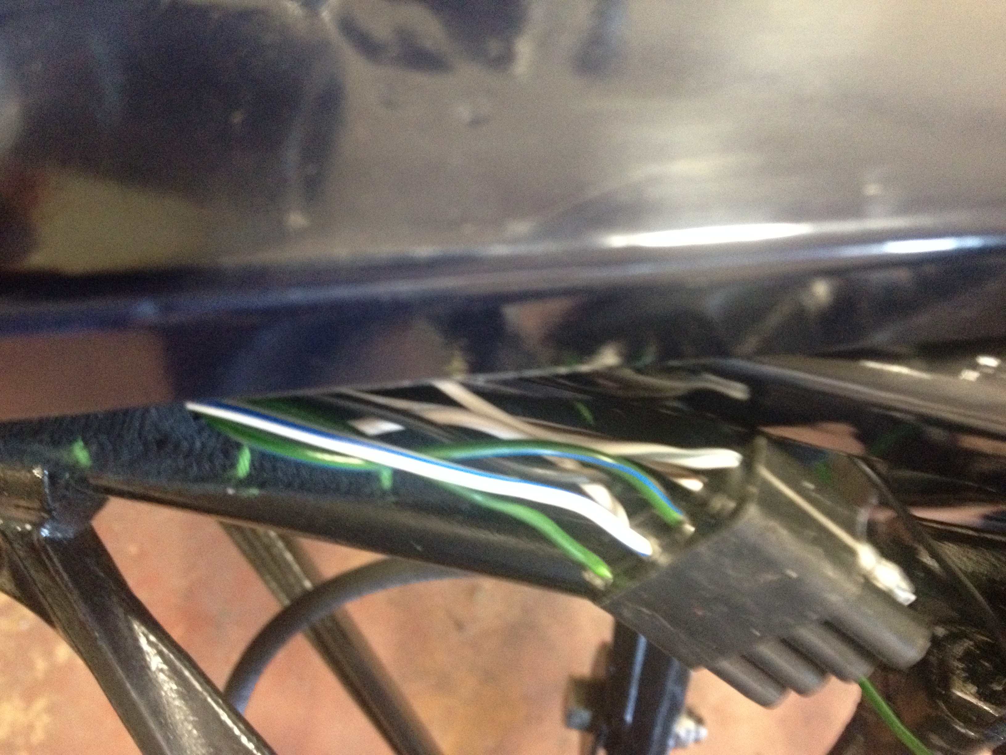

I checked today. The locations of the chassis number are:
1) On the inside of the left w/s frame (A pillar). It is rivited to the pillar. Refer to the attached picture and you can see the Z shaped tab which sticks out.
2) Plate rivited to the firewall to the passenger side of the steering column. You can see it in this same picture.
3) The chassis number is stamped into the firewall itself towards driver side of the steering column.
3) Small plate rivited behind the license plate
4) There are stampings on the front right frame rail extensions. It is very hard to make out before, and even harder to make out now as these extensions have been sandblasted, cleaned, coated, and painted. You can only make out the impressions as the paint did not flow properly in the spray. I tried to get a better picture but the resolution with my i-phone 4 is not the best.
I have cut and pasted what one person said about the frame rail number location:
"The chassis numbers are sometimes difficult to read because they have been painted over, but should be located on the top right end of the Picture Frame about 25 to 30 mm back from the top right hand shock absorber mounting. You may have to scrape the paint off down to bare metal in order to see it clearly.
Pointing out my observations only as to what I have seen, not designed to argue with anyone or even give the illusion that I know E-types.

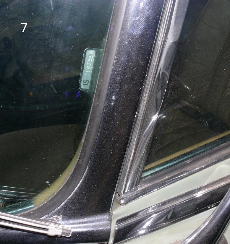

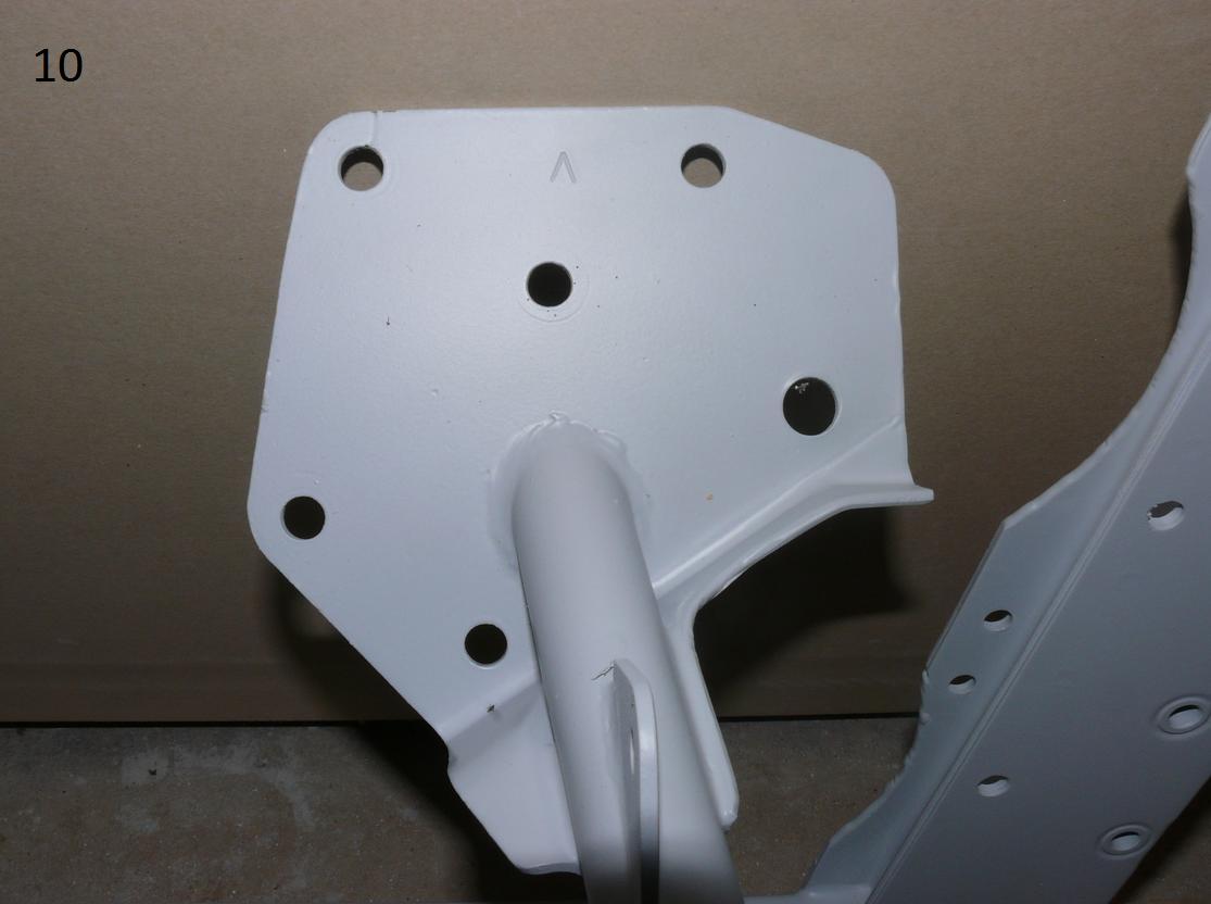

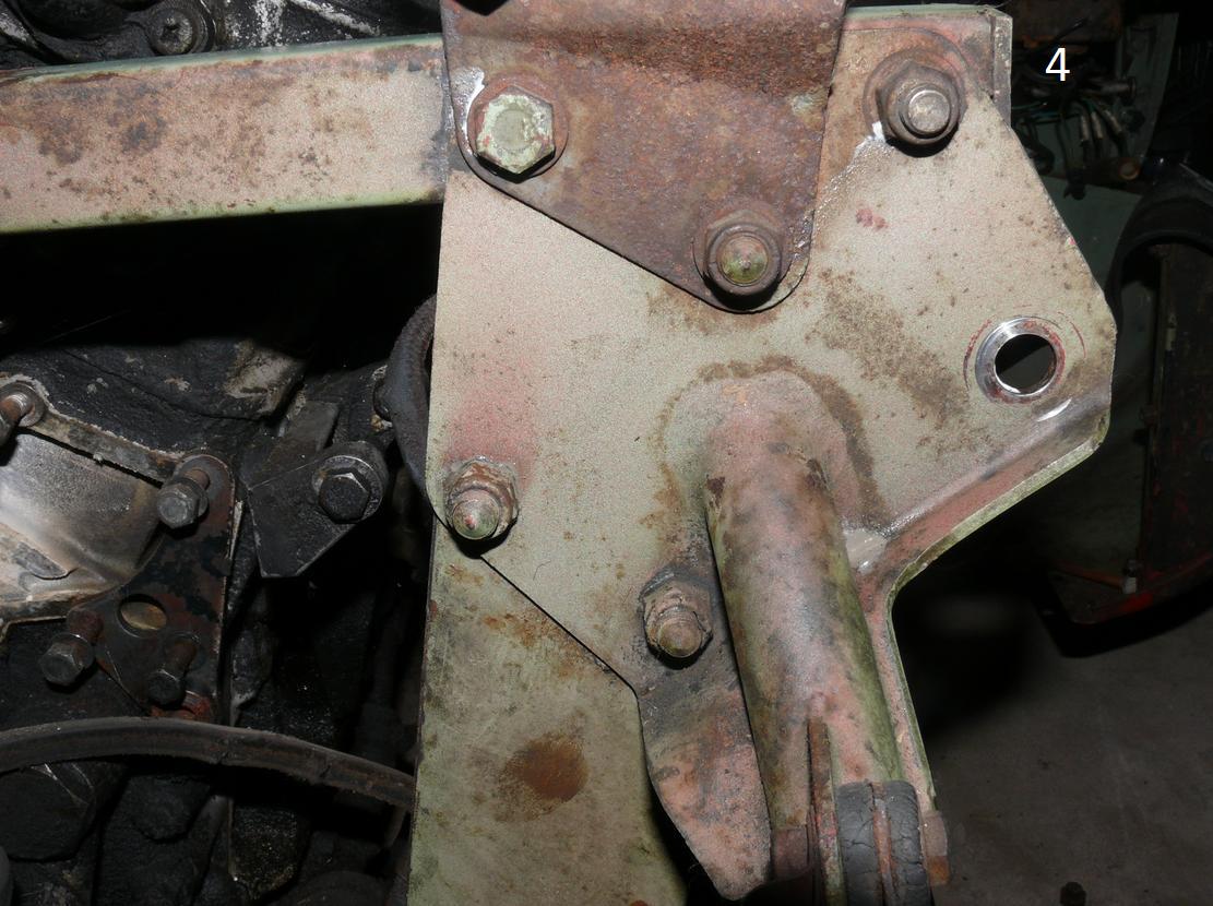

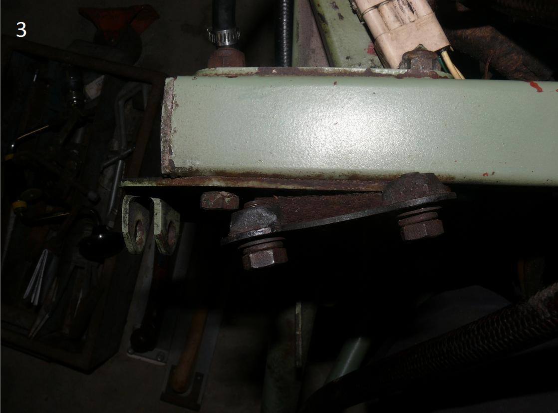

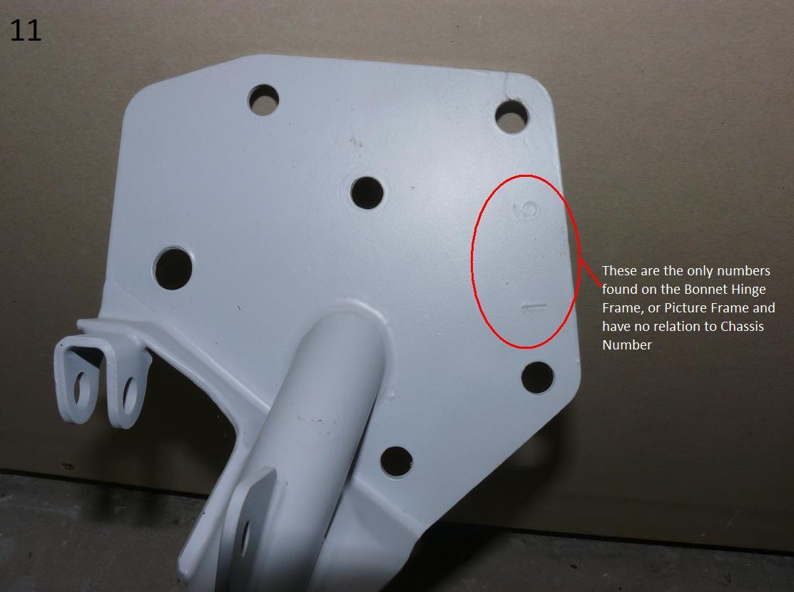

Hello uras,
I know what the Forum should be looking for in your pictures, but I can’t see what you’re referring to.
I'm not engaging in a pissing contest, I'm merely stating how it actually is.
The Plate you refer to riveted behind the Rear License Plate is not the Chassis Number, but the Body Number. The Chassis Number is referred to as the Car Number on the S3 Build Plate. The Body Number is different to the Chassis (Car Number). S1 to S2 cars show Chassis and Body, rather than Car and Body Numbers on the Build Plate and also have a Body Number Plate riveted to the panel that holds the Rear License. Its positioned to the Right of the License Plate.
The Chassis number placement referred to in your Cut and Paste comment is for an S1 to S2 car. This is where the Chassis Number for these cars is found. The Chassis (Car) Number for an S3 was never punched into any of the Picture Frame members.
The only definitive Chassis number for an S3 is punched into the angled surface of the Firewall, Left of the Pedal Box aperture.
The pictures attached labelled 1 to 12, are as following:

  • 3. Top surface of Right Hand end of Picture Frame Top Cross Member.
  • 4. Top Left bracket of Bonnet Hinge Frame.

  • 7. Label riveted to Left Hand Windscreen Pillar containing the Chassis Number. The Chassis Numbers is also referred to as the Car Number.

  • 10. Top Left bracket of recently sandblasted and primed Bonnet Hinge Frame showing no sign of Chassis numbers under the Air Cleaner Bracket that would normally resides there.
  • 11. Top Right bracket of recently sandblasted and primed Bonnet Hinge Frame showing numbers that are concealed by the Air Cleaner Bracket that would normally resides there.

You will note from these pictures that the Chassis (Car) Number is only definitively punched into the angled surface of the Firewall.
Pictures 1 to 7 inclusive are from an entirely original, unmolested car.
Regards,
Brent
