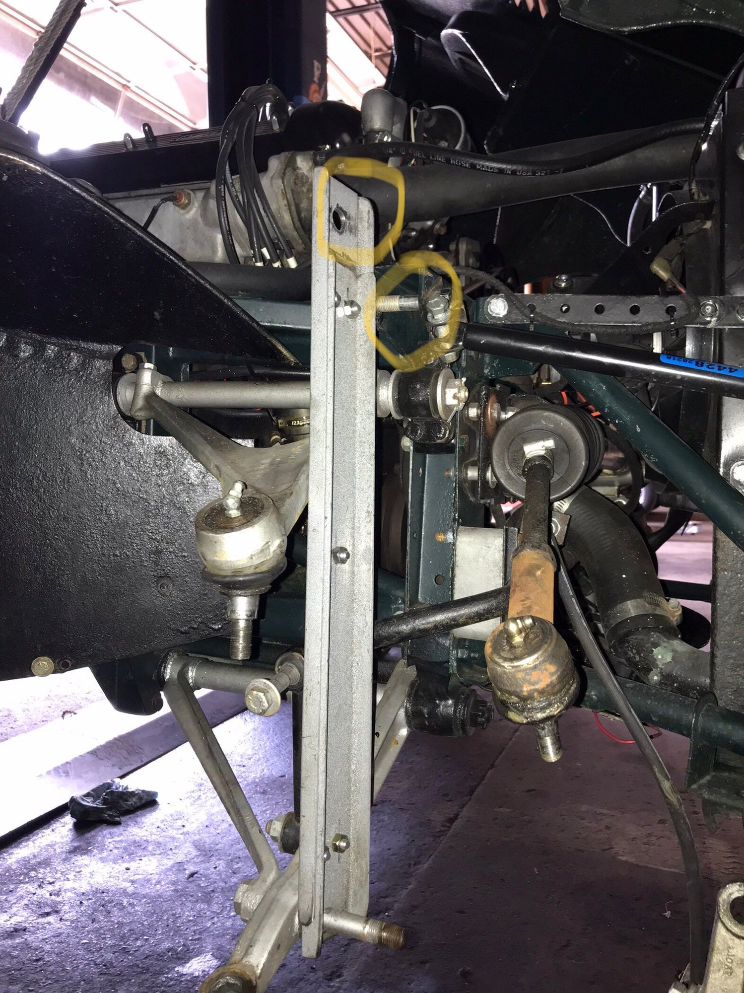

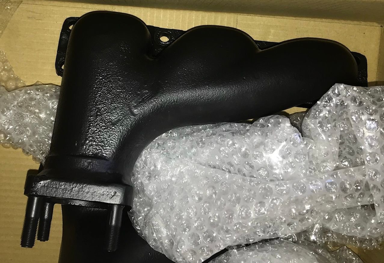

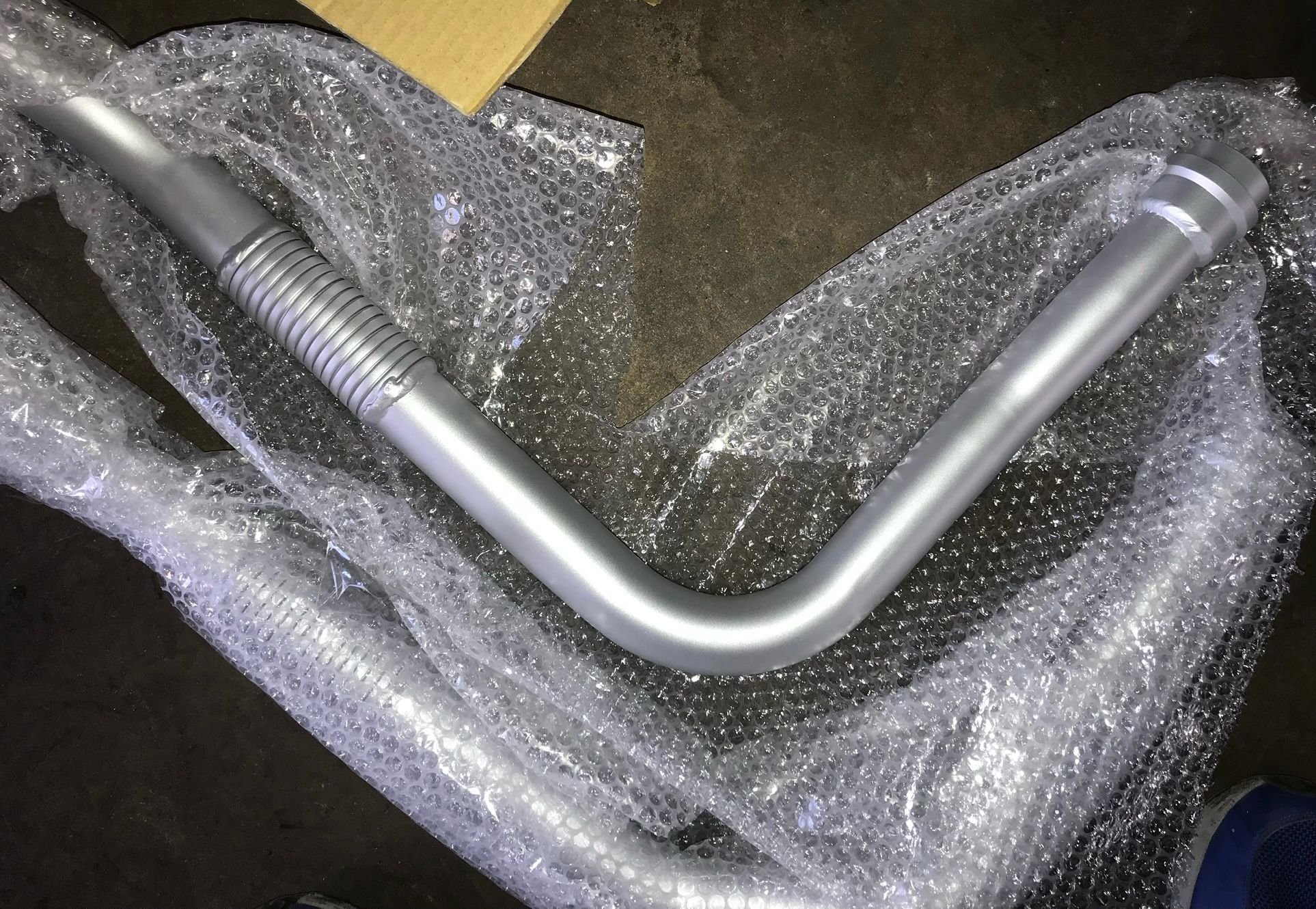

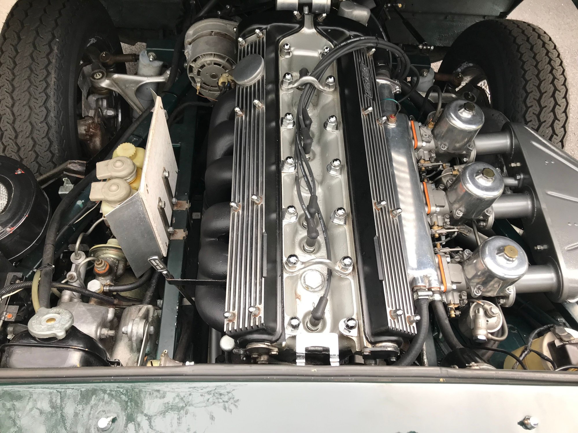

Just an FYI. I had my S2 FHC converted to the Trips SU set up. I went about it by purchasing used parts from a well stocked seller in DE. My local Jag mechanic installed and tuned all of the components. I had the exhaust manifolds ceramic coated in satin black locally. My mechanic was aware that I was always complaining of heat transfer into the cabin and had installed double layered heat shielding in my cabin last year, so he suggested and I purchased two new down-pipes in stainless steel and had those ceramic coated in satin silver. Additional work was to have the front suspension reconfigured since my car was way too low in front - adjusting of the torsion bar on the passenger side brought the front end up 3 inches which was significant and no new parts were required. Finally, I purchased a set of 4 Vredestein radials from Tire Track, which in my opinion have made a world of difference in handling and noise reduction compared to the much pricier Avon‘s.
Shout out to my my mechanic, Ross, nearby in Morrisville, PA at Jaguar Specialists; fair, honest and a mechanical wizard! Also, shout out to the ceramic coaters, Bonehead Performance in Feasterville, PA. Incredible shop, fast turnaround!

triple carb set up

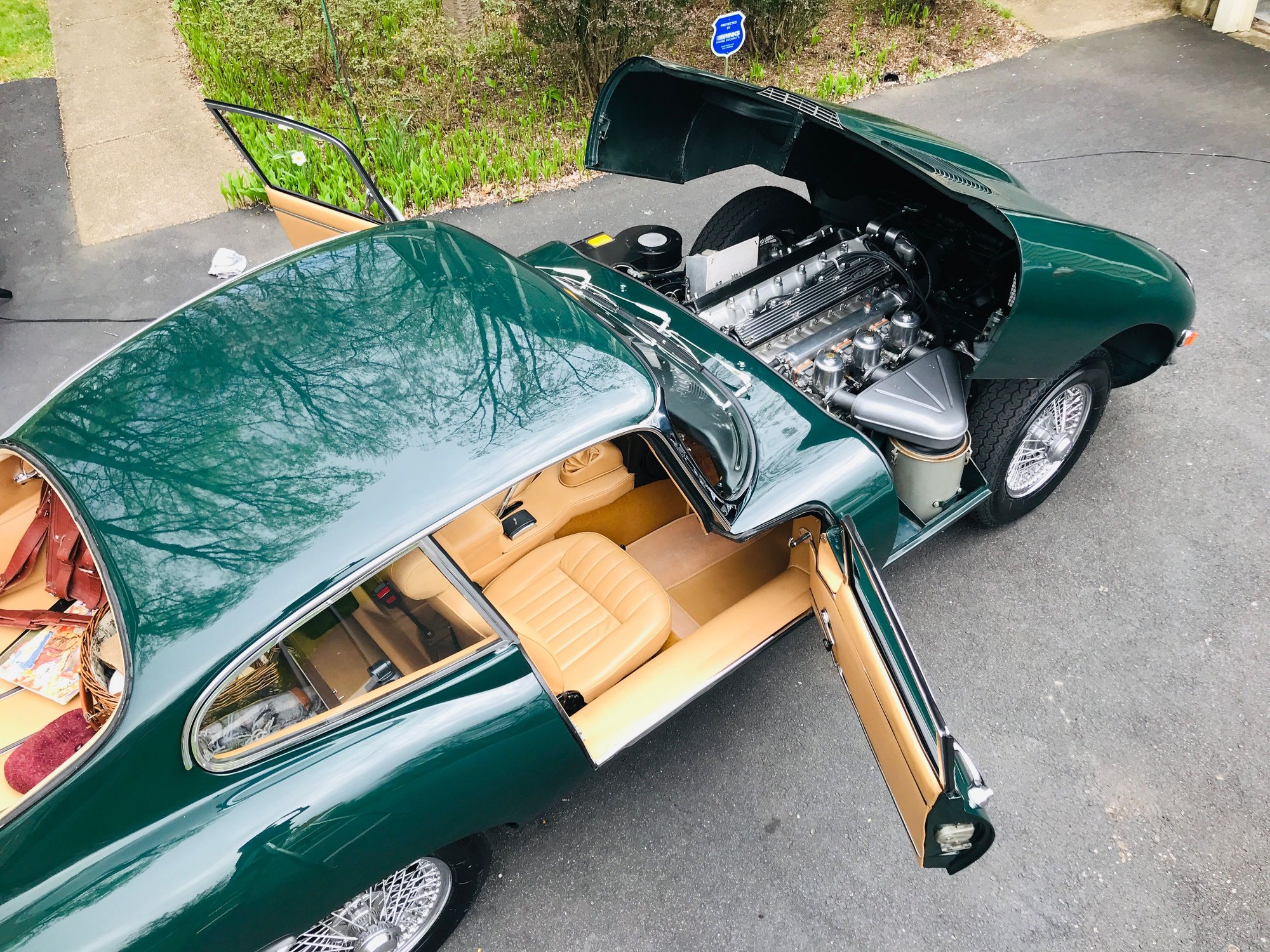

Just to show what my car looks like overall
ceramic coated exhaust manifold
ceramic coated down pipes
How far the suspension was off on the passenger’s side.
