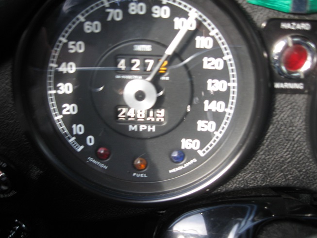

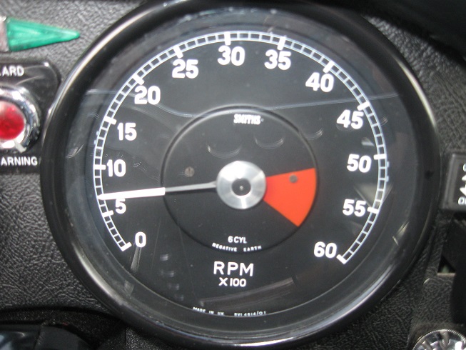

So lovely
Attached Thumbnails Unfreezing the clutch-img_1070.jpg   Unfreezing the clutch-img_1071.jpg
