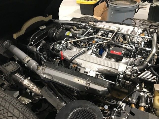

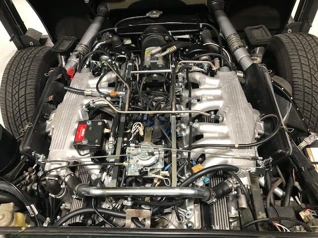

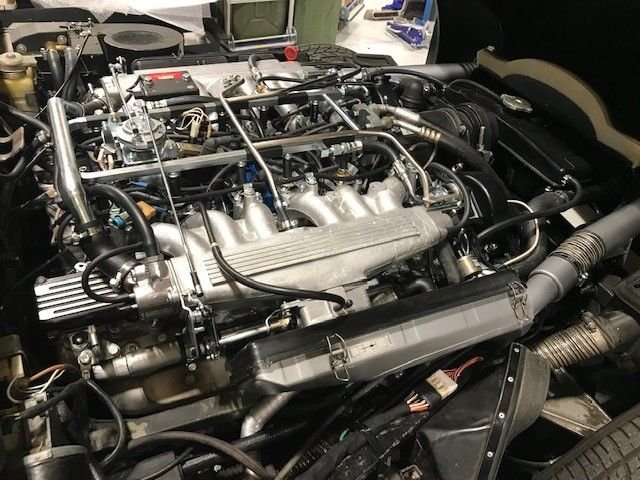

I converted an original 5.3 v12 in my 74 series 3 XKE to EFI system pulled from an '88 XJS. Much of what I had to do was adapt the cooling piping from the original manifolds to the XJS manifolds. It seems that a XJS engine, with EFI already in place could be a good start. Then the radiator connections are the only thing to deal with. The engine is pretty much the same except the sump is different.
The car already has a return line for the fuel (mine did at least) and a swirl can in the tank, only needed to change the fuel pump and restructure the EFI wiring harness. I also fabricated a new aluminum mount to replace the massively heavy original alternator with a newer Delco unit.

nileseh, that looks like a very clean and nicely done conversion. My compliments. In the past I have contemplated doing something similar to my Series 1.5 e-type. Not with a V12, but with a fuel injected engine from an XJ6.
Nice job.
