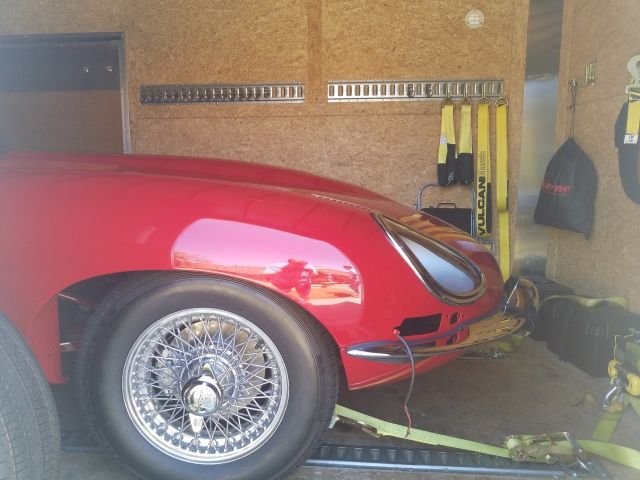

Looking for an experienced contact/shop to replace the tires on my wire wheels on a 69 Jag XKE....in the San Diego area...tubes and current tires are 10+ old
Wheels are off...I believe rims are original, and they cleaned up beautifully...
Also, and thoughts and suggestions on this much appreciated - tape the spokes or rim strips (?) and suggestions on tubes, which are offsets on these wheels...spokes stems not all on the same "level" - so I would guess this is a special fitted rim strip...
