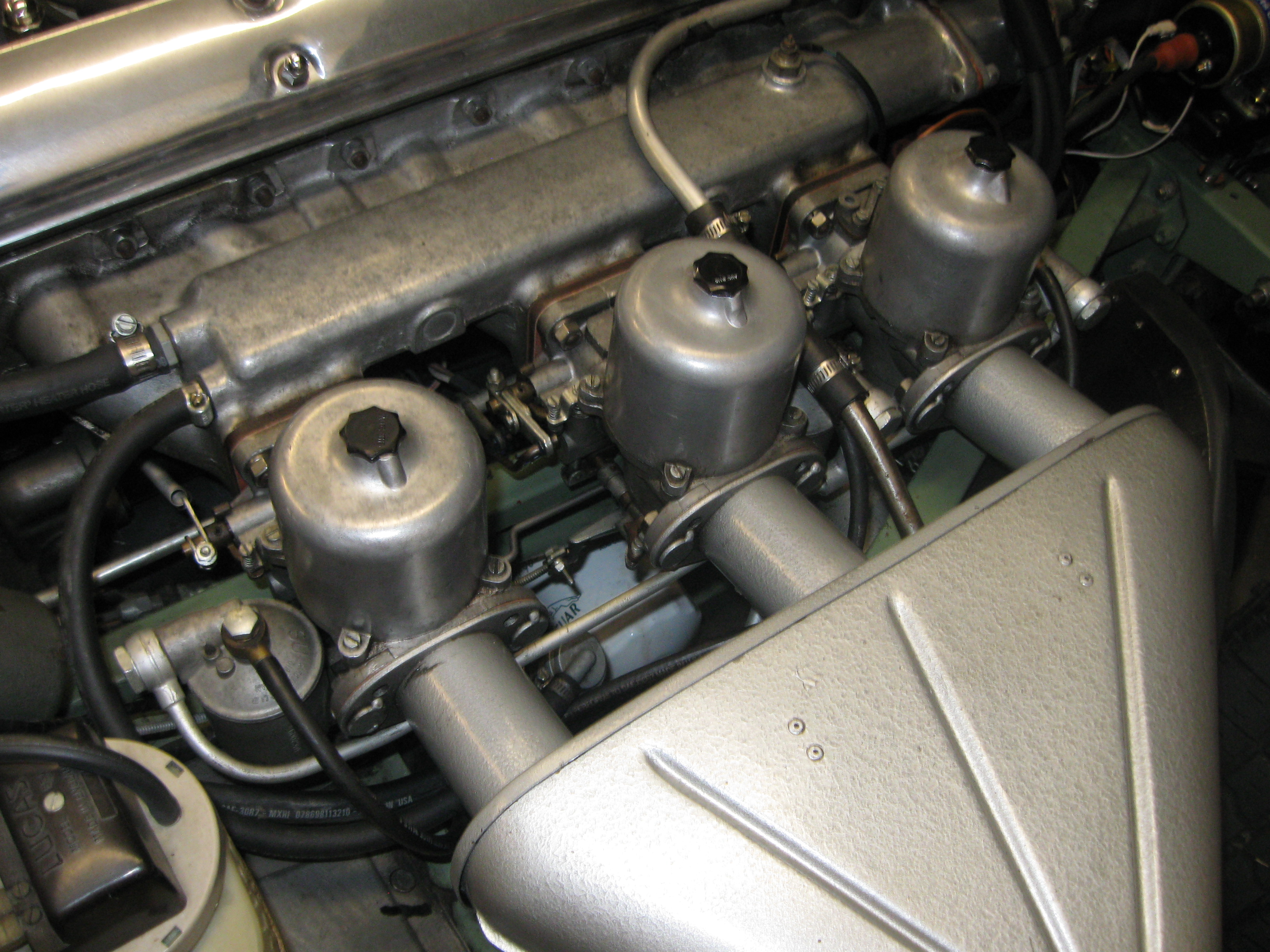

I have 3 SD8 SU carbs on a 4.2 1970 E-Type, I installed a new (point type)
fuel pump from Barrett and noticed that sometimes the needles wood stick in one of the carbs causing that carb to flood over.
All 3 carbs had been carefully rebuilt with new SU kits and parts including new floats and float valves (not Gross valves).
Soooo... I went out and bought a 5 pound max pressure fuel gage and used it to test the output of the fuel pump. It read 4.9 lbs which is to high for normal float valves, so I installed an adjustable fuel pressure regulator, I set this to 3.6 lbs on the gage, which is what the SU instructions said should be the max pressure ! This has cured the problem..............but are all new SU pumps for XKE's putting out to much pressure ???
To answer this question I tested 3 pumps, all the same model, one used two new, all the pumps differed by as much as one pound (but within the advertised parameters) ! This is NO surprise given todays manufacturing techniques, the pumps are sold with a stated high and low limit in pounds per square inch pressure.
So what to do with a car that requires the lowest pressure rating on the pump you are buying ? You would have to test several new pumps (with an accurate gage) to get the one you want. Or disassemble a pump and shorten the spring to reduce the pressure ! The spring is what determines the output pressure of the pump. Conversely stretching the spring could increase the fuel pressure. What ever way you choose, you are going to have to test the output with a gage with the pump installed and connected to the carburettors to get an accurate reading !
I installed an adjustable regulator and a gage so I can always tell my fuel pressure.

Well, it could be, but then, you report only one carb chamber giving trouble, so clearly the other two can handle the pressure.
Does the fault move with the valve ? Move the suspect valve to another carb and see what happens.
Who's SU kits were they ?
Remember if one carb is leaking past the float valve this is reducing the pressure at the other carburattors so they are not likely to leak as well ! The length of the float contact arm and contact bearing as well as the floats being exactly the same volume all effect which carb could be flooding.
The rebuild kits were Burlen SUs
Feline, I have my 1970 etype coupe installed with triple su's for close to 28 years and drive my coupe close to 6,000 miles per year.
The pressure should be between 2 and 4 pounds.
