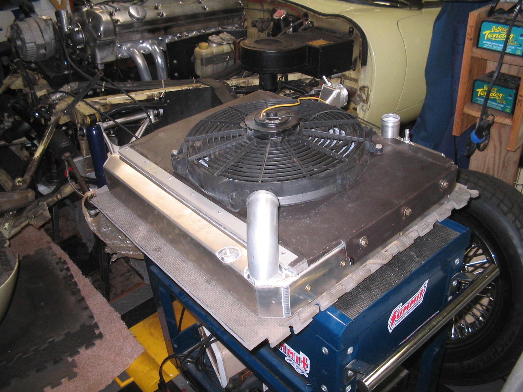

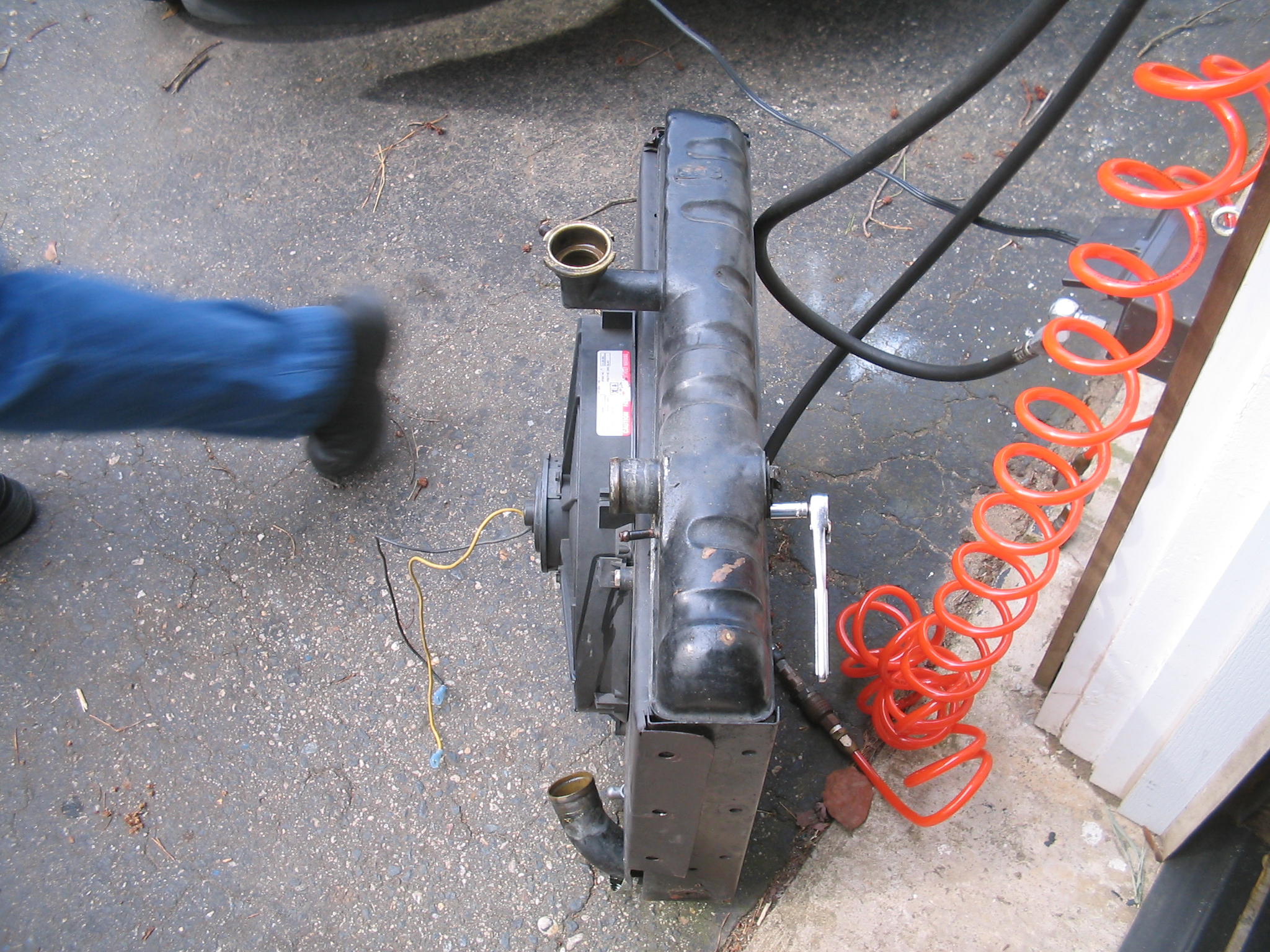

Hi Guys,
I put this together a bunch of years ago. This fan 'n shroud was made for the stock rad, later, I placed it on a Ron Davis aluminum. "Knock on wood", I've never had an over heating problem.
Attached Thumbnails XKE Overheating cure-img_0718.jpg   XKE Overheating cure-img_0719.jpg   XKE Overheating cure-img_0720.jpg   XKE Overheating cure-img_0725.jpg   XKE Overheating cure-img_0726.jpg
Old Apr 7, 2014 | 01:47 PM
downsouth's Avatar
Posts: 41
From: Baton Rouge, LA
Originally Posted by RedRider48
Hi Guys,
Very nice. You had the shroud custom made?
Old Apr 7, 2014 | 02:48 PM
RedRider48's Avatar
Posts: 1,545
Likes: 376
From: Severna Park, MD
It wasn't really difficult with a few metal working tools. I started with a piece of sheet tin and bending pliers from Home Depot. Then had at it!
As you might can tell, I made it first for my OEM rad. The Ron Davis aluminum rad is so closely follows the OEM, that I don't think I had to make any corrections.

I've been running this setup for 10 years, or so. Works like a champ! It's a high quality aluminum (Ron Davis) with my own fan arrangement.
