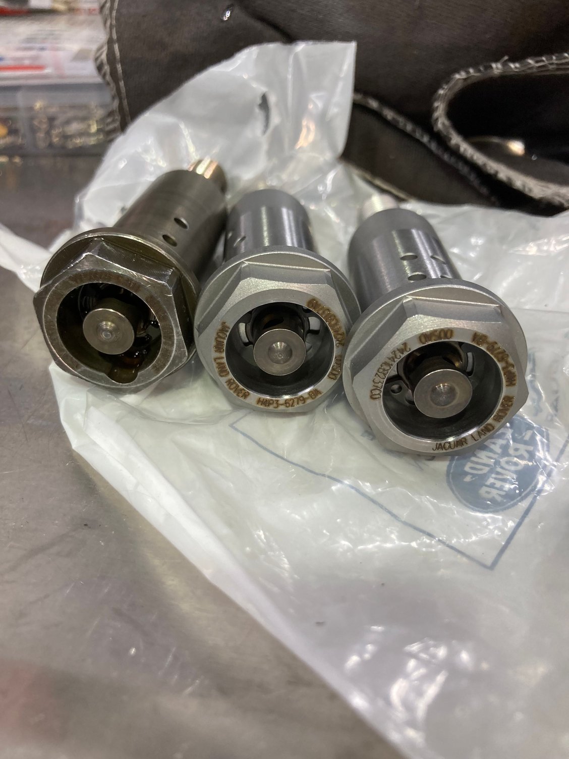

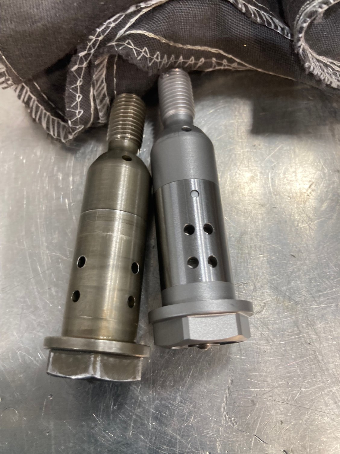

You can see the location of the 4 holes has changed.
There’s a difference in there too.

Is it possible that if one was to replace both the cam gear bolts with only the new bolts would the code clear??? 🤷‍♂️
You still need a very special set of timing tools, torque wrench *and* a specific degree torque wrench also. Keep in mind that all the timing components are at the rear of the engine. I forgot to include that oil passes through these bolts and is controlled by the solenoids mentioned earlier. Replacing these are not for a beginner. I hope this helps somebody.
