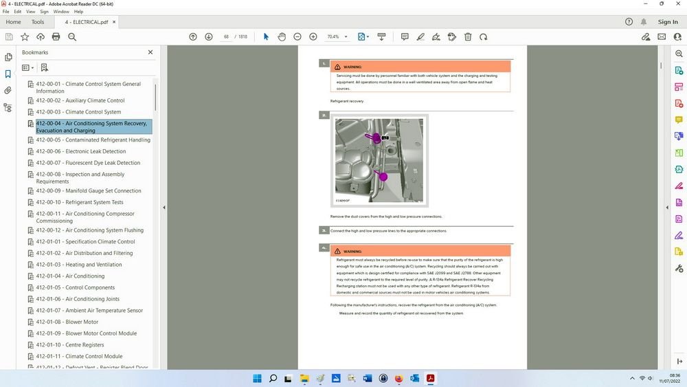

Desperately need to top up my F-pace S 2017 3.0D Aircon...
Can't find the low side port... Anyone know where it is?

Jul 11, 2022 | 02:40 AM
Welcome to the forums TobySP11,
From the F-PACE Workshop Manual:
Enjoy the forums.
