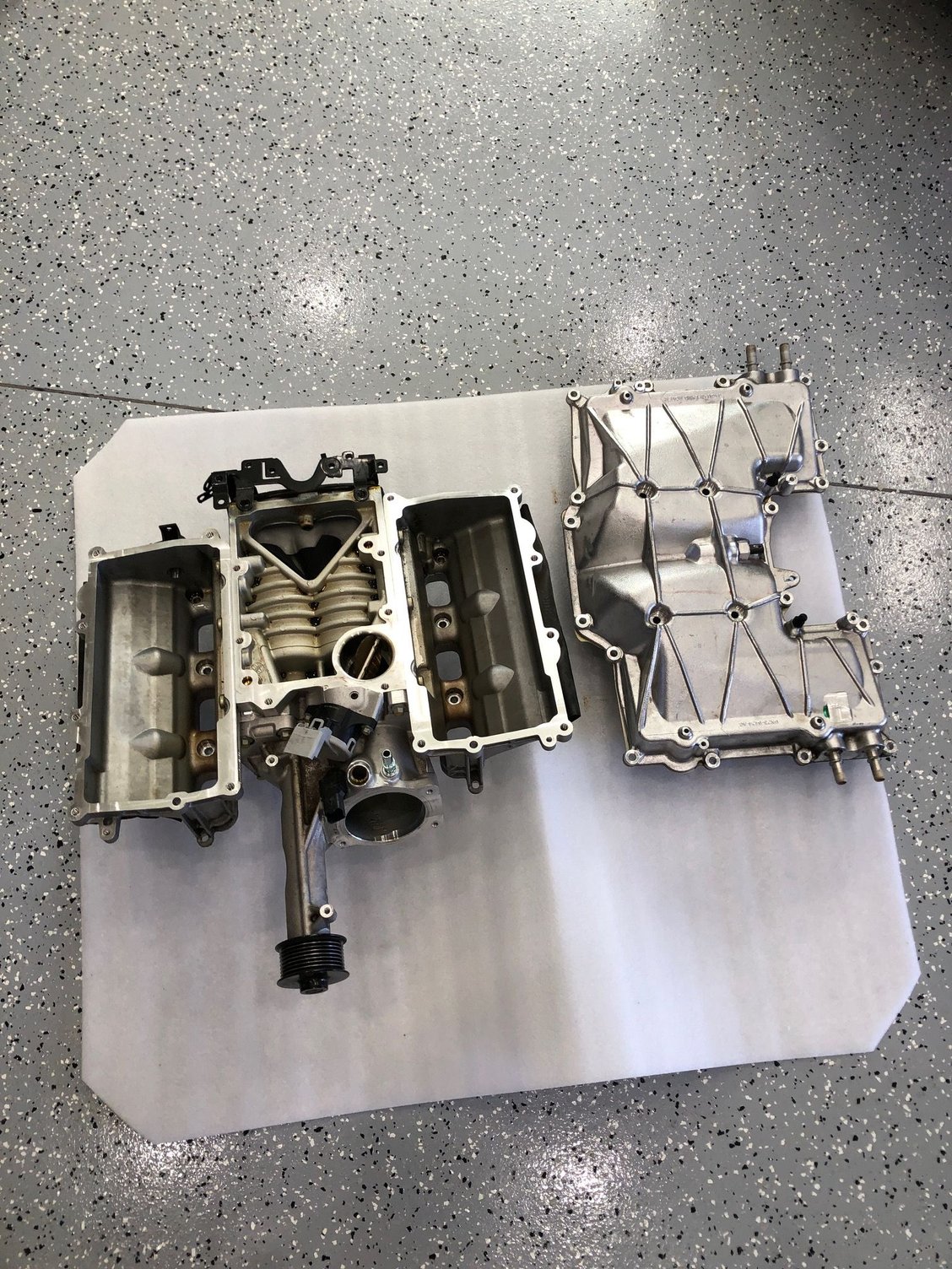

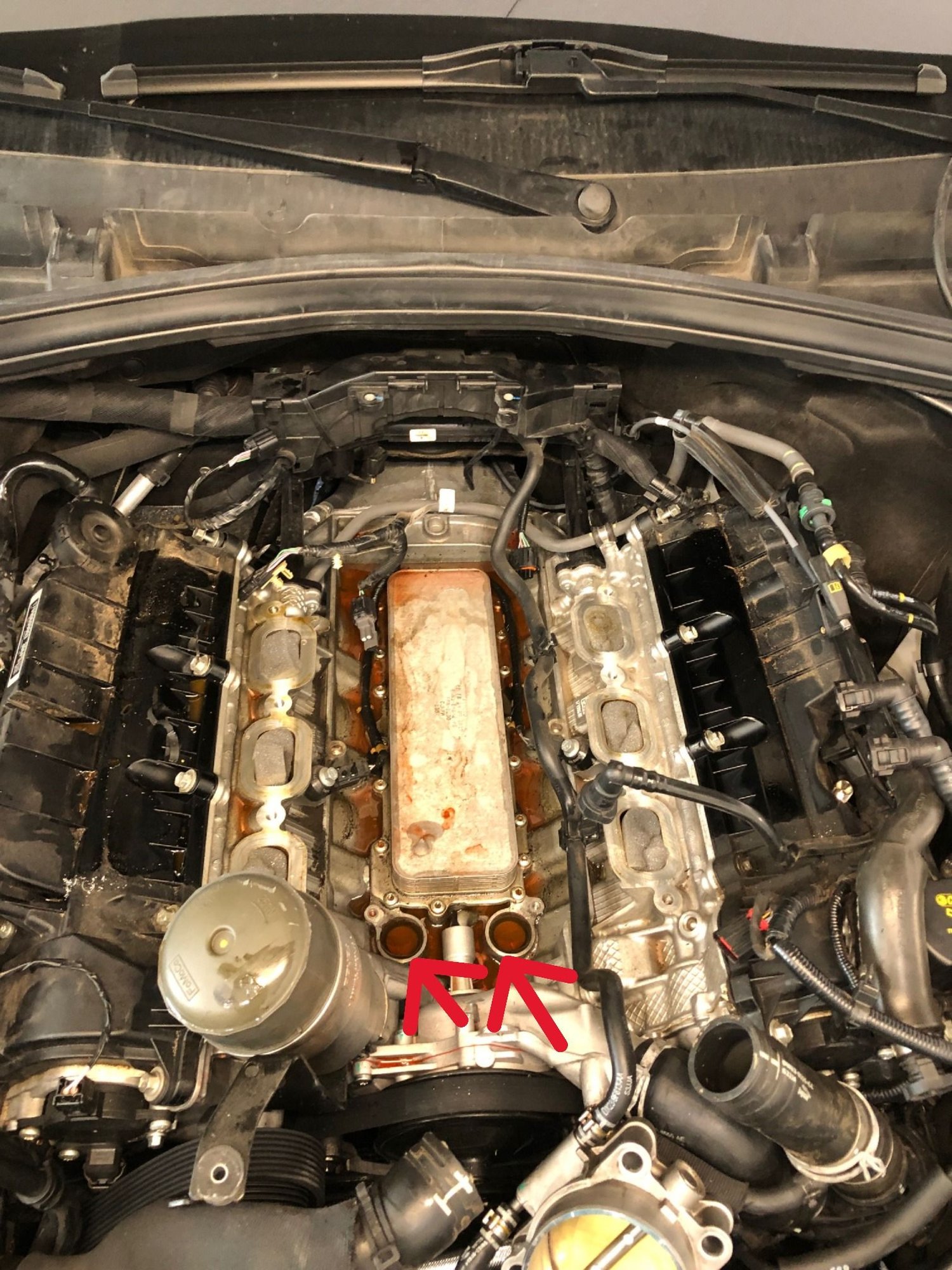

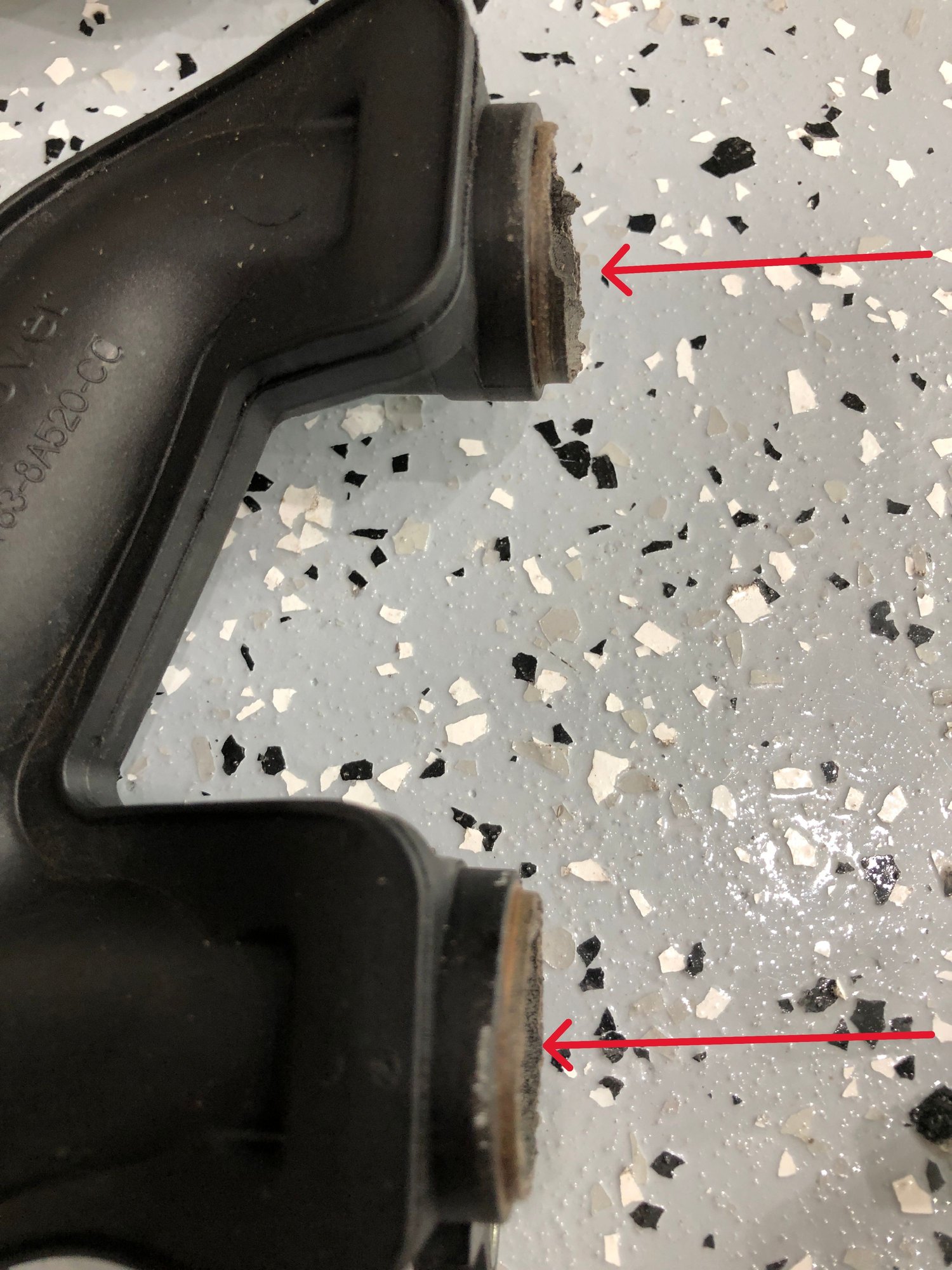

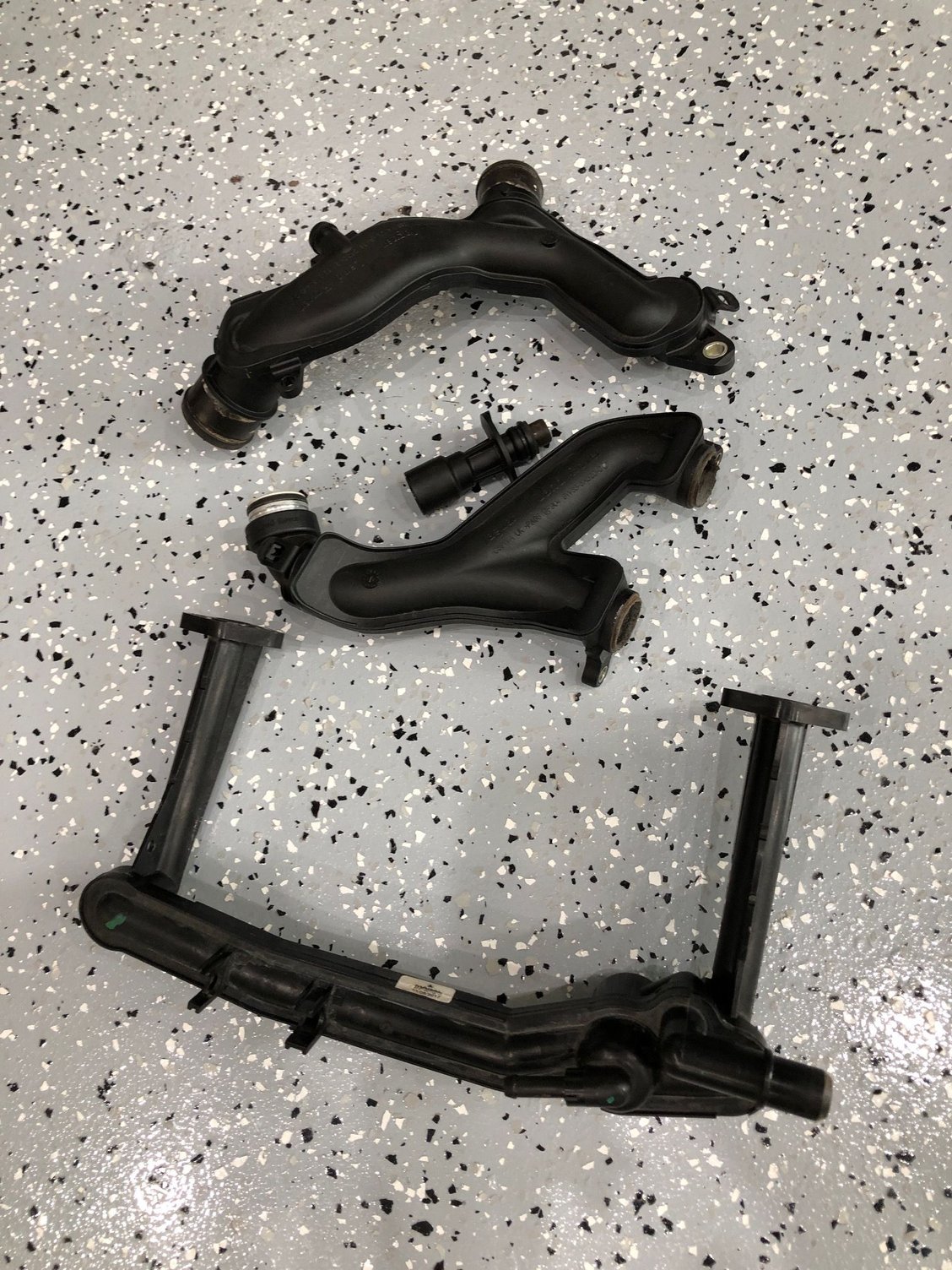

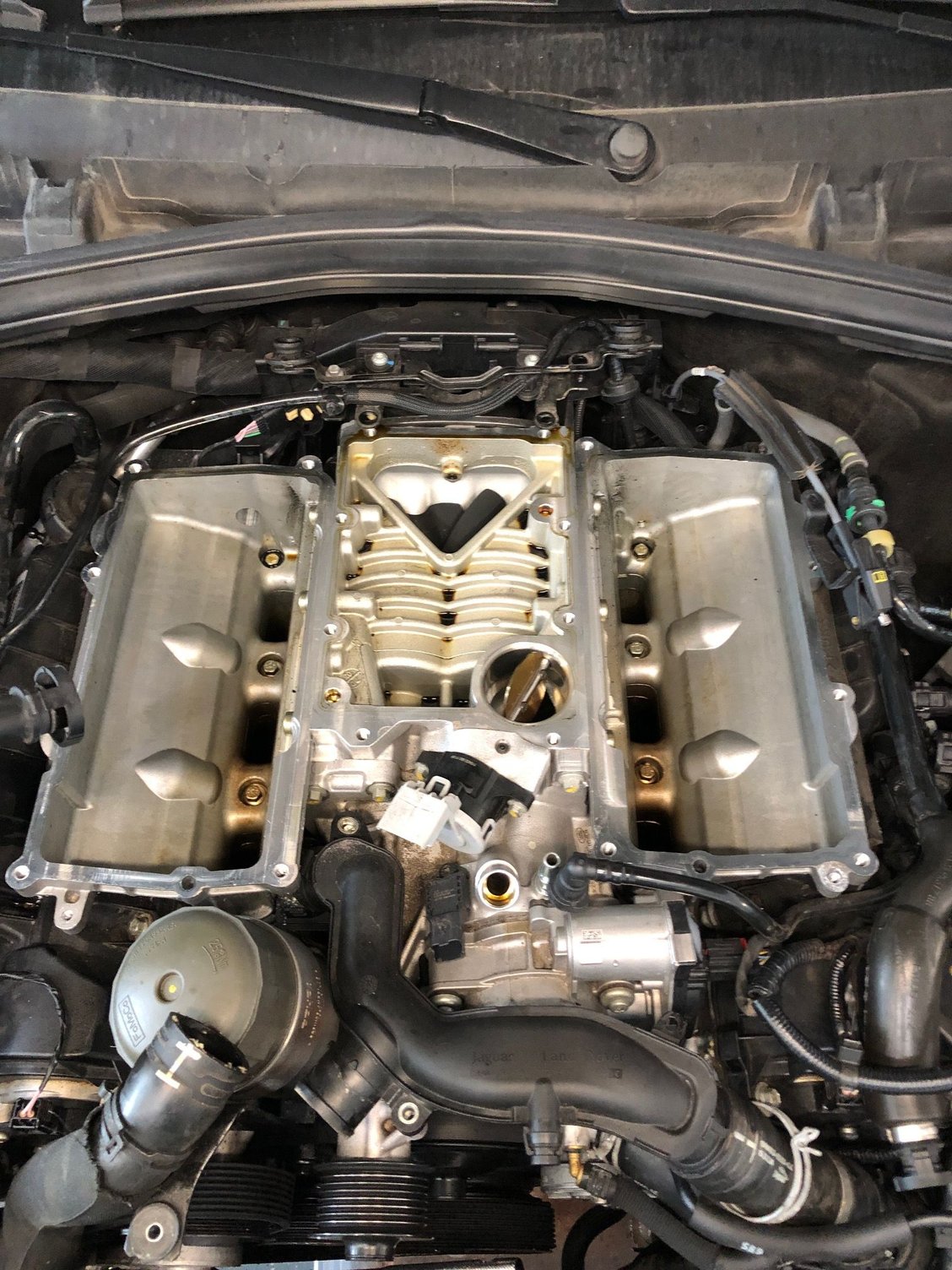

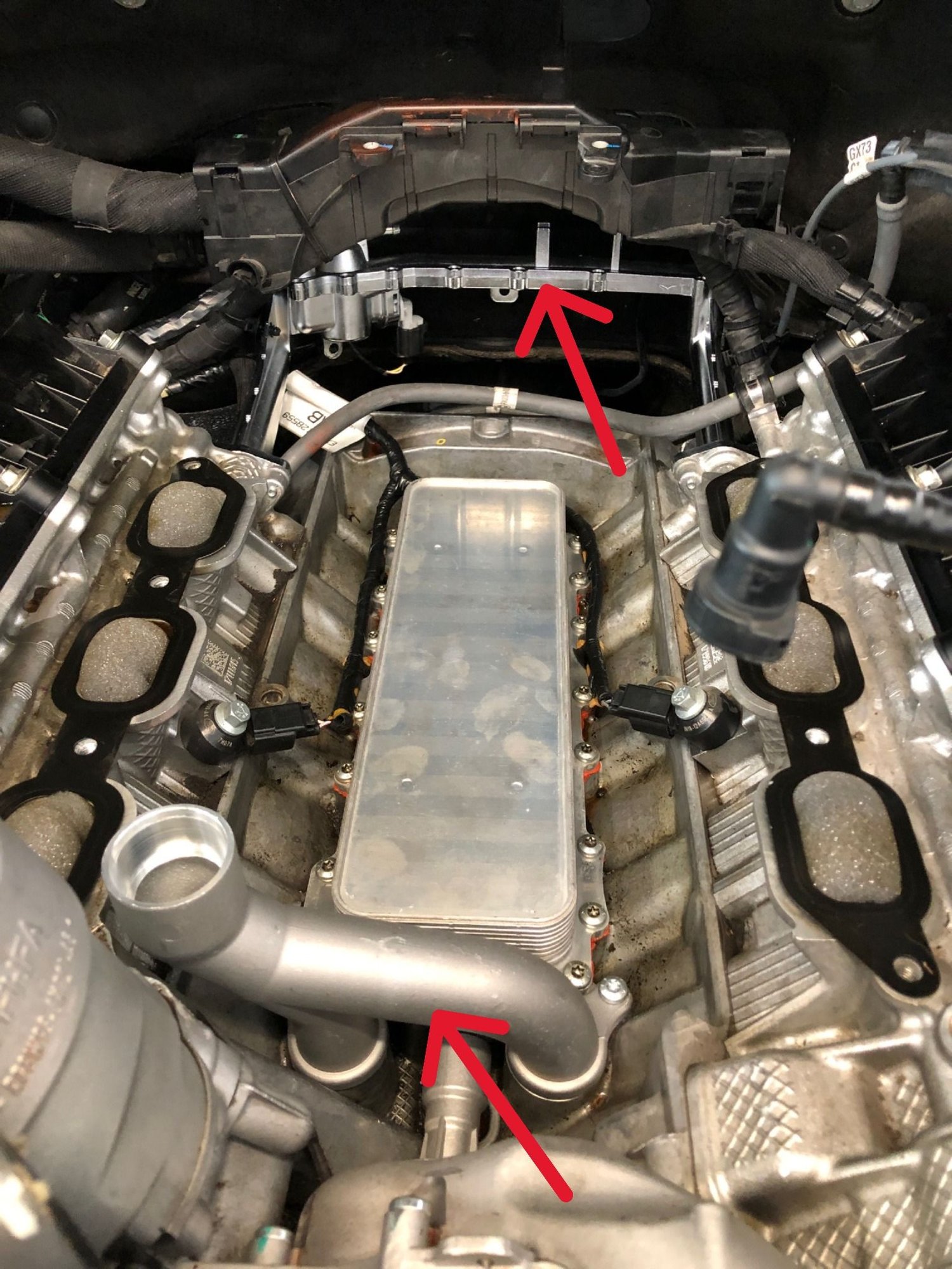

I happened upon this thread and thought I'd add some of my thoughts. I just went through the y-pipe failure on my wife's 2018 F-Pace Prestige (right at 50,000 miles, almost to the fourth zero). Some pics below of the process, but likely no one on this thread is unfamiliar with so I'll save the narratives at each pic. The total repair, and upgrading all of the plastic pipes I could with aluminum, was about $250 including replacement anti-freeze. I also replaced the water pump and the oil intercooler in the center of the valley for that price.
I have not been able to read through every post here on this giant thread that goes back several months, but from some of the frustrations with Jaguar (Jaguar's design) and as a retired mechanical engineer, I wanted add some additional thoughts (and I might have missed similar thoughts, so maybe not new). And, before I start, I will say, this coolant system is one of the worst designs I've seen on any car in 40 years. It's like this design was done as a high school shop project.
For some years now, a couple decades or more, car manufacturers have been under pressure by EPAs to use materials in the car that are more biodegradable, materials that do not plague the Earth for the rest of eternity. Plastics is one very big item that has a notorious past. New plastic formulations, ones that use natural products in the manufacturing process such as soy products have helped this cause, at the expense, of course, of early failed parts. All cars now use plastics in the car, wire coatings one of the most notorious, meant to break down quickly vs. the older formulas. Ask anyone who has lost a complete electric system in a car because rodents find this new soy product a tasty treat. I thought of this especially for those suggesting a class action suit. That would be one technical trial!
