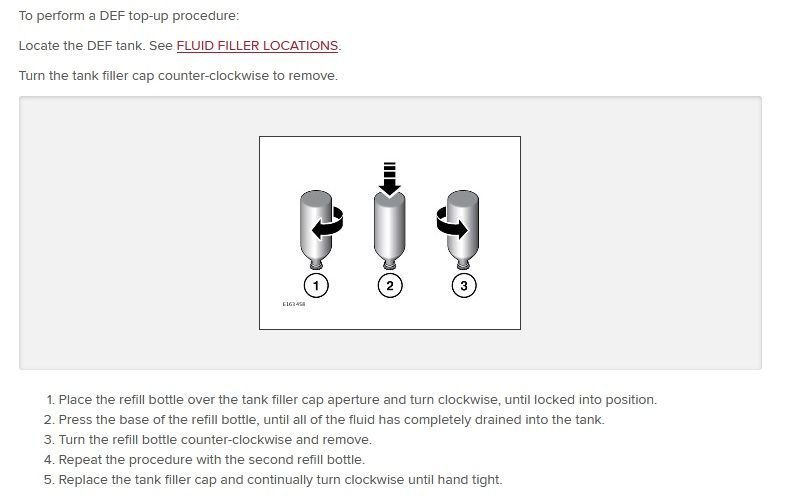

Although I currently have a petrol F-Pace, this replaced a diesel Porsche Cayenne and the DEF top up is a similar process. Retail DEF bottles are 1.9 litres and it will take two to refill from the AMBER warning. You cannot overfill - the refill bottle connector is designed to shut off when the tank is full and close when it is removed. Here's the procedure from the Jaguar handbook:
