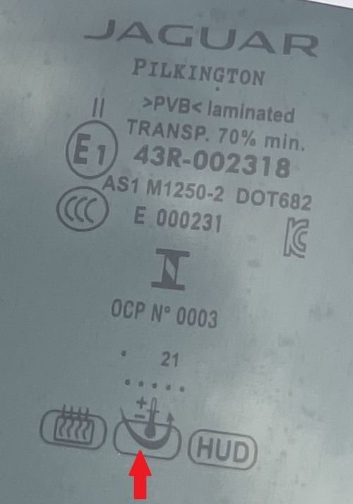

I have the Solar Attenuating Windscreen option on an model year 2021. On the order forms it said “047EB Windscreen infrared reflective” and “047EB Solar Attenuating Windscreen”.
The windscreen has three icons in the corner for Heating, Solar, and HUD.
The Solar icon has a thermometer, and I presume this is for the “Solar Attenuating Windscreen” option.
The Heating icon has four swiggly vertical lines, and presumably this is for the “040AK Windscreen heated” option I also have on order form. The windscreen also has visible small wires for heating de-icing throughout.
The HUD icon is for Heads Up Display, because glass is special to reflect and remove double image from refraction.
I cannot see any colour tint on the glass, certainly nothing noticeable link purple or green tints that I have seen on other cars on the road (non FPACE).

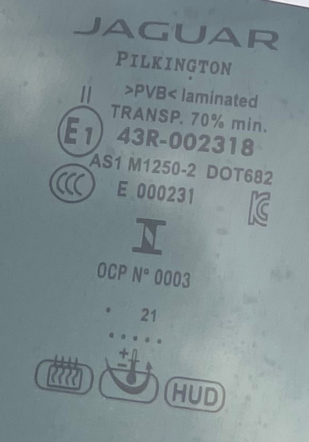

The corner label on my windscreen also said this:
>PVB< laminated
TRANSP. 70% min.
Label from corner of windscreen

The symbol arrowed in red is for Solar Attenuating (a.k.a. Thermal Comfort). The symbol to the left of it is Heated and to the right compatible with HUD.
PVB indicates the interlayer between the two sheets of float glass is Polyvinyl Butyral and 70% min indicates it complies with the permitted minimum of 70% light transmission.
