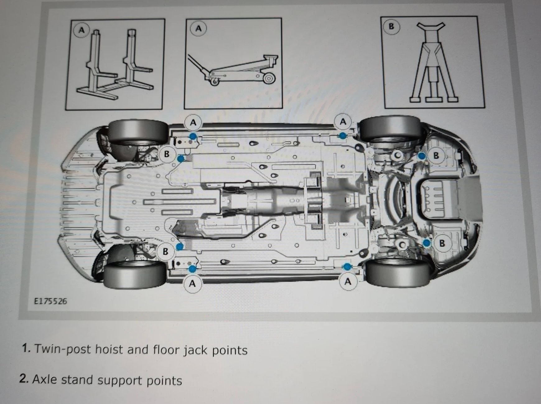

I need to put my girlfriend’s F-Pace on my two-post lift but I’m not 100% sure where the two-post lift points are. I’m not familiar with putting a unibody vehicle on a lift. The diagram I’ve seen looks like the lift points for a lift are on the pinch weld. I have pinch weld adapters for a jack, but I’m not sure those locations are best for lifting the entire vehicle weight on a two-post lift. Is it safe to use these locations for a two-post lift?

Yep, locations indicated are accurate. I use the plastic pucks with the slot molded in. I’m not so sure about the aluminum ones.

Thanks for the confirmation. I’ll get it up on the lift soon.

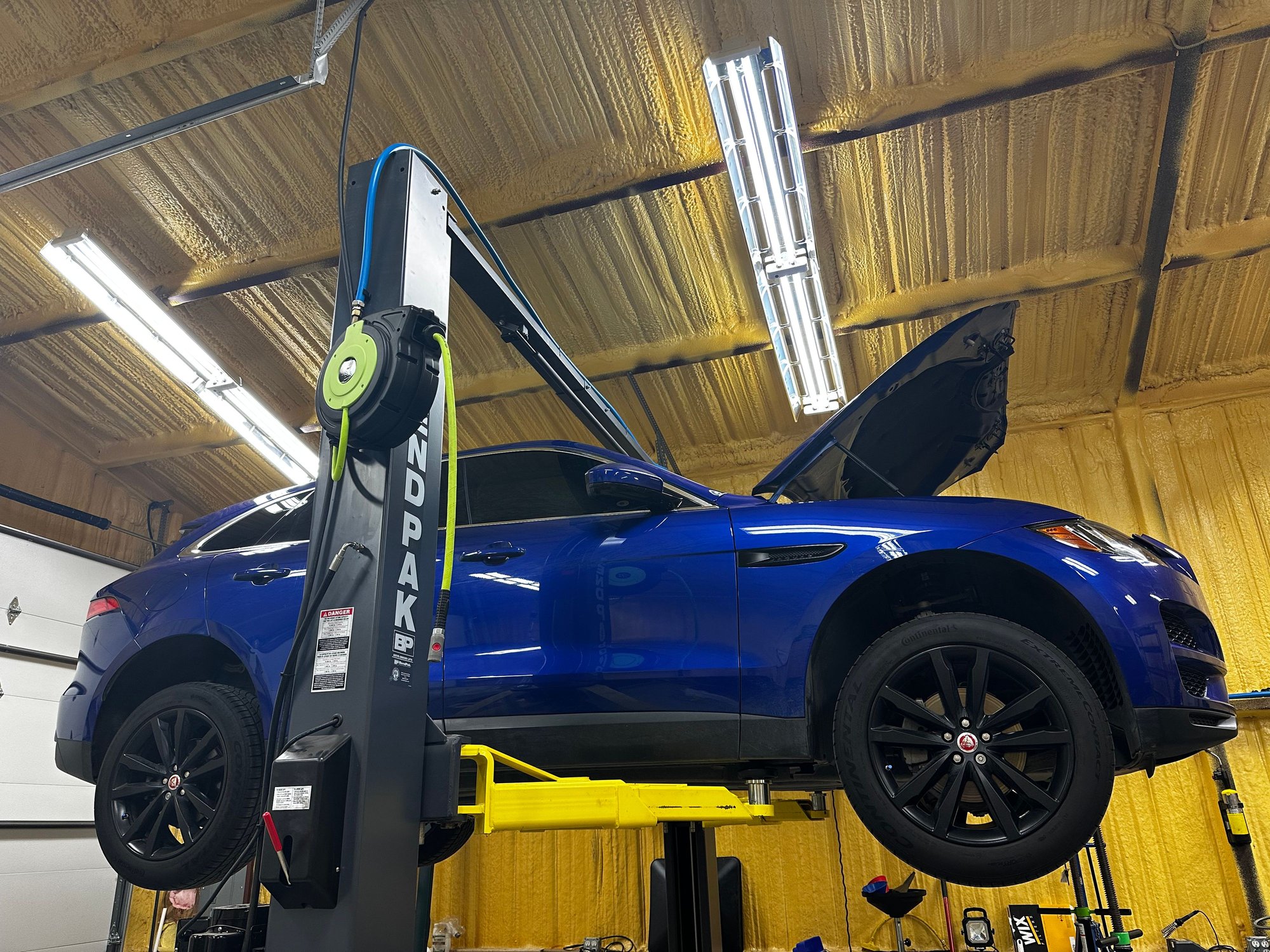

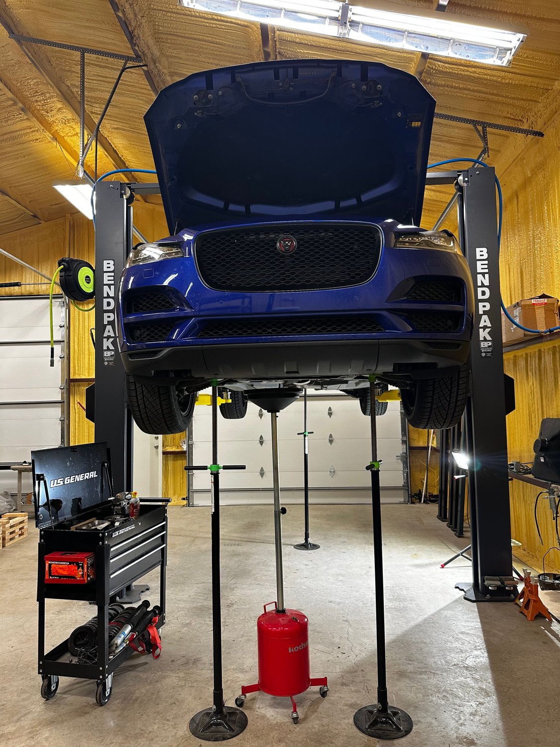

Got the oil and filter changed as well as the cabin air filter. Man, that cabin filter change is fun. I ended up buying some hockey pucks from Amazon and used those for lift spacers. They worked very well.
