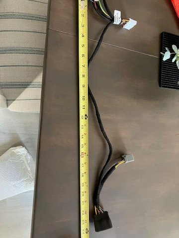

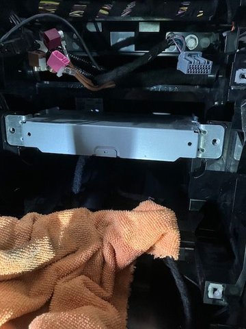

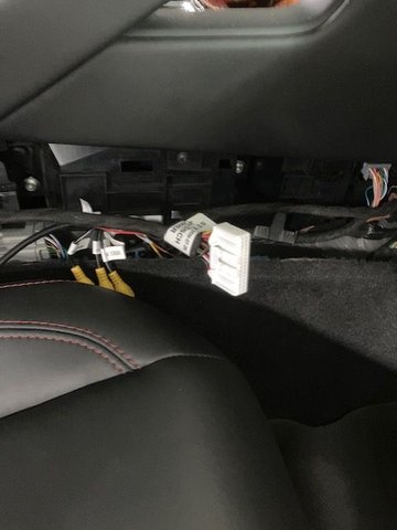

From: London, Ont
Installation assistance please. I have everything apart and no way in the world can i get the cable to reach the rear. A couple of odd things, I have a control box behind the AC controls that I haven't seen in any other videos, pic attached. I wonder do I have different plastics as their is also no hole to feed the cables through where the AC controls go, I have to go in further behind. Lastly the cable is 26inches from the end of the connector that is suppose to plug in the rear control to the end of the connector for their box.

Messaging back and forth with Carlinklife and must say their customer service is good. They are sending me a new cable, I am however contemplating just extending this one myself while the car is apart rather than wait. My existing cable is just too short from what I can tell
do you think the cable is too short since you do not have the opening? Or is it way too short?
