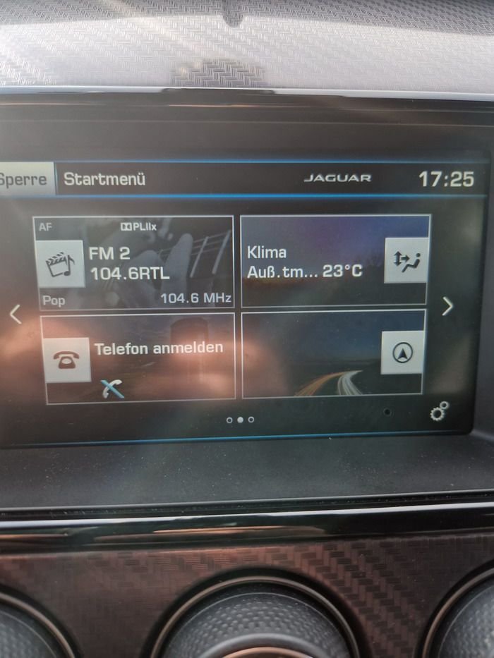

Hello everyone, I've just purchased the carlinklife module.
According to the information I've found here, installation took about an hour. Unfortunately, the cable is very short, and I can't properly position the module.
I'll probably have to order a new one.
But now to my problem.
My module has the two antennas and the aux connector.
I just can't get a picture. I've tried all the switch settings without success :-(
Do you have any other tips for me? It looks like this on the home screen, but when I click on it, I get a black screen.
Best regards, Frank

Do you see the unit WIFI on your phone, I think it was named Kbrand or something like that? It took me a little bit to get it to connect.
Also I did find them very helpful., when I reached out to them, so make sure to give them a try.
My first unit came with the cable that was way too short and it turned out to be the incorrect version of the unit. The second unit cable was correct and all the features worked.

Land Rover_bf1e is displayed under Bluetooth.
I hadn't checked Wi-Fi yet.

Hello, The Wi-Fi here is called Carplay_bf1e.
But there's no connection because a password is required.
Does a Wi-Fi connection have to be established?
I've never read anything about this here?

I believe it does need to connect, as I understand it Carplay uses the wifi connection. That sounds like the problem I had, sadly I can't remember the solution. I will see if I can find my original installation sheet.

Yes carplay requires Bluetooth and Wi-Fi connection.
