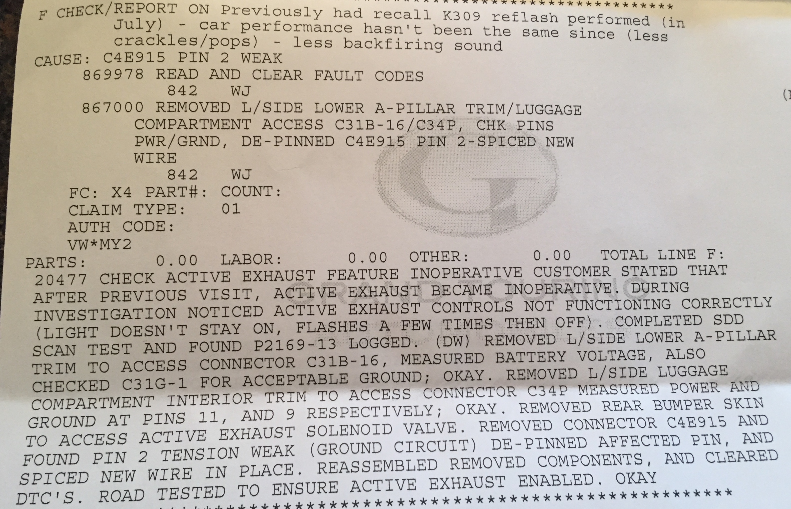

It sounds like your symptoms were the same as what I experienced on my 2016 Base MT. Check out the remedy attached. I had originally thought the problem related to a reflash upgrade, but in the notes you'll see they found "Active exhaust not functioning properly — light doesn’t stay on, flashes a few times then off"
Thanks! This sounds exactly like the problem I am experiencing. Unfortunately the dealer doesn't have the time to check it out straight away, so made an appoinment for the 22nd of Feb.
Do you think it would be worth sharing this picture with them, or just wait to see whatever they come up with?

Never hurts to share another dealer's troubleshooting especially when it finds what that tech did.
+1. In this case, if the bad pin is a recurring problem at that connection, it will save them from tearing the whole car apart if they look at that connection first.

Thanks for your input above. I had the Jag at the dealership and apparently a connection came undone that would activate the switchable exhaust valves.
So apparently it looks like it might be a pretty common issue, but easy to fix if you know where to look for.
