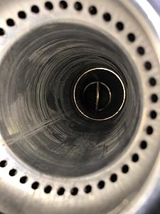

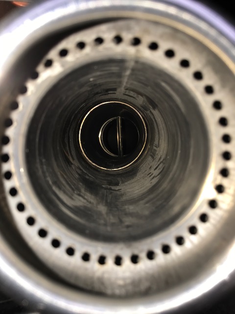

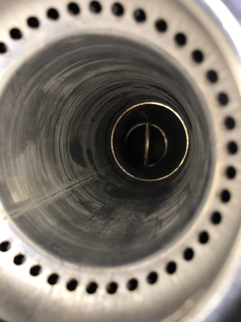

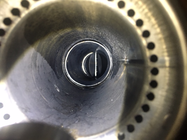

Is this a load of BS...

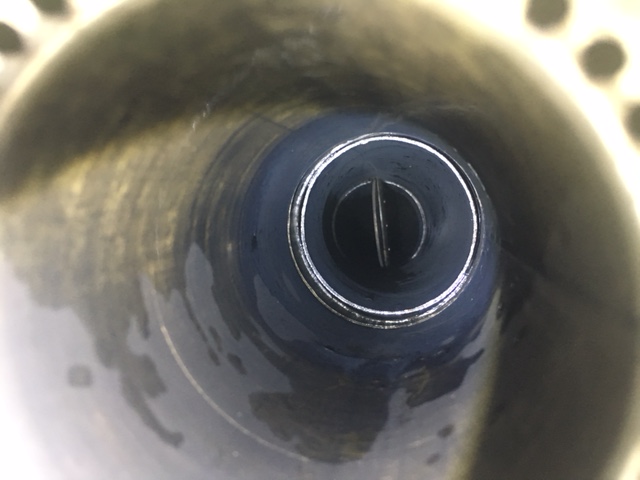

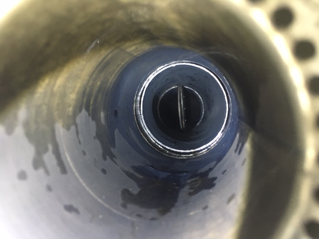

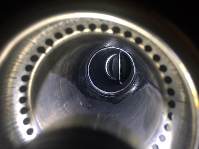

I previously owned a '16 F-Type Coupe R and just picked up a '17 Coupe R. I noticed that my '17 sounded a bit tamer compared to my '16. I searched and read about the K309 software update (O2 sensor) and then folks complaining about their R's exhaust noise being reduced. And then the JTB495 patch came out and that seemed to resolve the issue. My build was 11/16, so I imagine I have the latest software??? I also read about exhaust valves getting stuck, not opening or closing completely. So that's when I decided to check out my exhaust valves. And sure enough, my passenger side valve was not opening completely--not parallel to the exhaust pipe--when Dynamic Mode was engaged. Mine closed completely if in Normal Mode. Others have had similar issues and their exhausts were replaced under warranty. Once replaced, their exhaust valves opened completely.
So this is the email I receive this afternoon from my dealer explaining that I was not imagining things and that Jaguar reprogrammed the valves on MY 2017s b/c people were complaining--seriously?!?! The noise was in part a reason why I came back to the F-Type Coupe R after my '16!
So is the following a line of BS:
I heard back from the Jaguar engineers today. You were 100% correct when you stated that your 2016 was louder than your 2017, unfortunately it was done on purpose. So the engineer stated that starting in 2017, they tuned down the exhaust due to the majority of people stated that the vehicle was too loud. So Jaguar created a ECM software update that only allowed the one valve to move fully open and the other to only open partially to turn down the noise level. So the people on the forums who are getting their mufflers replaced will actually have the same issue because they already have updated their software. If you would have never looked down the tailpipe then I would have probably never have known this as well, so thank you. Let me know if you have any more questions or concerns. Have a great day.
I question my dealer (well really do I have to explain myself there!!!), b/c others here who have had their exhaust replaced confirmed for me that once replaced, their valves opened/closed as intended:
Originally Posted by zmoothg
Everything open and closed fully and properly, no more issues with the valves locking up. It was a defect.

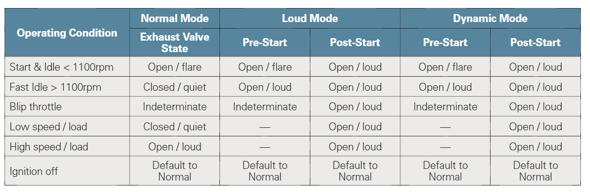

Attached are pics of my exhaust valves upon cold startup after engaging Dynamic Mode and shutting off the car. You can clearly see the first 2 pics of my driver's side exhaust valves are fully open, parallel to the exhaust pipe, but the remaining pics of my passenger side valve is only partially open, maybe 75%. Included is a chart of Jag's explanation of the operation of the exhaust valves.
Attached Thumbnails 2017 MY R Exhaust Valve Redesign?-ex1.jpg   2017 MY R Exhaust Valve Redesign?-ex2.jpg   2017 MY R Exhaust Valve Redesign?-ex3.jpg   2017 MY R Exhaust Valve Redesign?-ex4.jpg   2017 MY R Exhaust Valve Redesign?-ex5.jpg
2017 MY R Exhaust Valve Redesign?-ex6.jpg   2017 MY R Exhaust Valve Redesign?-exhaust-chart.png

Originally Posted by Ritzy
JNA is giving me the same lines for a similar issue. We should get everyone who's been affected by this and put our heads together. They can't ignore us all, but they will surely ignore one or two of us on our own.
Yeah, you and I have been recently going back and forth on the Thread you started.
I asked you to check your exhaust valves and see if they open completely...did you get around to it?

Originally Posted by ek993
Their response doesn't seem to make sense either.
They have stated it's the software that has changed the way the valves operate. So why would people who have their mufflers replaced experience the issue (like me) as I am still running the old software?
Surely it's only when the software is updated to the latest version that the issue will present itself - regardless of new or old muffler? Sounds like the muffler design is unchanged.
Or.. are they saying it's a combination of new software AND a new muffler design?

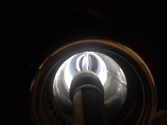

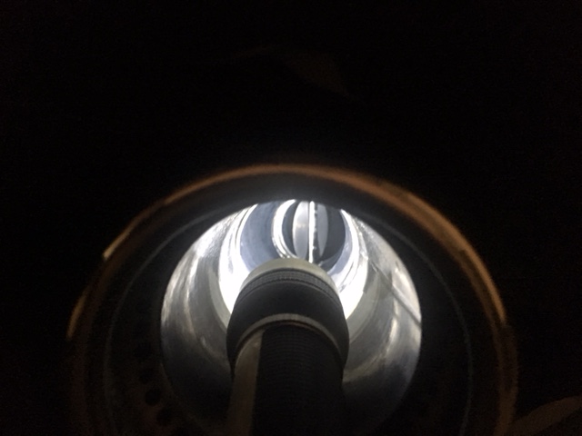

Would you mind looking into your exhaust and confirming that both your valves are fully open/identical to each other (parallel to the exhaust pipe) after turning off the car and having been in Dynamic Mode? Thanks
Absolutely - both are fully open.
Attached Thumbnails 2017 MY R Exhaust Valve Redesign?-drivers.jpg   2017 MY R Exhaust Valve Redesign?-passenger.jpg
That's what I figured! Both you and zmoothg have confirmed for me that after having your exhausts replaced, both valves open fully.
So I guess I'm being fed a load of fecal matter! Unless you guys never received this "software update" after having your exhausts replaced--but I doubt that

Kief, I'm in the same boat with my new R. The passenger side valves are not fully open.
I have my car going in to the dealer to get the updates to fix the audio crapiness. I'm calling them today to talk about this issue. It's scheduled to go in on the 29th.

Originally Posted by stahlee
Kief, I'm in the same boat with my new R. The right valves are not fully open.
So maybe there is some truth to this after all, as we both have 2017, and everyone else who has chimed in thus far has had 2016s or earlier???
