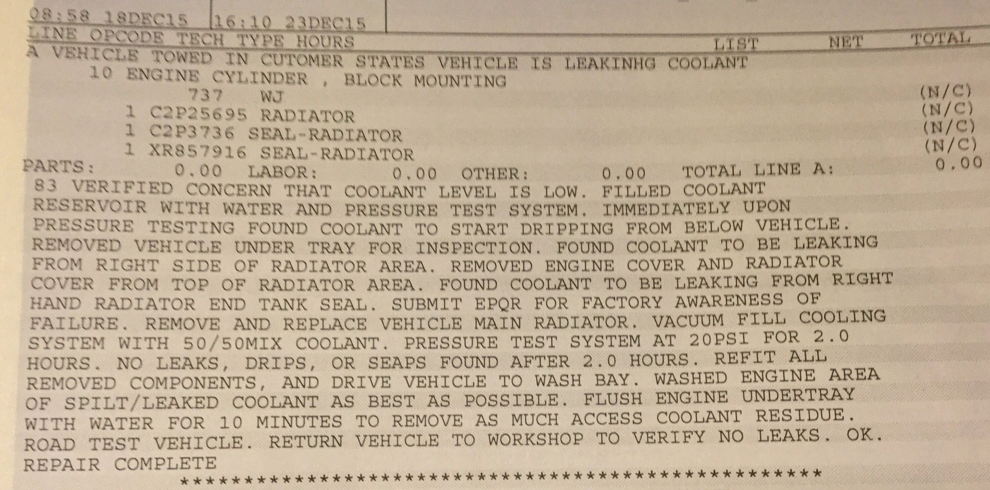

I picked the car up yesterday afternoon. The rep mentioned again how rare this was, she said as soon as the part was ordered, the factory requested the failed part shipped back.
Here are the service invoice details: (sorry for lo-fi iPad pic)
Old Dec 24, 2015 | 08:10 AM
Foosh's Avatar
Joined: Jul 2014
Posts: 6,176
Likes: 1,039
From: Maryland, USA
Thanks much for posting the work order. Rare indeed, but manufacturing defects do happen, or it could have been damaged during vehicle assembly. It could be as simple as someone dropping it on that ride-side corner when removing from the shipping container.

The thoroughness of the repair comments...2-hour pressure-test, wash and flush underside, road-test and recheck...some of that is expected; but, it's also nice to see they're trying to return your Jag to its pre-leak newness.
