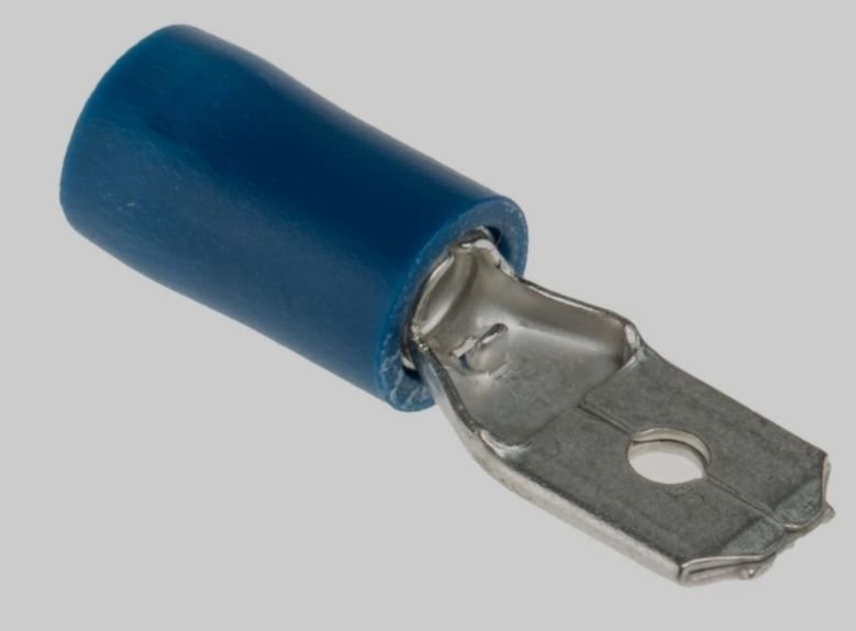

Quick question. I’ve got my fuse tap (emylo coming tomorrow), when I take the wires from the slot that doesn’t have a fuse now, what’s the best way of connecting them to the fuse tap? In Agua’s pics it looks like a proper plug. I can seem to find such a thing.
thanks,
Mark

I used a Male Spade Connector, the one I used looked like this and was one I had already so was slightly too big but it was easy enough to trim it down to size.
Old Jan 18, 2025 | 04:00 AM
  #94
markjord's Avatar
Joined: Jun 2017
Posts: 44
Likes: 5
From: Market Harborough
Thanks very much. I’ll try that.
