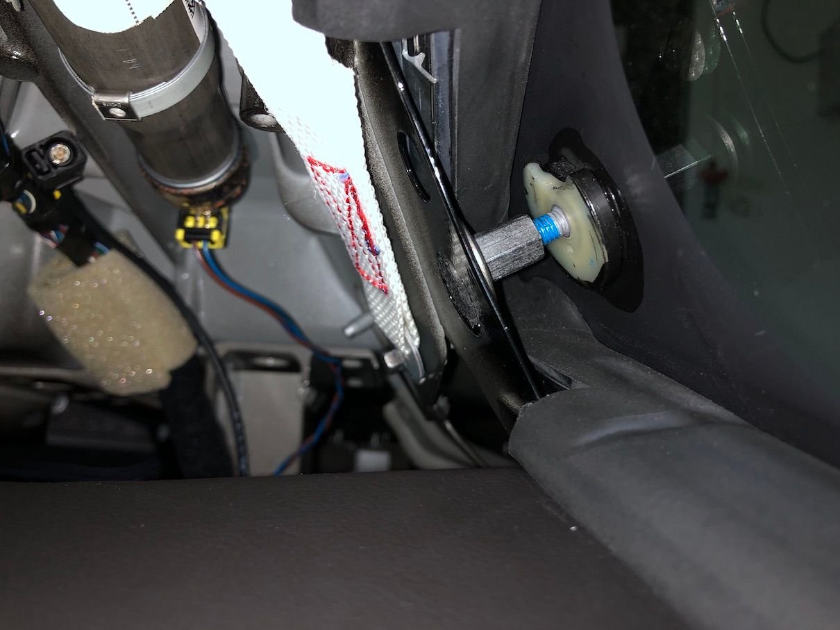

By dismantling the plastic covers, I see no connector on the rear window or screen printing to make antenna!
Do I need to replace the glass?
I just see a bolt that is used to secure the glass.
If someone has already carried out this operation, or has dismantled this part, I am taking information.

I found my answer, the quarter glass is specific, that's why I couldn't find the antenna connector.
T2R8983 / T2R8985 w / o antenna = 237 $
T2R12717 / T2R12719 w / antenna = $ 500
Considering the price, I’ll search for a second hand, or I’ll put another antenna.
