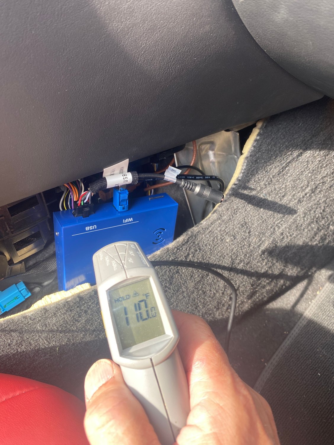

The unit has to be installed alongside the passenger transmission tunnel. It’s installed and all working but I think the heat output is concerning.
when laid out in ‘open air’ box temperature climbs to 100F and when tucked in ( trim panel still off) I measure it at 110F and very warm to the touch. It’s coming from the microprocessor. It’s only gonna be worse when I replace that trim and I don’t think that’s acceptable.
Have any others experienced this with similar units? Thoughts?

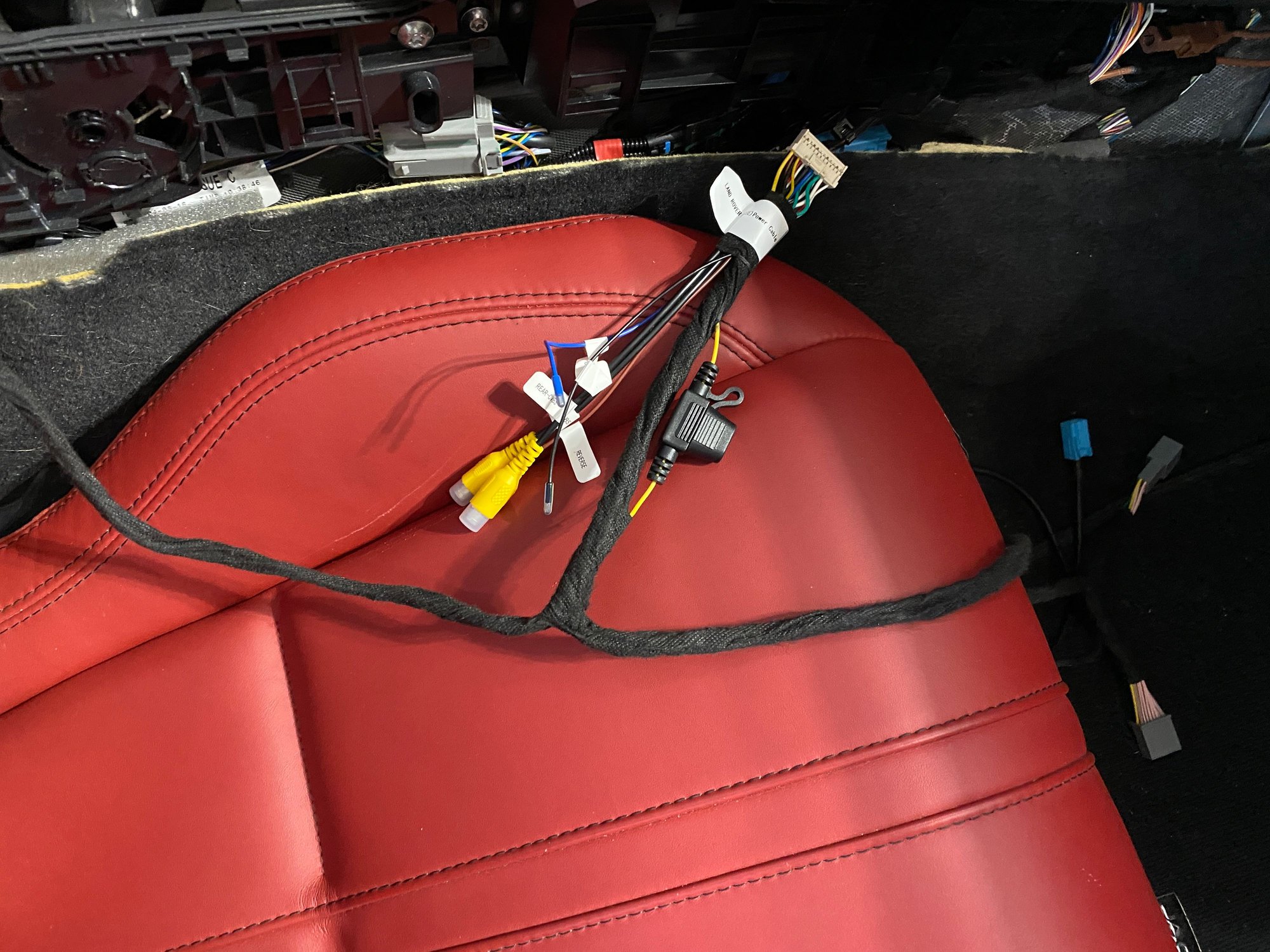

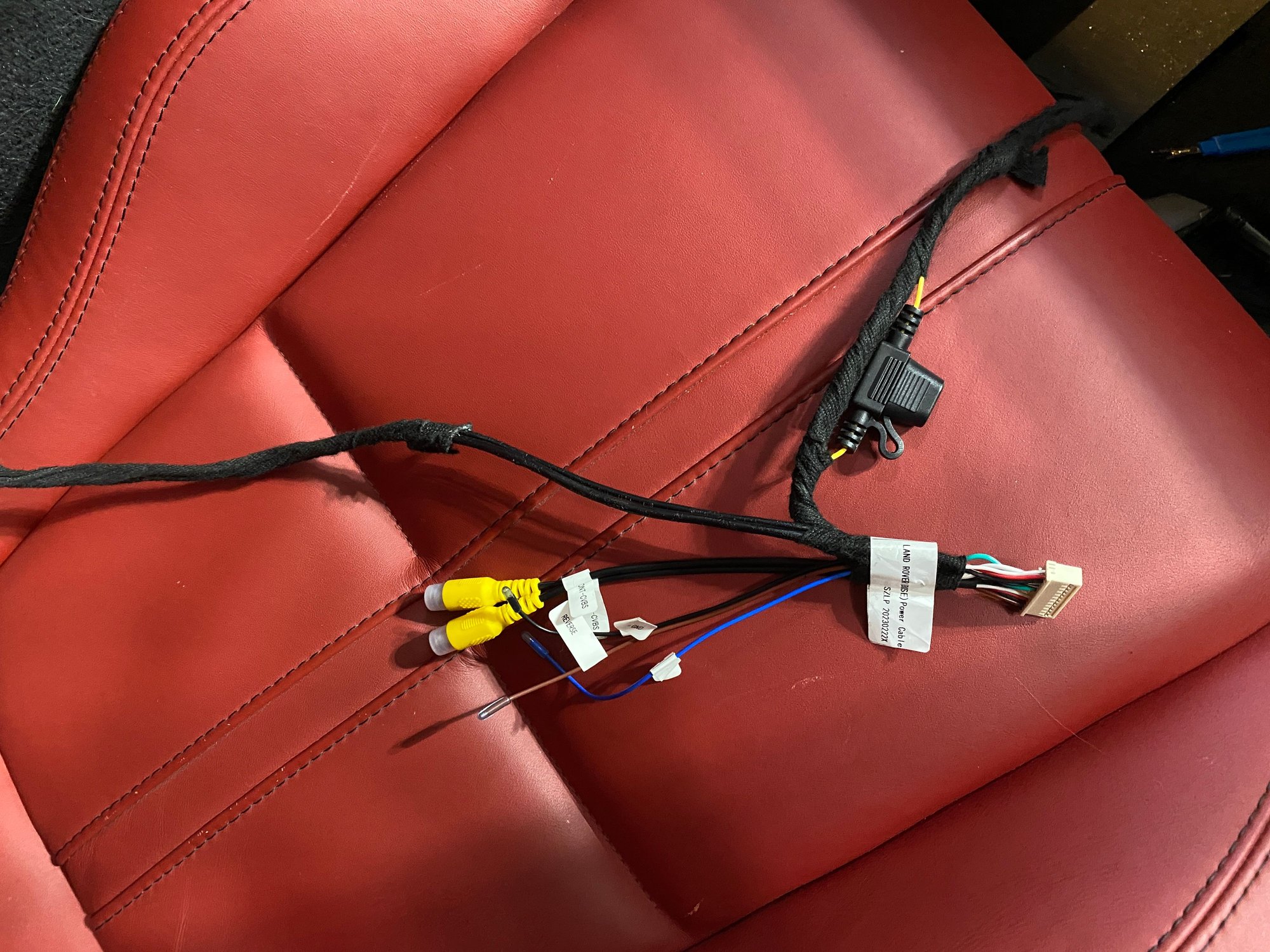

FYI the as supplied wiring loom wrap has to be unraveled at the ‘Y’ connector into the unit in order to gain another 6 inches needed for the F-Type application. See Photos
Revised ( unwrapped at Y then rewrapped) loom to gain extra length needed
